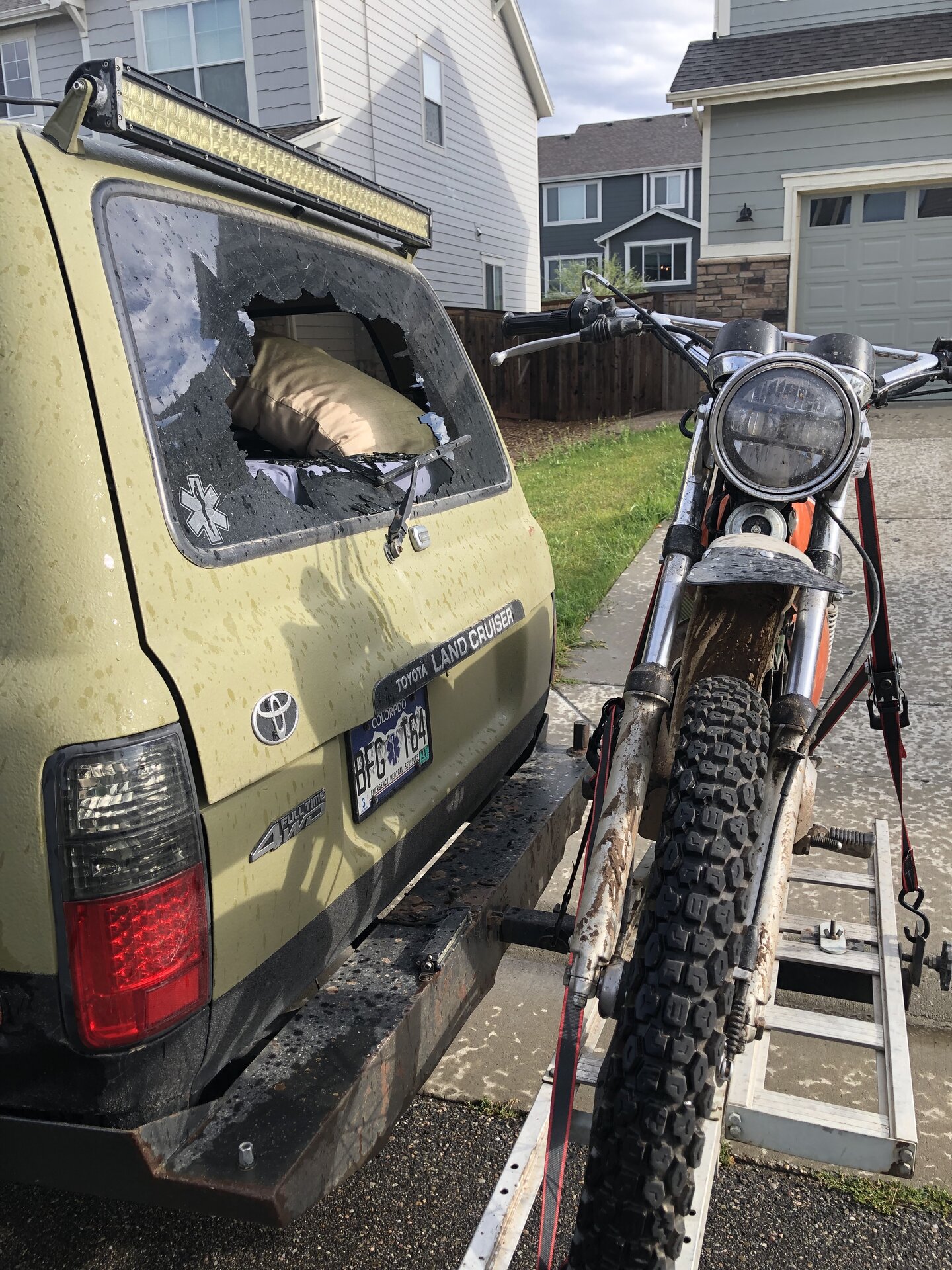

So my dirt bike decided to smash my back window last weekend... Fortunatly I had bought a replacement hatch years ago from a buddy who was stripping an 80, my hatch had some bad dents in it from the PO so my intent was to always change it out. Although I had planned on waiting until winter so I could put the rig out of service for a while to perform the complete repaint & trim... Guess that's happening sooner now..
As I said, this is forcing my hand to get going on the repaint & trim replacement, so I took a shot of whiskey and pulled the trigger on my cart full of belt moldings, rear slider window seals + runs as well as various clips and things.

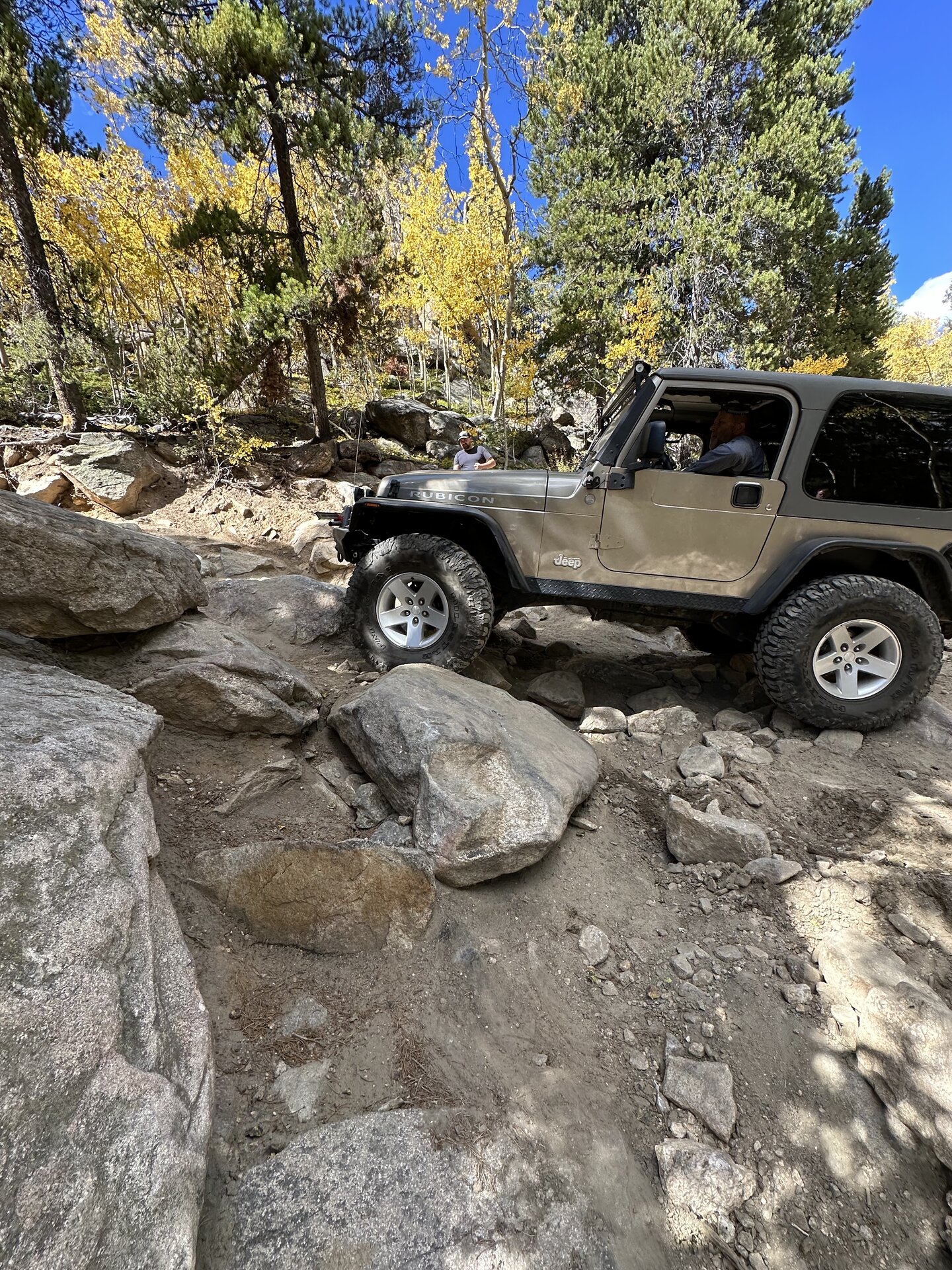

Well a friend of mine wanted to do a harder trail so I took him on Spring Creek
which was a lot of fun, the trail has about a 250-300 yard long boulder field that has lines for 33" tires all the way to 40" tires. Well I went full ham on the 37-40" tire lines with my rig on 35's 😬

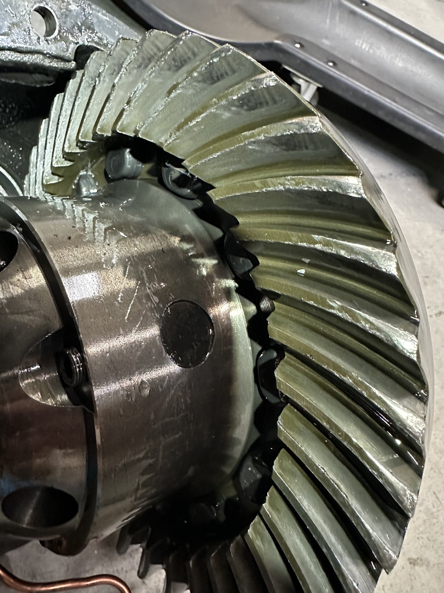

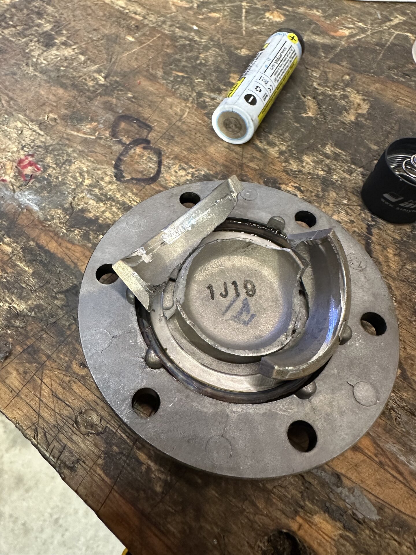

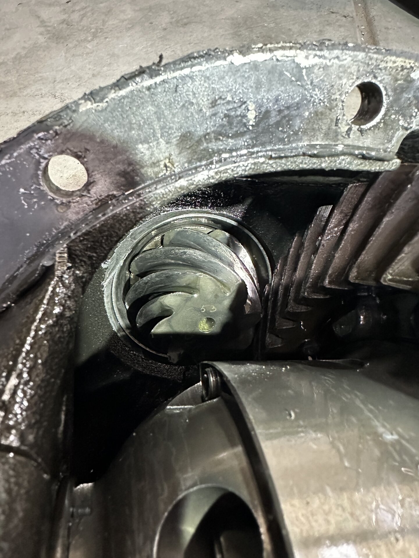

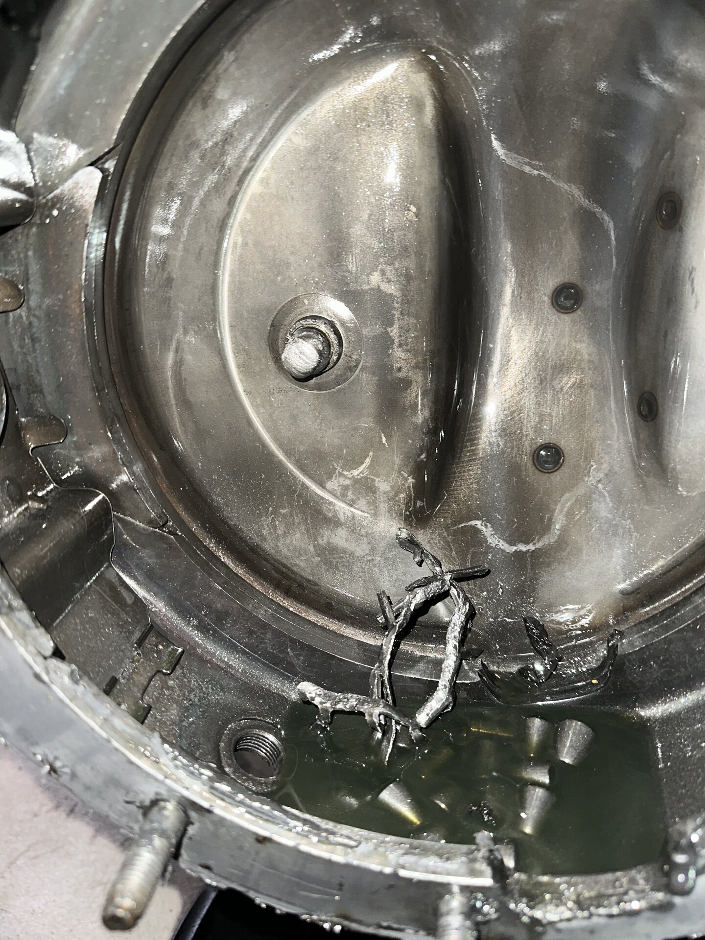

Annnnnd this is what happens when you full send a rig on 35's down the extreme line:
  • Broken Aisin hub
  • Exploded Birfield
  • Grenaded rear differential
  • Bent lower control arm
  • smashed front camera
Spring Creek is the only trail in Colorado that I’ve done multiple times and each time broke something.
Diffs out and in its cradle.

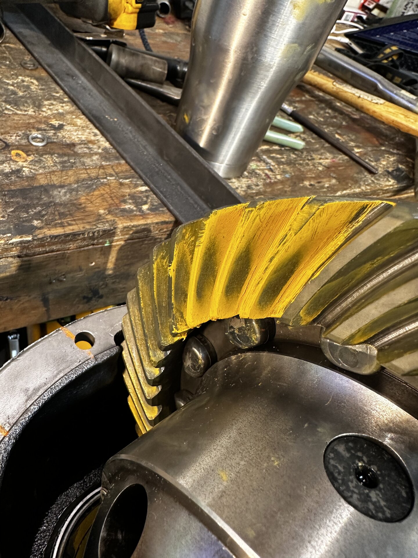

Setting my pinion depth on my replacement 4.88's
1st try, pinion inner race spaced out 1.28mm, looks a little deep.
2nd try, Inner pinion race shim reduced to 1.18, looks pretty spot on.
Happy with the depth now it's time to set the solid spacer shim pack. I'll start with the full shim pack, fully assemble it then measure the movement and take out that much plus an additional 10 thou from the shim pack and recheck. Pretty done with working on it so that'll probably be a tomorrow job.
Solid spacer started with the full shim stack, 1.82mm, that was just barely too much so I pulled out 5 thou and it was still too much so I backed it down to 1.70mm and that seems to be the ticket. Torqued the nut to 180ft-lb, and got the backlash set to about .006" a bit tight but it was the best I could get. Total preload is a touch heavy at 25-30in-lbs (top spec in the book is ~23) but that should break in just fine. The pattern is totally acceptable.
I've had enough fun doing this so I think that's good enough to get sent back into service.

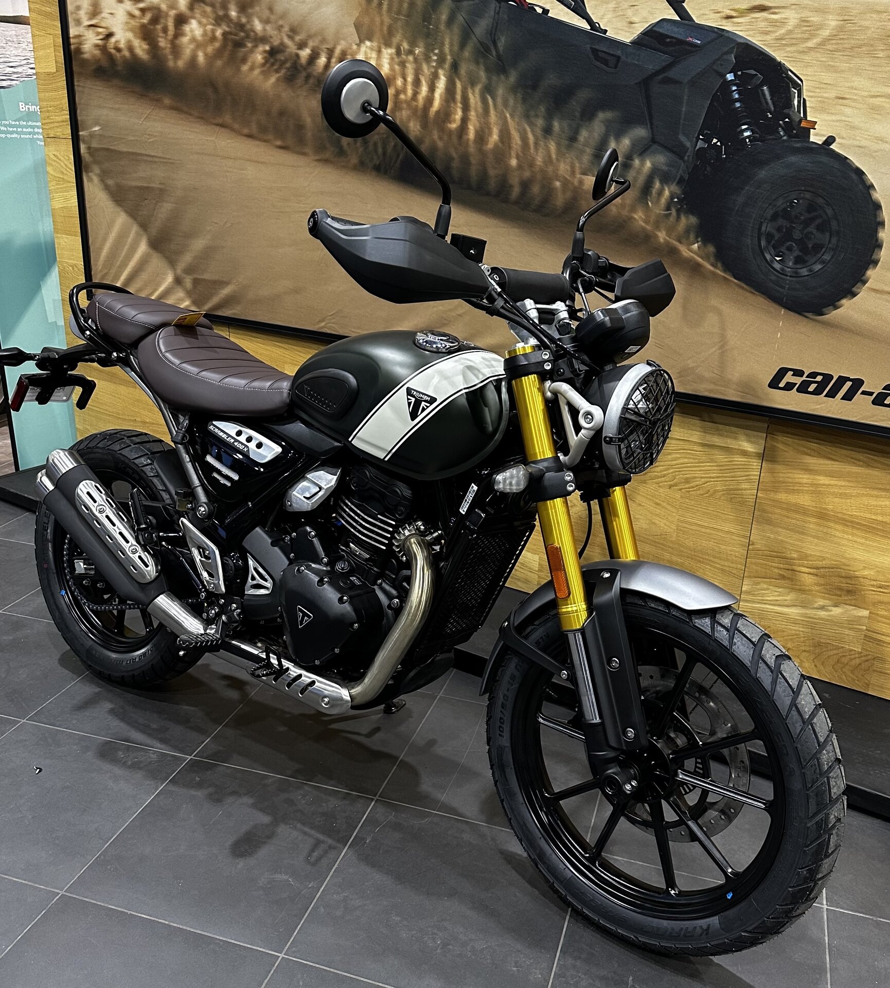

And I bought and picked up the first Triumph Scrambler 400x in colorado
Life update:
I broke my thumb on the ride out of the dealership with the bike which was sweet. Bike sat at Triumph for about 10 months waiting for a new gauge cluster (which is also the ECU). Got it back and have been upgrading it to prepare for a mini BDR outside of Scottsdale in April.

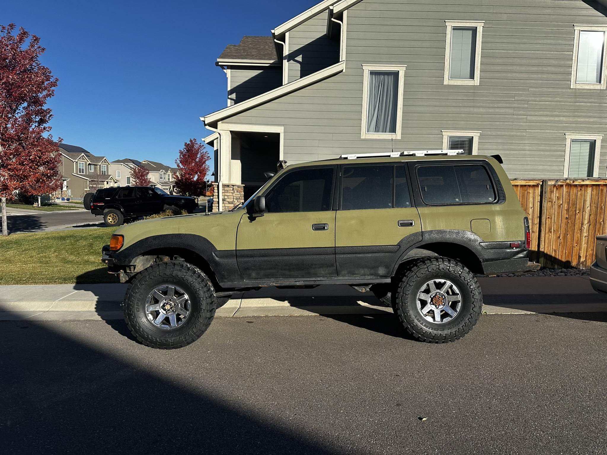

Oh yea and the old trail snail graduated to 37's
