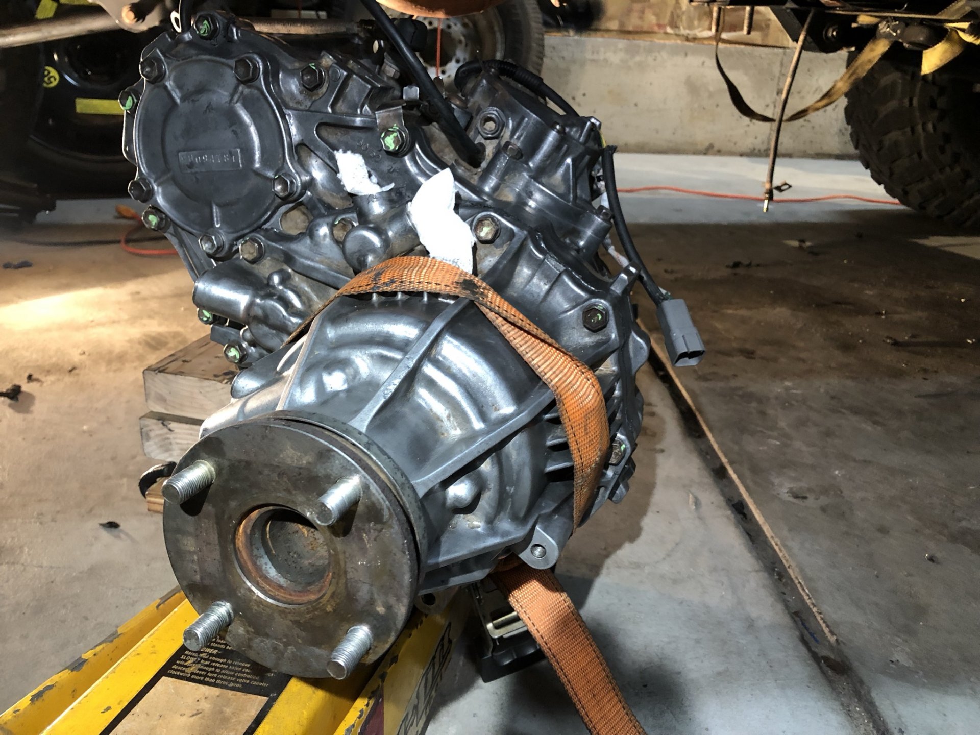

o meh gerd... Finally got the T-case done, only had to open it up like 6 times to put things back in that I kept forgetting, unimportant things like the oil pump drive rotor. Can't wait to see how the ol snail drives with new shocks & T-case output bearings. If it's not an improvement I'll go nuts.

Holly balls batman! I can't believe how smooth the rig is now, I had no idea how toasted those transfer case output bearings actually were. Last night I got the snail up to 70mphand the t-case shifter wasn't shaking, there were no vibrations on lift-off. It was sublime.

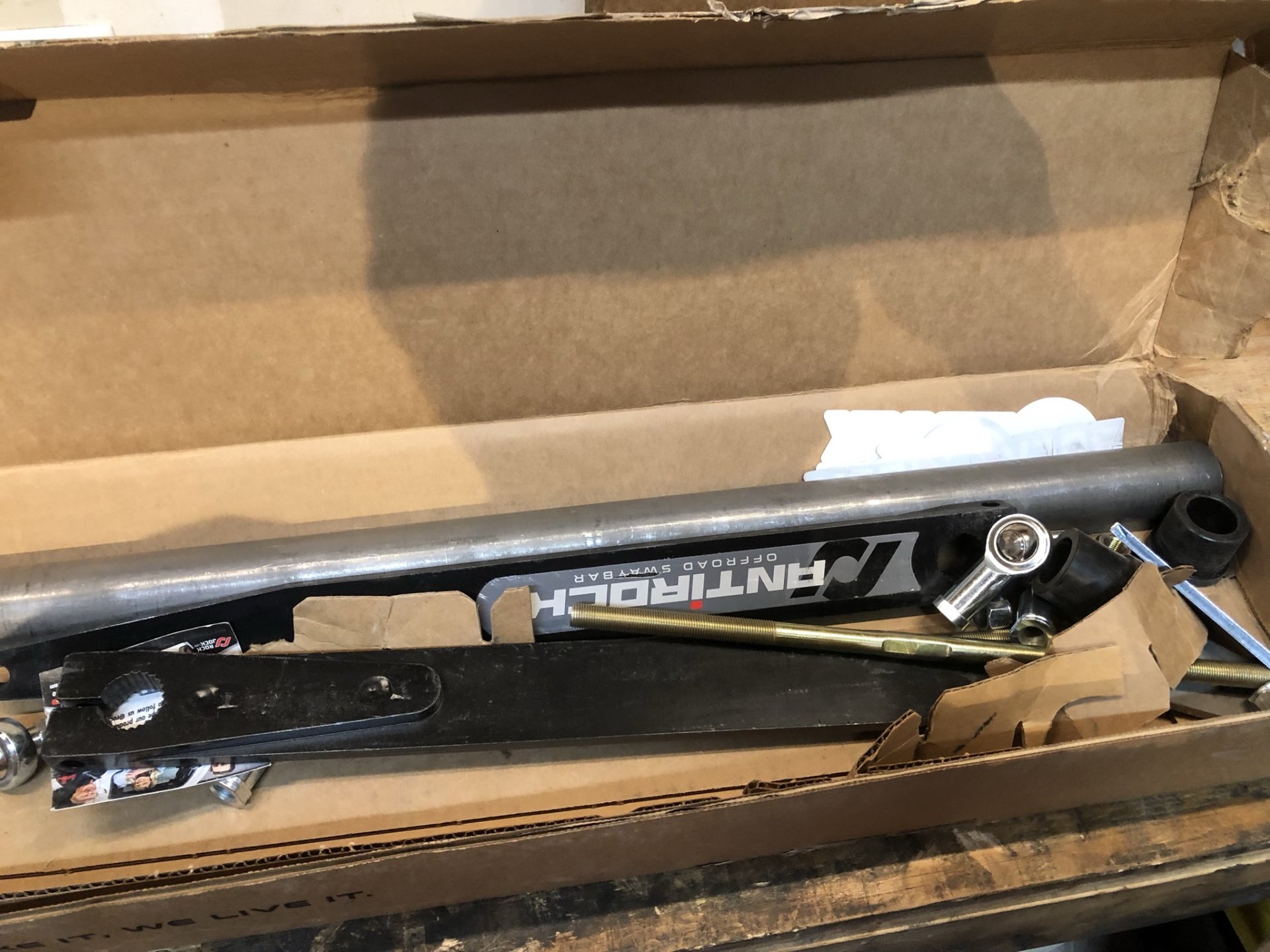

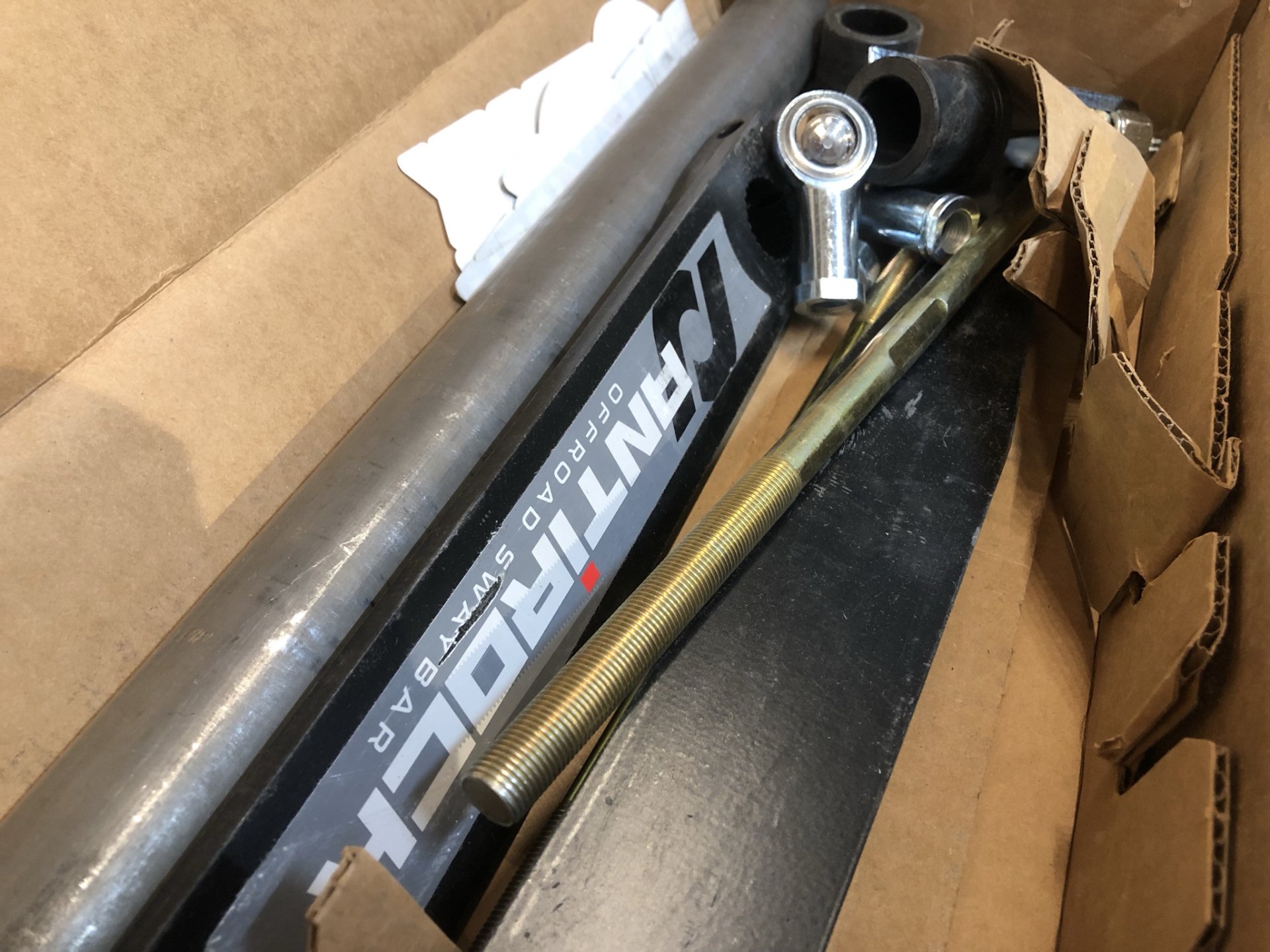

Got my Anti-rock sway bar. A lot was left to desire in terms of how they packaged this all for shipping. Literally was just thrown in a box which ended up making everything look like it had already been installed on a rig in a previous life. Can't fault Anti-Rock as I bought this through a supply house company CJ Pony Parts, which after a quick google search has like a 1.5 star rating on yelp.... oh well lesson learned. I'd be more upset if I was building a show rig but I just need it to perform, this rig has always been functionality first, looks second.
Those link bolts are way too long. They sell a shorter version. I found that 8.5” works. Should afford you a 5/8” thread engagement in the rod ends. $20 each.
They are the actual part. Bought mine from Northridge off-road here in WA. Actual part meaning actual AntiRock part.
8.5” affords about 5/8” thread engagement into the rod ends which is adequate based on the 1/2” dia of the bolt.
Nice, looks like a cleaner option than sleeving the rod. I bet McCaster Carr has this thread pitch and grade all thread in any length too.
If you want to search it out. For $20 it’s a simple pause and buy. Remember that one end is left hand.
Yea no doubt, definitely interested in the plug-and-play option for a crisp Andrew Jackson. Thanks for the advice.
Andrew Jackson
Every install has been a little different, baldilocks mounted his tabs much further down on the axle then most.
I would get everything mounted up then figure out what length threaded rod is going to work for you.
I had some tubing laying around that fit the rod perfectly so I went that route and saved a few bucks ;)
I thought it looked pretty clean 🤷‍♂️
