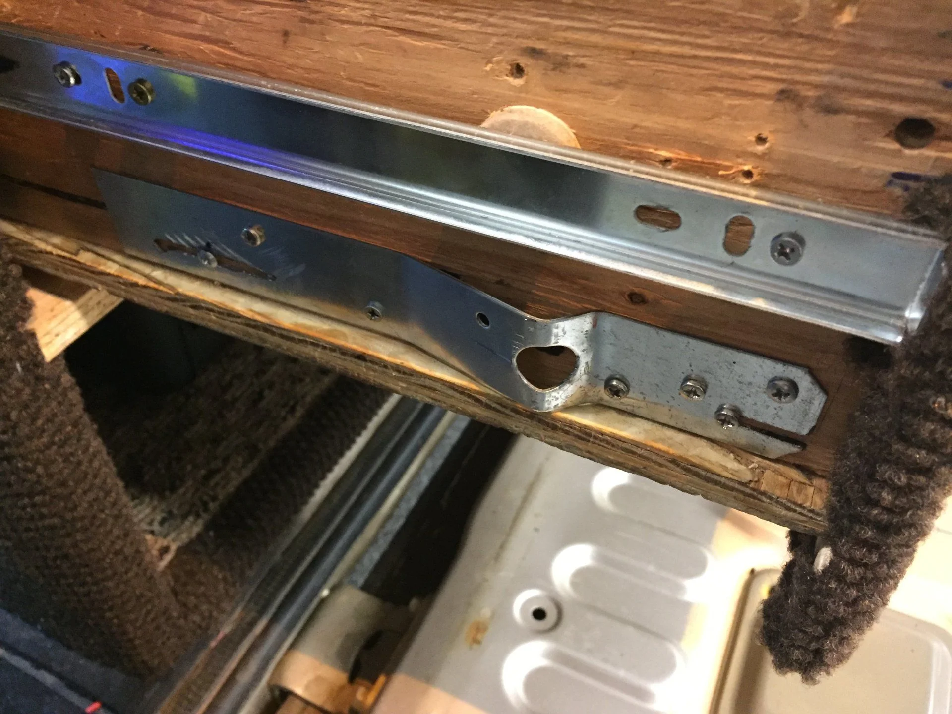

So I've replaced the old roller slides with ball bearing slides on the tool drawer last week and it only took till this weekend when I had my rig parked on a slope to realize how much it needs slide lock.
So tonight I made a DIY slide lock with a simple little pull pin and a metal strap. I also carpeted the other drawers face.

same thing I did when i ordered super duty 500lb slides I didt even think of slide locks. it works
