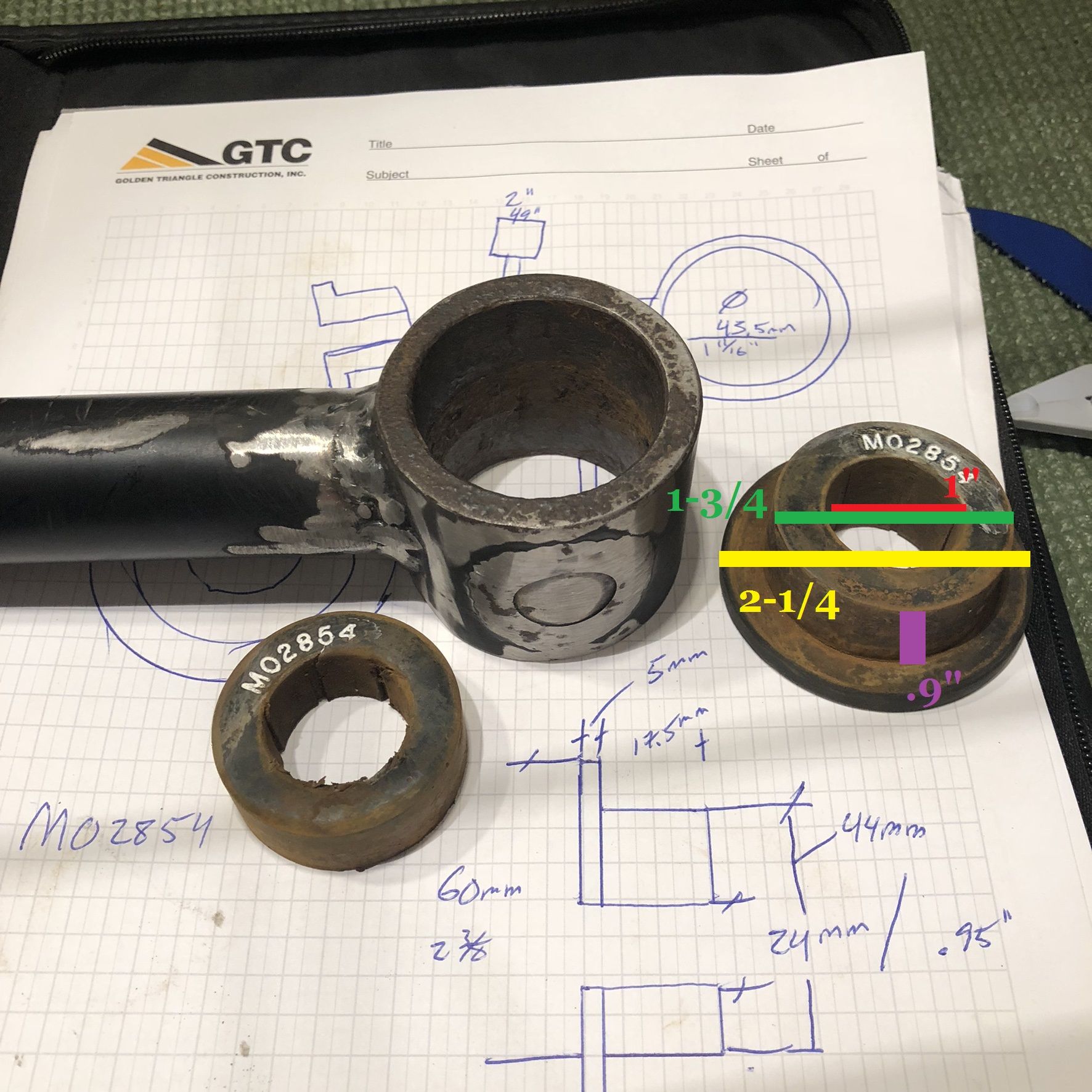

If the heims are 1” the pitch will be 14tpi. Tomorrow I pick up my metal tech rear control arms up from the machine shop. I too wanted to ditch the poly bushings that are at the one end of each arm. I had the shop cut the MT bushing eye off and machine a new bushing eye out if solid round stock for a .002” press fit and having a .250” wall. This shop also provides welding services so when I pick them up they will be ready to install save for paint. Total cost for all 4 Toyota bushings purchased online and shop services is $371. The poly bushings from MT are sloppy the day they are new and the movement this allows causes them to where out quickly.

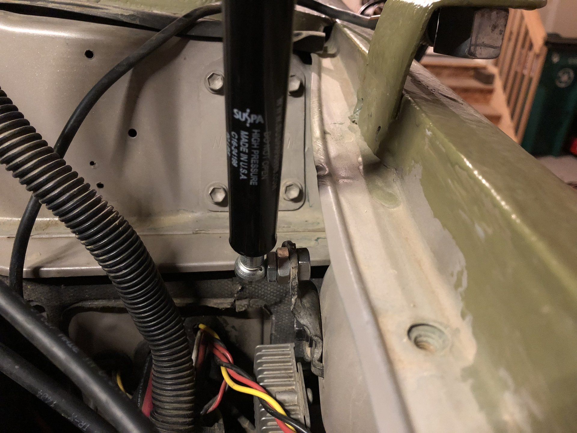

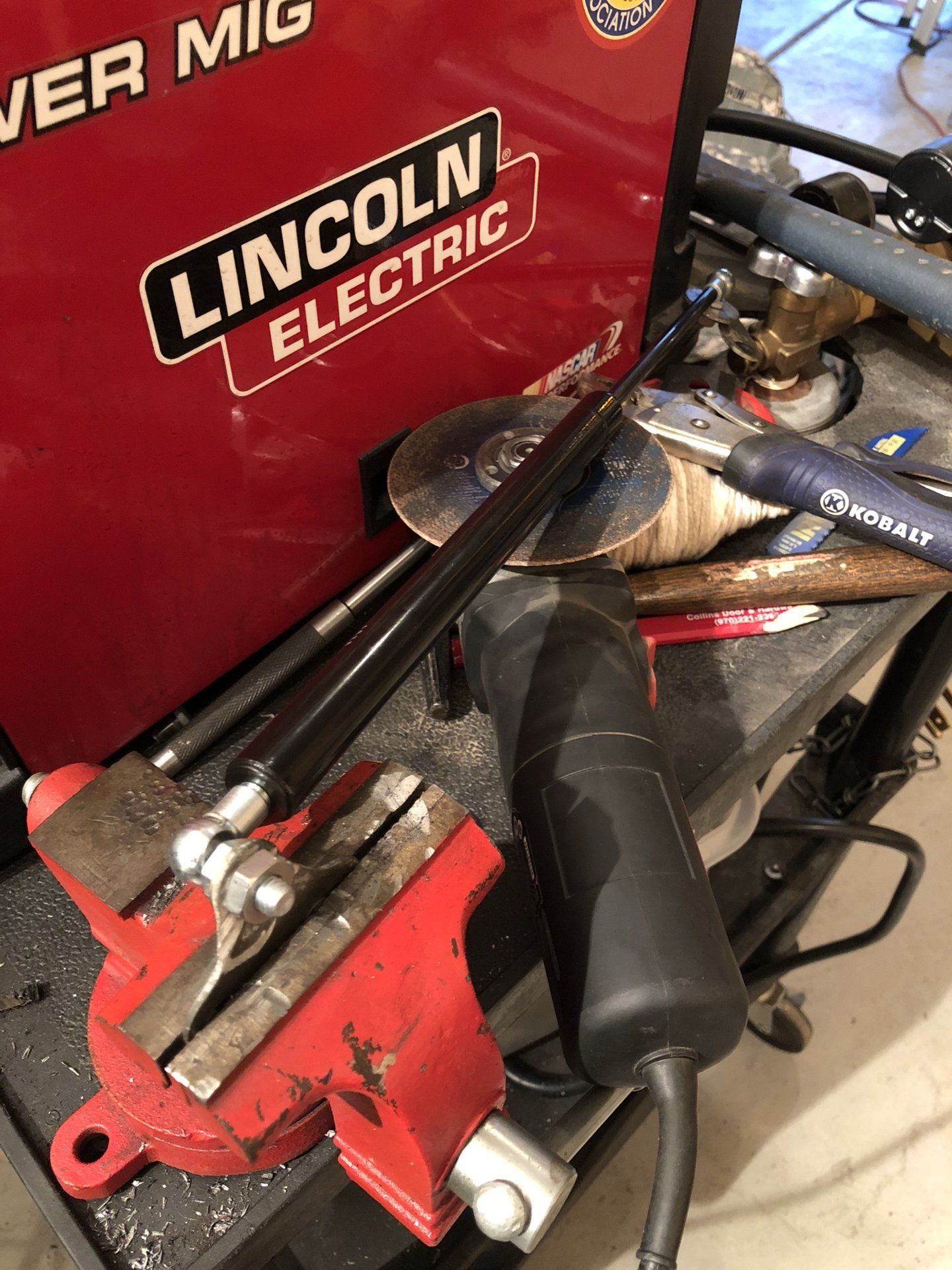

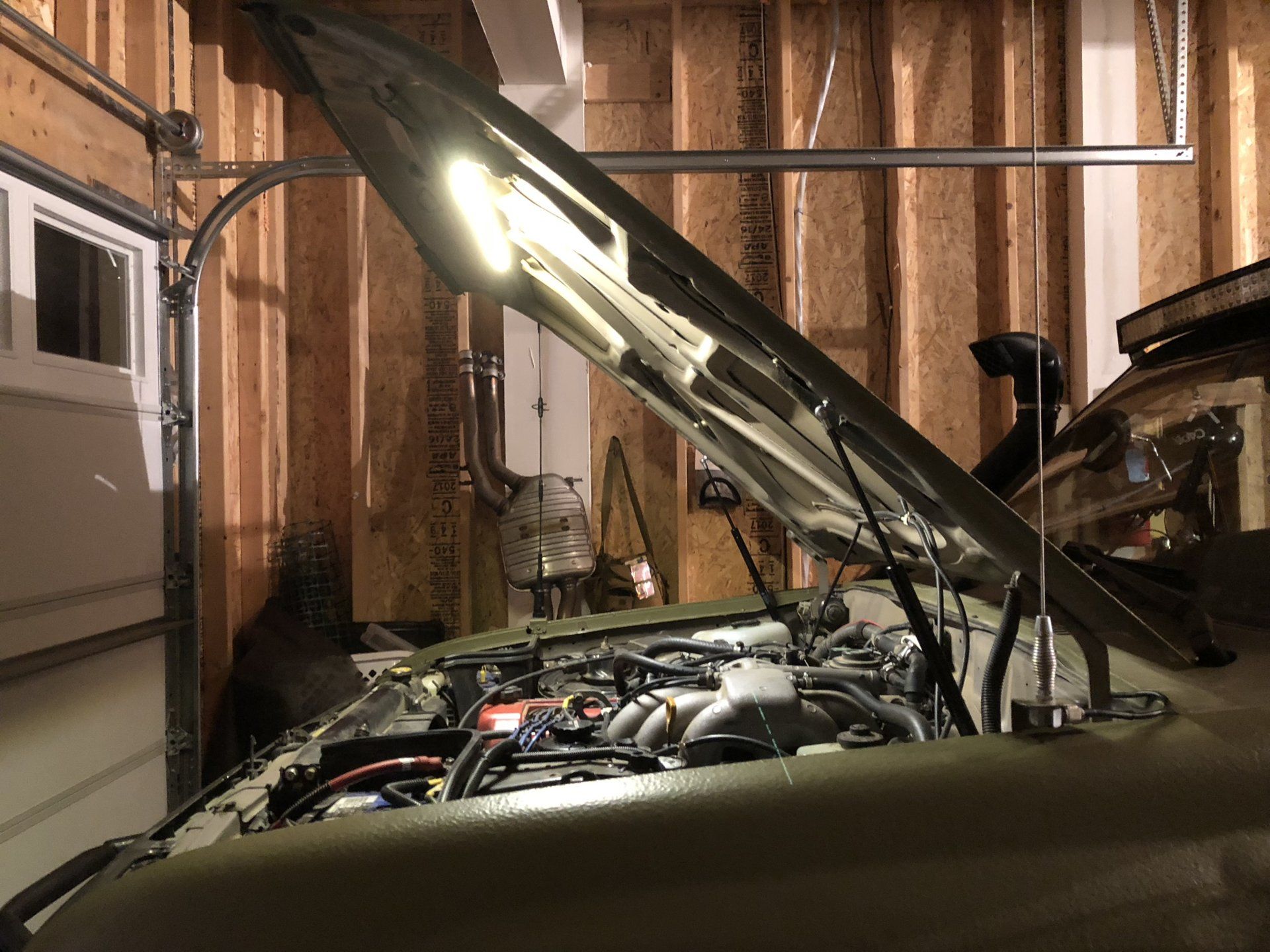

Replaced the hood and hatch struts tonight with McCaster Carr gas struts... They were longer than the stock ones by more than I imagined they'd be, rear hatch has to be 3" higher now.

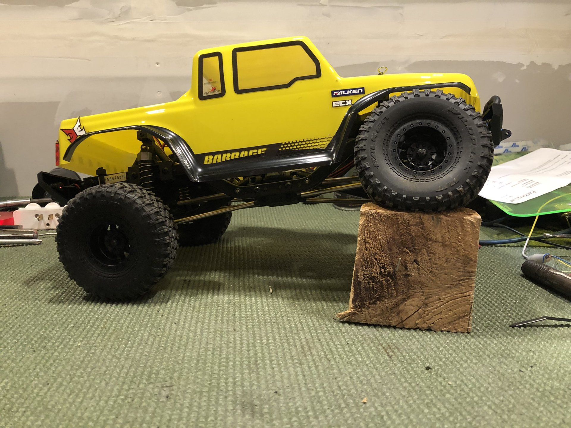

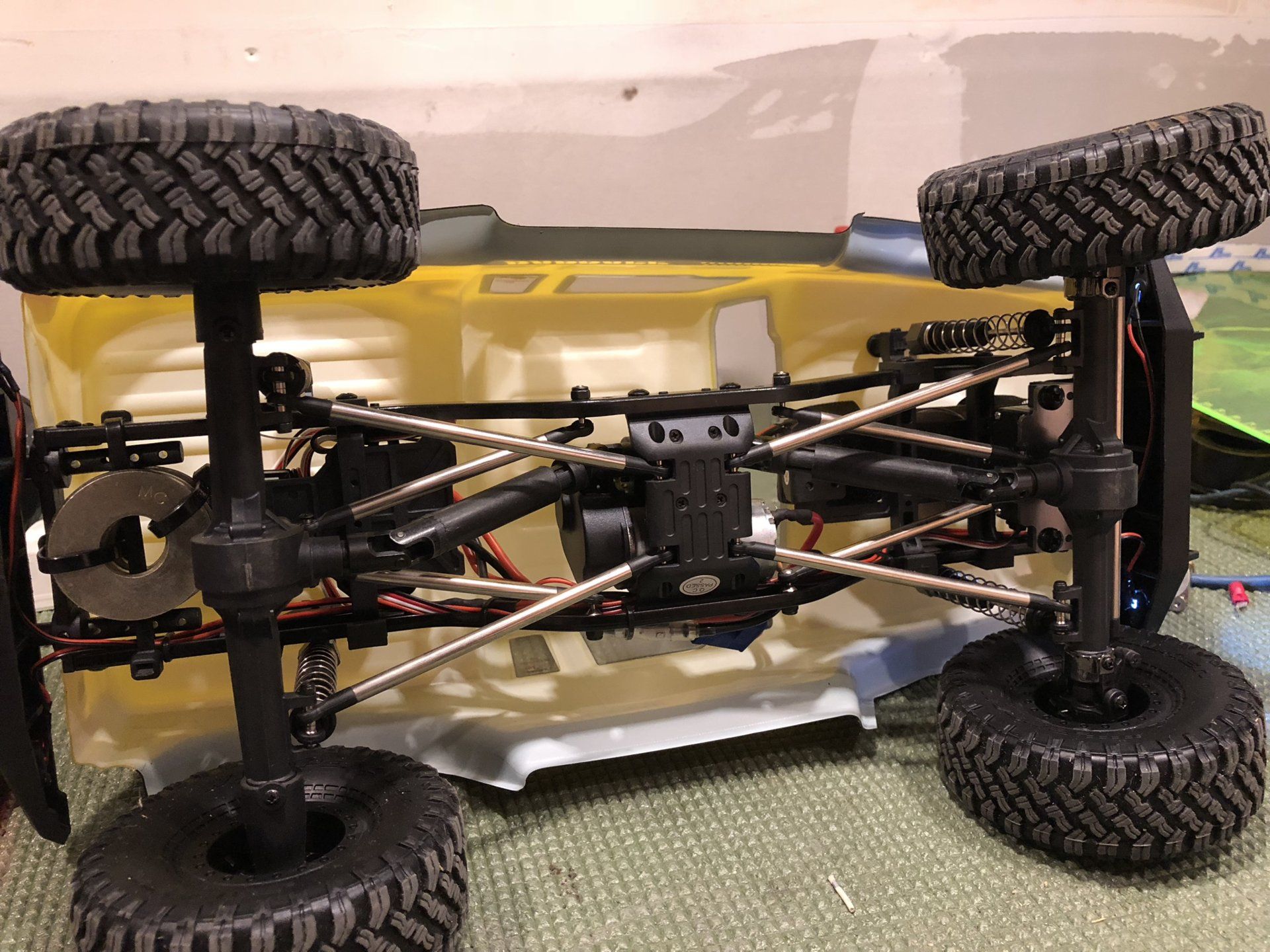

Also picked up a little RC crawler so I can wheel when I'm at camp. My friend has one and we had a ton of fun at my wedding... So I bought one haha

Hopefully this help you and anyone else with man a fre UCA's.

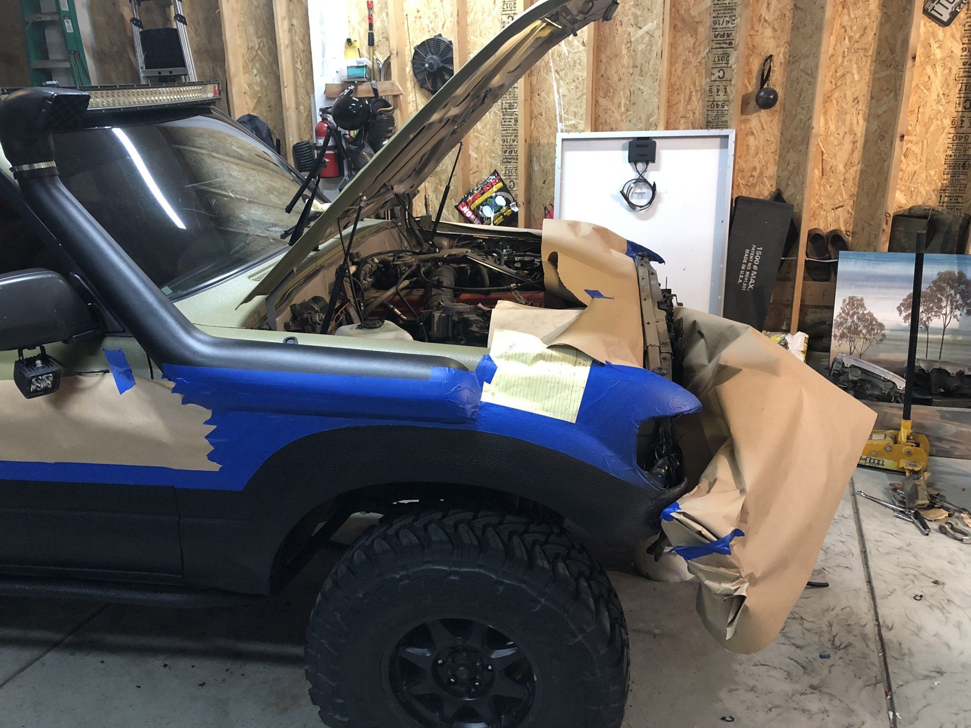

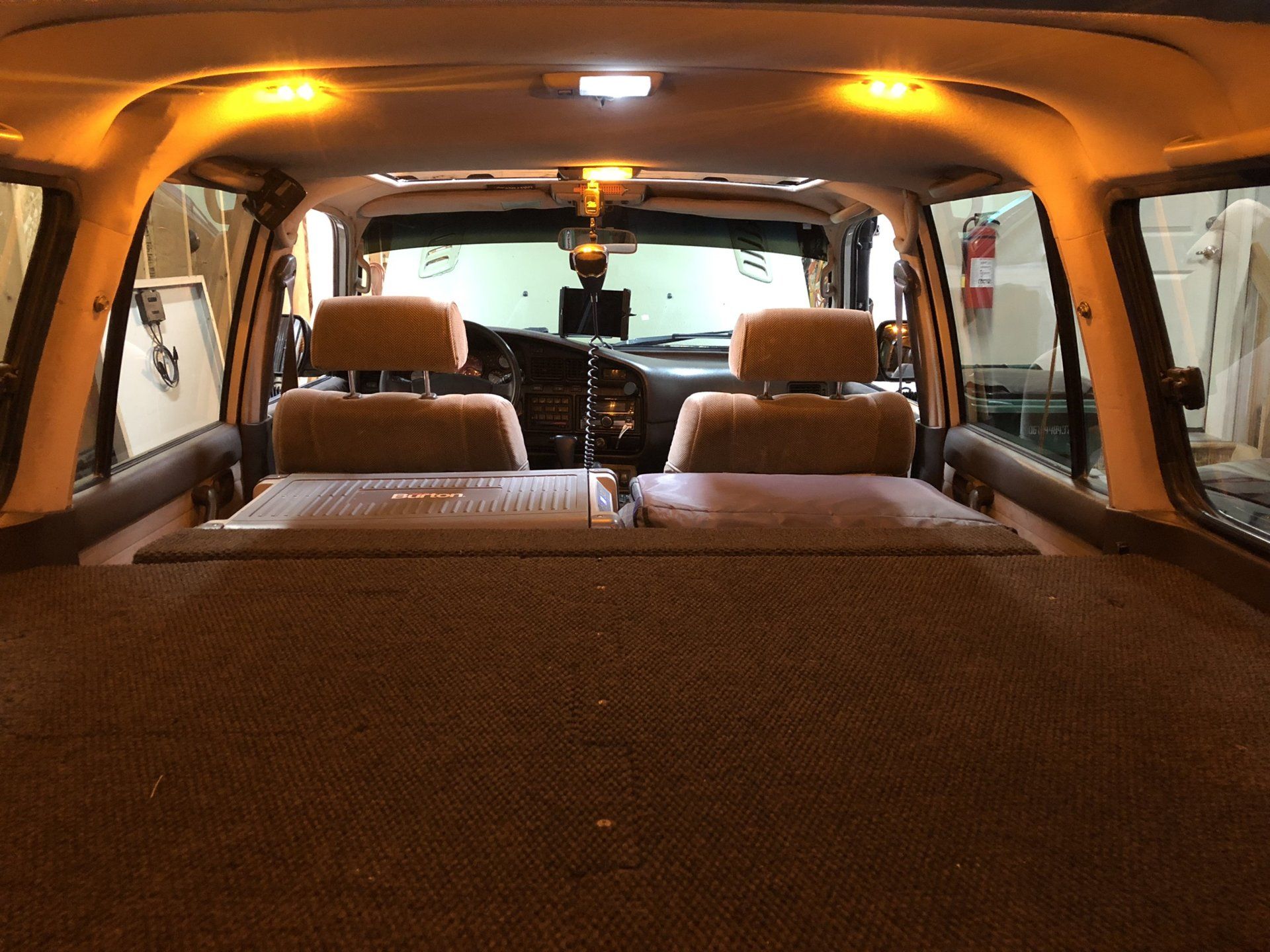

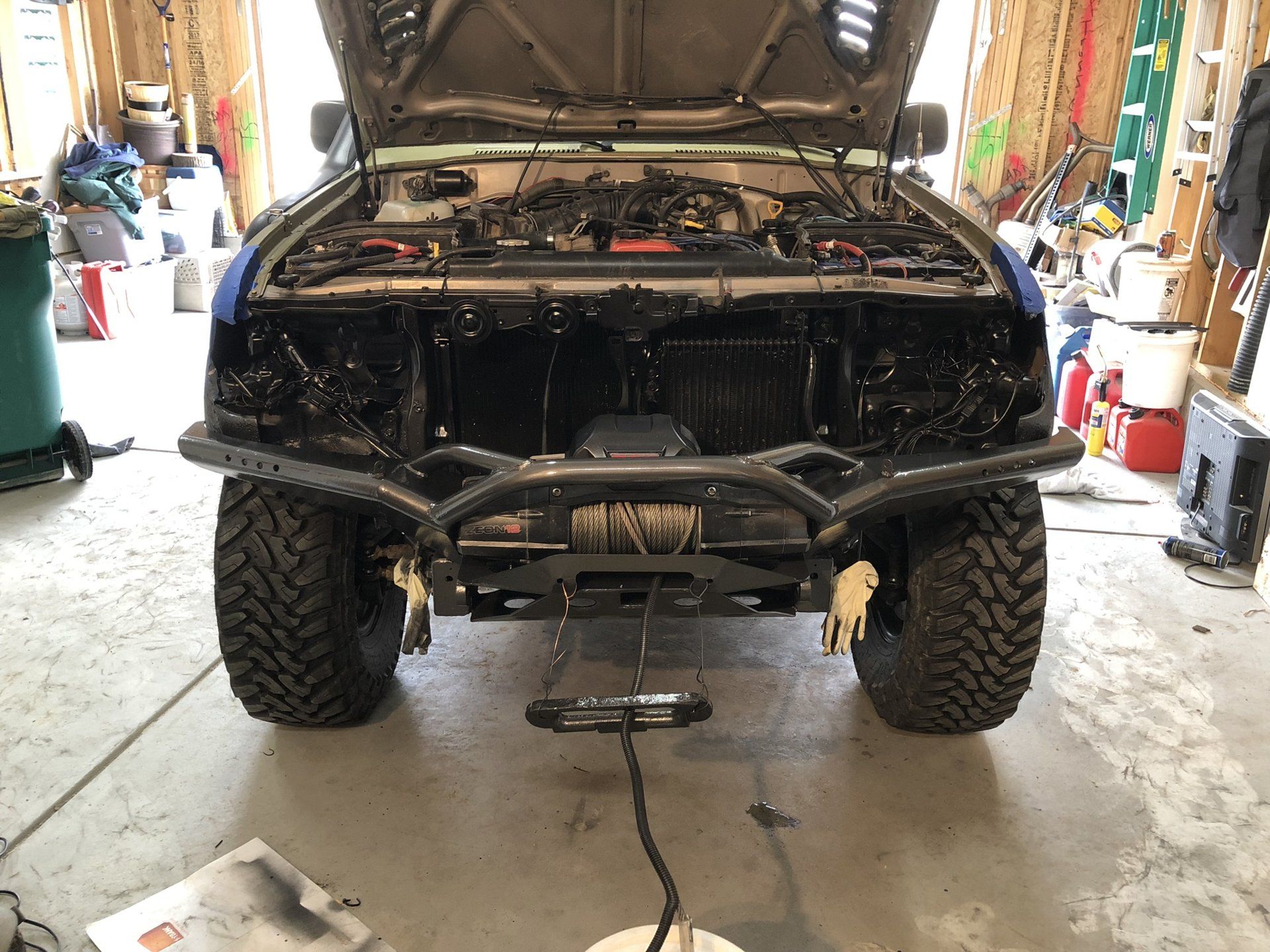

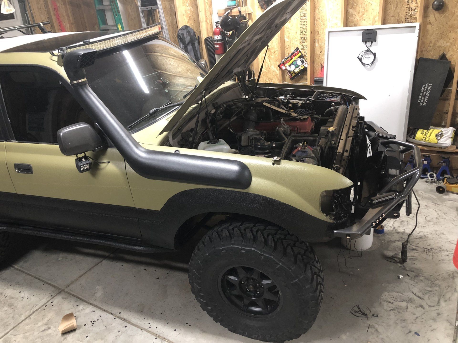

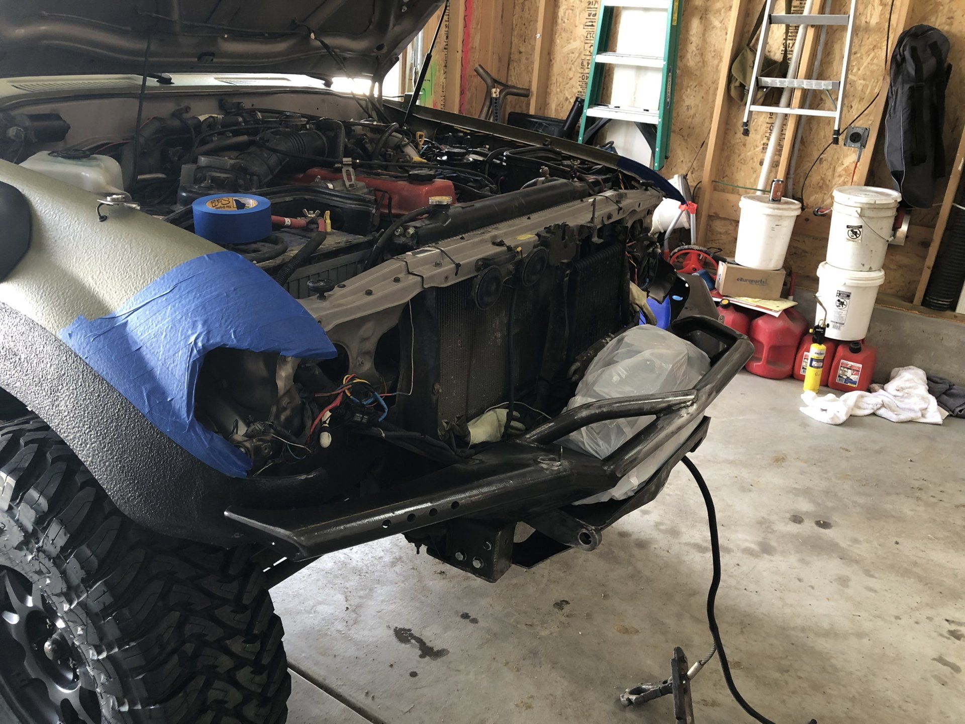

So this weekend was the annual Trail Snail Spring makeover. This entails repainting the front and rear bumper along with the bedliner on the body. I also took this opportunity to replace busted LED's on the front bumper (these are my turn signals), front grill upper dash section (mine was cracked) and I replaced the horn disk. Here are the picts
