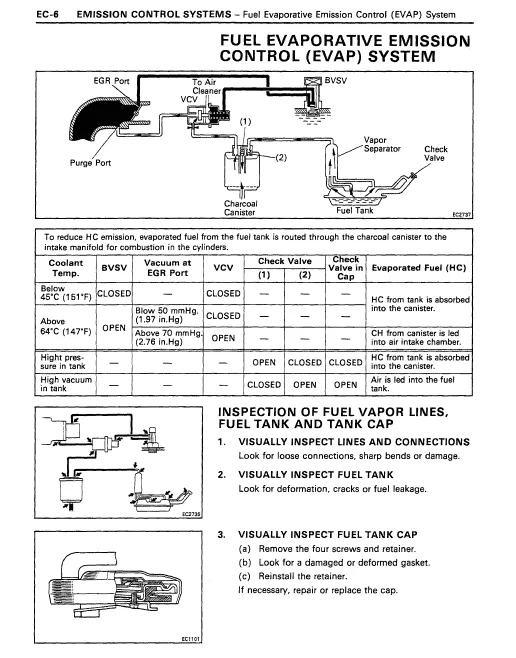

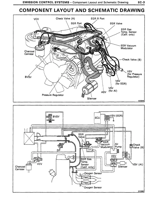

This is for a FJ62 but maybe it will help figure the spaghetti out.
I believe that the fuel pressure regulator and the temp sensor
I think the temp sensor is a plug in on the thermostat.
Which thingy is the fuel regulator?
The one labeled pressure regulator.
Ah yes. Little round valve on it. Any idea if the black side of that valve goes to the top or the bottom? I am not sure I have it right.
I have the top port on the black valve going to the bottom metal tube, and the bottom port on the black valve going to the top metal tube. But here is the schematic for proper routing... which I think I have right.
