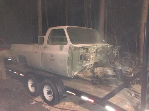

Martin and I are going to go and pick this truck up on Sunday, at least that's the plan now :D
Is there anything anyone would want off of this thing? Axles are spoken for, but everything else is up for grabs.
It is a military cucv. Does it have a 6.2 in it? What's wrong with it?

Doesn't start, but it does crank. Transfer case blew up. It's got the axles I need though!
all of them were 24V 6.2s or 6.5s if they got a replacement.
4.56 gears/detroits
D60 front/ 14B rear
bought one a few years ago for parts but ended up just fixing it and selling
trans should be a TH400
these were the best for out of the box wheeling. The blazers didn't have lockers and were normally a 10B front and D44 rear.
the air force got the crew cab versions.
D60 front, 14b rear, 4.56 gears, rear detroit, 6.2 diesel, th400, np205 or np231 IIRC. Turns over, doesn't start.
check the fuel pump..... Its about a $25 part and seems to be a common reason these military ones wont start

Let me get it and assess it before I give you a price.

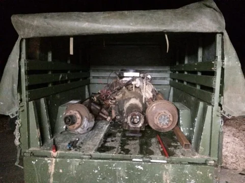

It's probably an NP208 t-case. Nice score!

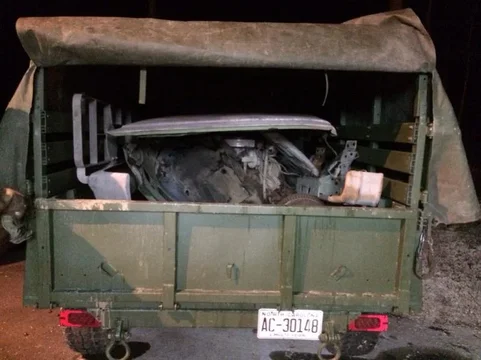

Thats is split in half! We're dragging it home anyway.
About a mile from the guys house, the hood flipped up :lol:
