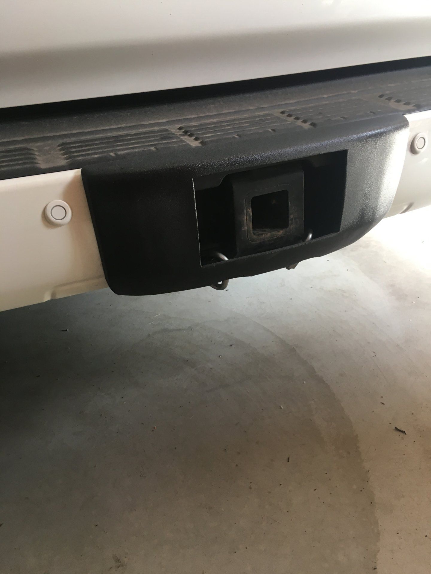

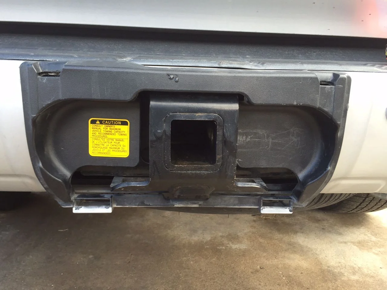

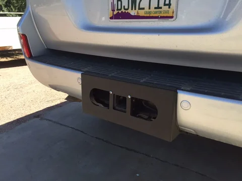

If you have a 200 and you use it for towing with any regularity, the cover over the hitch will make your head want to explode!
on, off, on , off...
Scratched to hell in the back of the truck...
Even worse, My bike rack uses a threaded hitch pin for stability and the ratchet won't fit in with all of the plastic crap. It's like Toyota doesn't want the hitch to be used (Don't get me started on the offset hitch pin plug that nothing reaches)

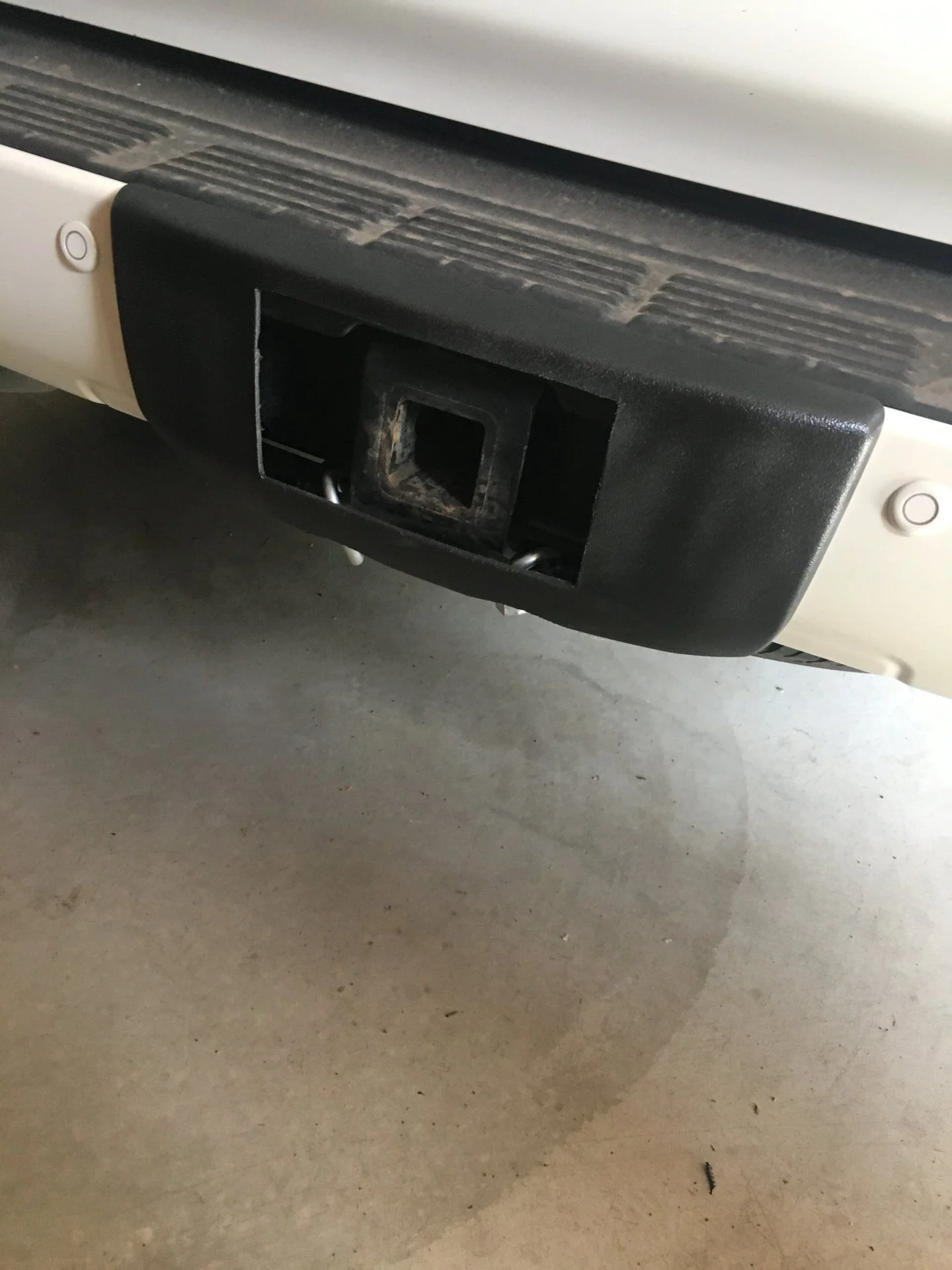

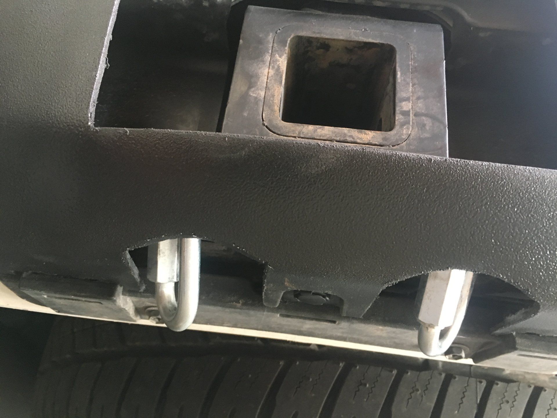

So I got Mike at Bump-it to fab up this :cheers:
Replaces the plastic crap, looks decent and stays on all the time and I can fit my ratchet in.

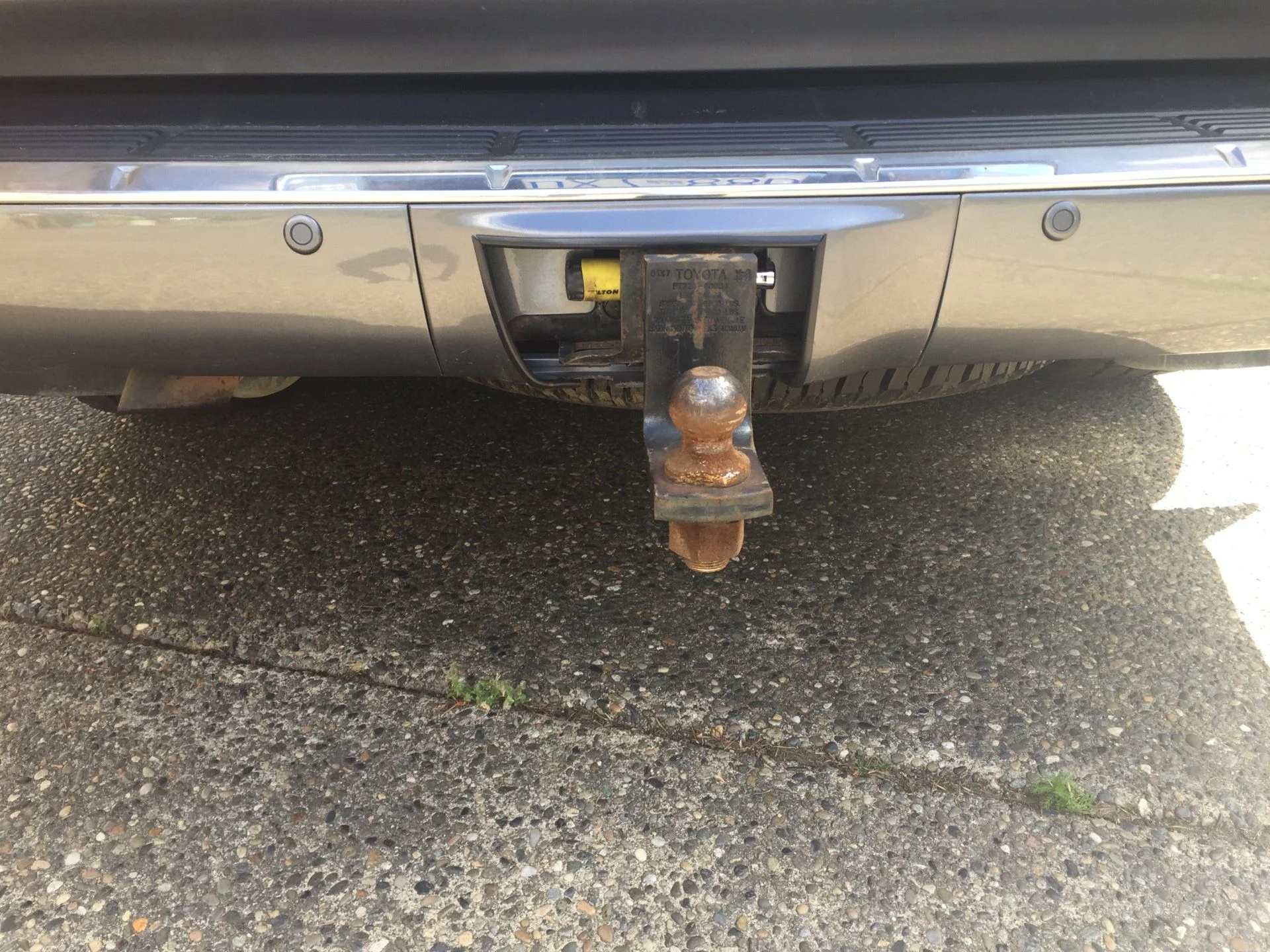

Looks good. Does it affect the rear sonar at all?
Looks like only two screws holding fab bracket to the hitch. Can't tell from picture if you used any from bottom to hold that together. It looks good and its functional. I don't think it will effect parking sensors as bracket is not directly in front of sensors. OP can chime in confirm that.

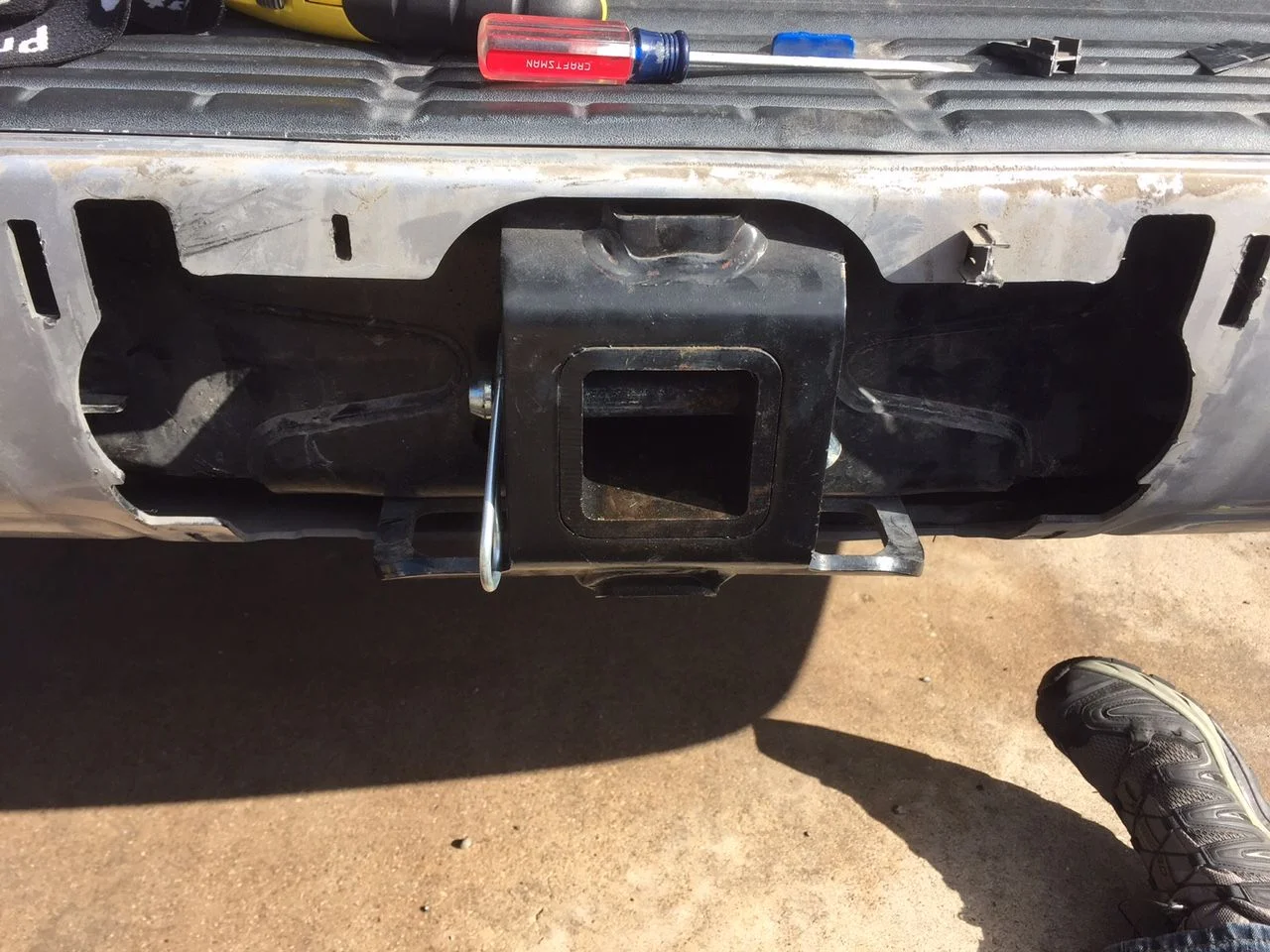

For those of you with a bike rack mounted on the rear hitch, I noticed that for example the Thule Vertex uses a pin that locks the stinger/bar of the bike rack in place. I haven't got a chance to take tow hitch cover of my 2009 LX570 yet, but can anyone confirm that the LX570 hitch receiver has a built in hole?
Following up on an older thread...
She's anatomically correct down there and can receive any standard 2" accessory. It's just a bit tight to the sides of the hitch pin hole, but should work without issue.
I use my hitch so often, that the cover stays permanently off. Doesn't bother me that her bits are exposed.

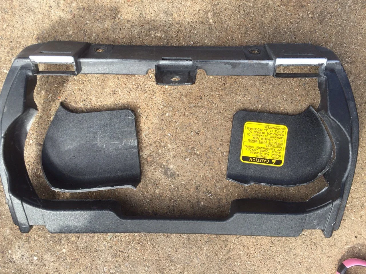

Why not use the factory cover and cut out a square for the hitch. New cover costs $75. Actually after looking at this post may want to do that myself. Part # for mine
52169-60190-B0
52169-60190-B0
I’m looking at that option and needing to make space for the chains and somehow retain the bottom clips?
Didn't think about chain loops. Just looked at the cover and bottom clips do not overlap those ears. I don't need to thread chains through and just connect hooks. Should be doable with dremel.
I think i still have the cover for mine if anyone would like to try fabbing it. Its free. If you want it pm me. Ill look this weekend
