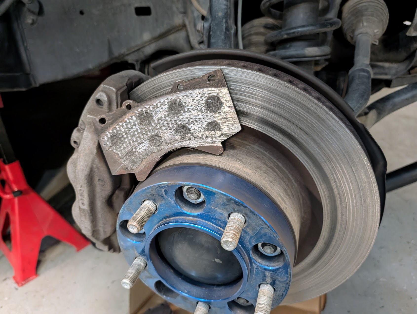

My 200-series has seen more canyon carving than my sports car LOL, and Valvoline Synthetic holds up. Hawk LTS pads, not so much (but that's my fault for driving them well beyond what sane people might do). They are excellent pads if you want a real upgrade.
