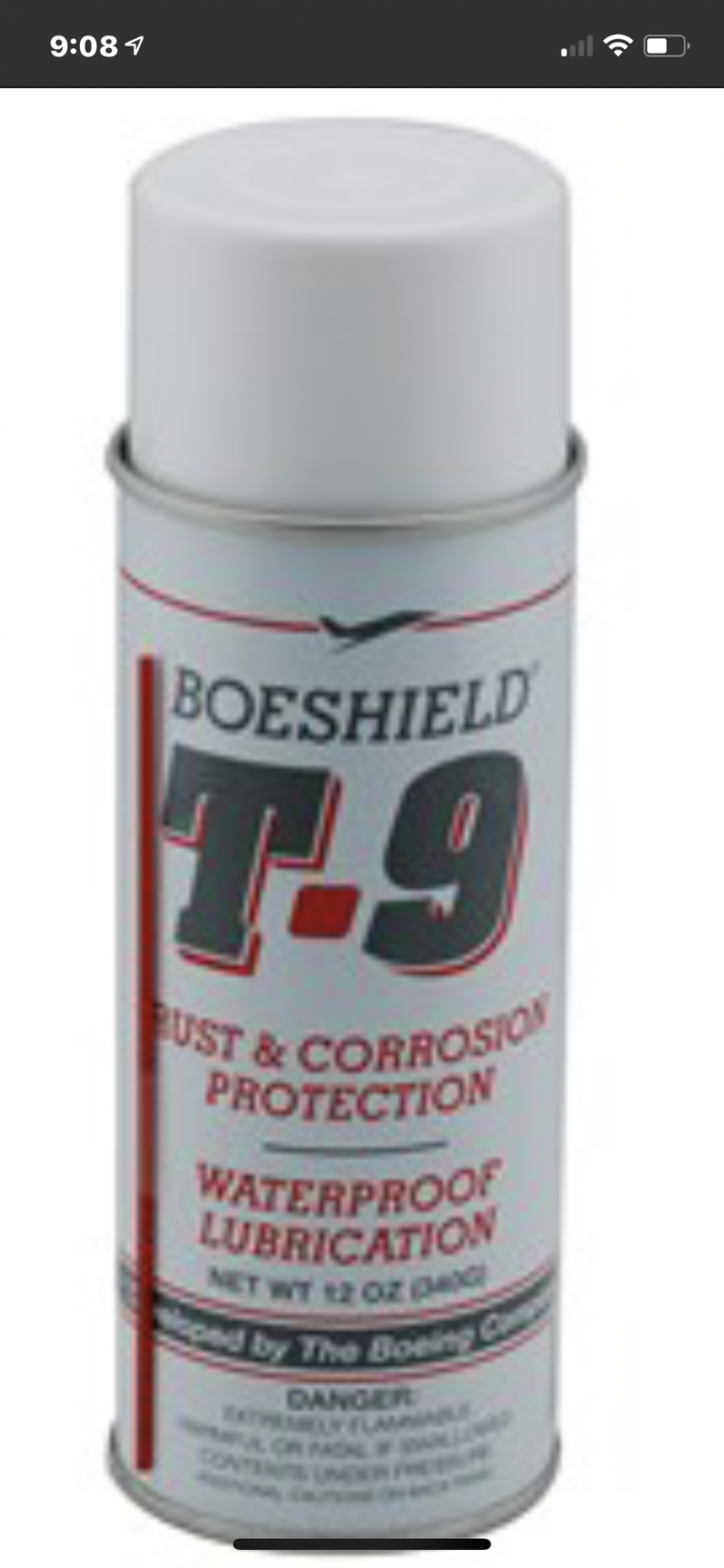

Like all of you i had the clunk. Had it sitting at a stoplight. When taking off, shifting gears at times. So, i decided to do a sensor lift. Starting out cleaning them up and lubricated the moving parts. Also, lubed the drivelines. Okay, i just picked up a can of Boeshield and i sprayed my sensors, drive shafts, U joints, emergency brake. Just about everything under the truck that moves. Left it to soak overnight and the next day while checking out my new ride height i noticed something very strange.
My LX didn't go thump and bump anymore. Was it using a full can of Boeshield after two cups of coffee or lubing the drive shafts? I'm telling you this thing is Tesla quiet. What do you have to lose.
On an unrelated topic, I use this to clean all my woodworking equipment (table saw, bandsaw, etc). Works great!
