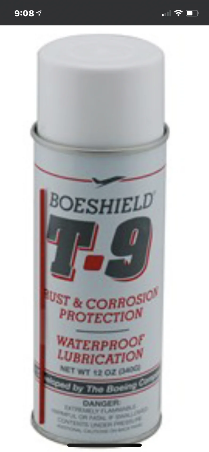

Like all of you i had the clunk. Had it sitting at a stoplight. When taking off, shifting gears at times. So, i decided to do a sensor lift. Starting out cleaning them up and lubricated the moving parts. Also, lubed the drivelines. Okay, i just picked up a can of Boeshield and i sprayed my sensors, drive shafts, U joints, emergency brake. Just about everything under the truck that moves. Left it to soak overnight and the next day while checking out my new ride height i noticed something very strange.
My LX didn't go thump and bump anymore. Was it using a full can of Boeshield after two cups of coffee or lubing the drive shafts? I'm telling you this thing is Tesla quiet. What do you have to lose.
