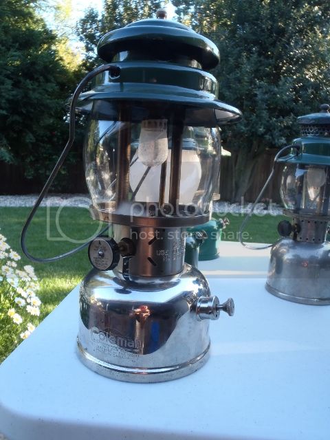

All I have is a couple of crappy pics of my 236. It's very close to my BD lantern(1 month off), notice how the vent changed from Cam's. These lanterns are blindingly bright, fuel hogs and great in every way.
Dimmed here a bit for day light photos:
These are about the best it ever got for Coleman. All the parts, from the burner, the air tubes, the fount, the valve, even the support are brass. 500CP which is about the best they ever did with white gas. They got a tiny bit brighter with the 635 and some of the later Kerosene (which has more energy per ml than white gas), but they are crazy bright.
