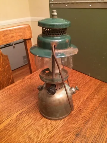

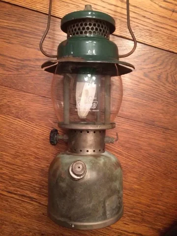

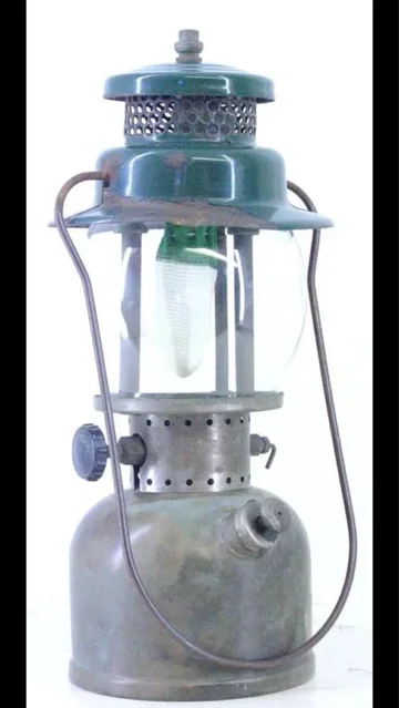

I was looking on eBay and noticed this crusty old May 1950 242C ending in a few hours and it was still under the magic $20 mark (OG's NEVER pay more than $20 unless they want to risk losing their OG status.)
I "watched" the listing and set my phone timer to alert me a few minutes before the auction ended. After checking the listing a little too frequently, the ending finally arrived. I set my max bid way over the $20 mark, but luckily won it for $19.50, hopefully keeping my street cred intact. (Thankfully, shipping is not part of this $20 thing, I'm told.)
It showed up yesterday and it's even better (or worse, depending on how shiny you like your junk) than the pictures on eBay. The only bad spot on the lantern is the 1"x1" good spot of nickel left on the fount. Everything else was rusty, dusty or patina'd.
I, of course, immediately tried to pump it up, hoping to hear it hiss when I opened the valve. Nope. The pump was dry and the cap gasket was shot. I anticipated that so I ordered some cap gaskets, which got here today. I also put the pump in some motor oil, hoping it could be revived enough to work.
I burnt the old gasket out, put in the new, re-installed the pump, swished a little bit of clean fuel in the tank (it came out clear), and burnt down the supplied mantle.
Cruiserdrew also mentioned that I would want a No. 0 Coleman Filter Funnel. I laughed, but looked them up on eBay. They looked way cooler than my similarly shaped plastic funnel. Of course I had to buy one.
Unfortunately, it hasn't arrived yet. And the filler hole on the 242 is TINY (provably the real reason he said I will want one of these funnels.) I probably spilled as much fuel as I got in the tank.
I pump it up, crack the valve and hear the reassuring hiss of air. But I don't hear the spittle of fuel. I try to light it but nothing happens. I pump some more, turn the cleaning lever and open the valve some more. This time it lights and promptly turns into a giant fireball. Fuel is leaking from every valve and fitting.
I blow the flame out, tighten the valve nut, and open the cap to let some pressure out. I light it again, but this time there's no fireball.
I give it a few more pumps, and open the valve once it stabilizes. I left it running and when I checked it about 45 minutes later, it was still going strong.

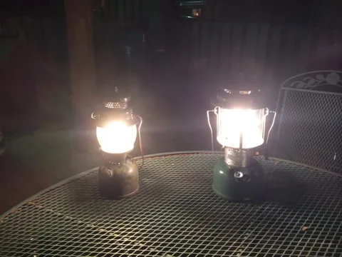

Hangin' out with the 200A...
:steer:
Like the two best camp lanterns ever, right there. Bright enough to be useful, small enough to always go.
Congrats. The 242C is an especially good lantern. Easy to work on (like a 200A) and "old school" cast brass. Even the burner frame is brass on most of them.
Yours is well worn. Kind of makes it the perfect lantern to pack inside your stove (which is also well worn as you will see soon).
Hopefully you just had some minor dirt in the fuel system. It looks like they both run perfectly.

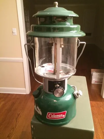

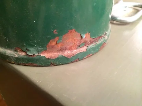

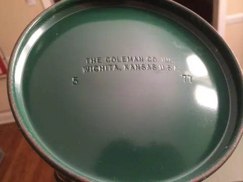

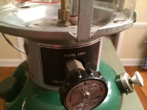

With that said, I am offering this barely-used May '77 220J [STRIKE]***FREE TO A GOOD HOME***[/STRIKE]. (GONE) It looks like the one time it was used it was to do concrete work in the dark. It has concrete splashed all over. I have not tested it with mantles, but it pumps up nice, holds pressure, and makes gurgling noises when you turn the valve. It does still have some old fuel in it, so it could take a little tinkering to work, but probably needs no new parts.
I got it for free, have not used it, have no plans to use it, so I'm setting it free.
I have a few more in various stages of completeness for the same price if there is interest.
[STRIKE]Send me a PM if you want it.[/STRIKE]

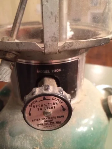

November '79 220K
It pumps up nice, holds pressure (not sure how long though), hisses when you open the valve. Should work with minimal fuss, but not as nice as the last one. Comes with a sparker. *Might* need a new cap, not sure though. Comes with a one-piece cap, not the one in the pic.

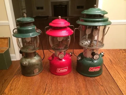

For a size comparison, standard two-mantle on the right, 200A in the middle, 242 on the left...
Light output 220 vs 242...
