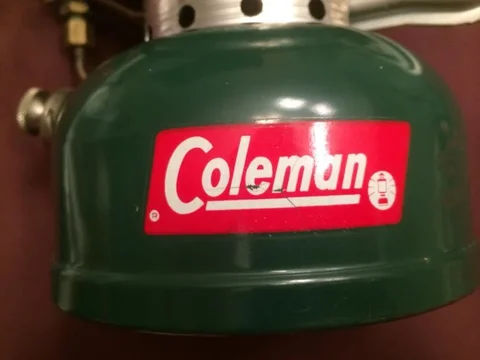

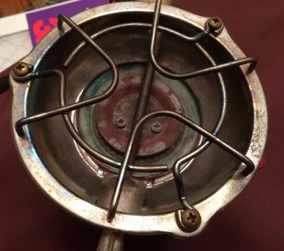

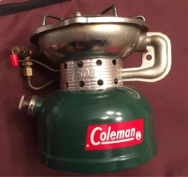

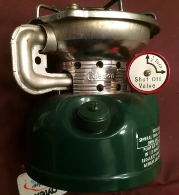

I was perusing the evil place late one evening and, in a moment of weakness, found myself the winner of a beautiful 502.
It looks like it was only used a few times. The fount is perfect, the only exception being a small crack in the decal. Most of the rust colored stuff on the bowl wipes off with a wet rag. Five minutes of elbow grease should have it minty fresh.
I don't know if this came from the factory like this, but it has a fount from the short-lived 501. I'm guessing it was a transitional piece?
It pumps up nice and spits out the remains of the PO's fuel when you open the valve. I'm pretty sure I'll be making coffee on it in the morning.

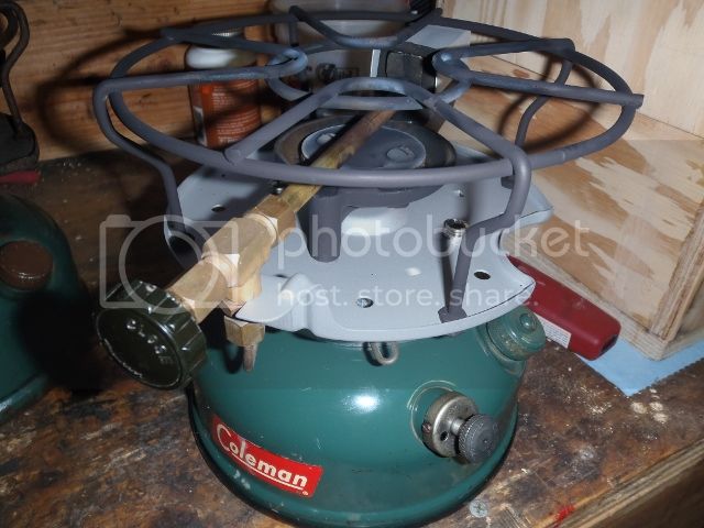

Cam-I've used the VHT 2000 degree paint and it works very well for burner bowls. After some use, they get a little brown, but it protects from the rust quite well. I painted 2 500A cast iron burners with it and since its black, it looks perfect. I did the 250/400/600 cure in the oven and then ran it full blast for 30 minutes. You don't need the primer or the clear.
You can kind of see it here:

Nice! Is the silver support tray painted with that same paint?
The silver support tray is just regular Rustoleum high temp (I think 1200 degres)
