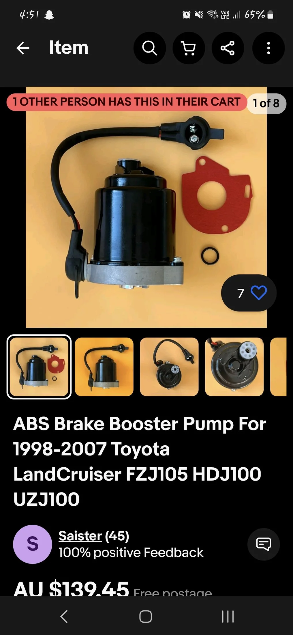

I got
Motor - ebay was 150ish
Accumulator- patr store here in Aus 400
Repair kit - eBay 180
When I have some time later today I'll get part numbers for you
Bellow are screen shots for what I grabbed and also the mastercylinder bleeding that can be done without the scan tool,
There is a really good thread on here for the removal and repair of the cylinder rebuild kit, I can't remember who did it but its very helpful and amazing walk through with photos,
I also cleaned and blew air through all ports on the cylinder to clear any junk

Thanks for this fabulous post Brad. $753 and 4 hours work (after waiting for parts) and my son's Cruiser is all good again. :D
He was quoted $3500 by the local Toyota dealership.
