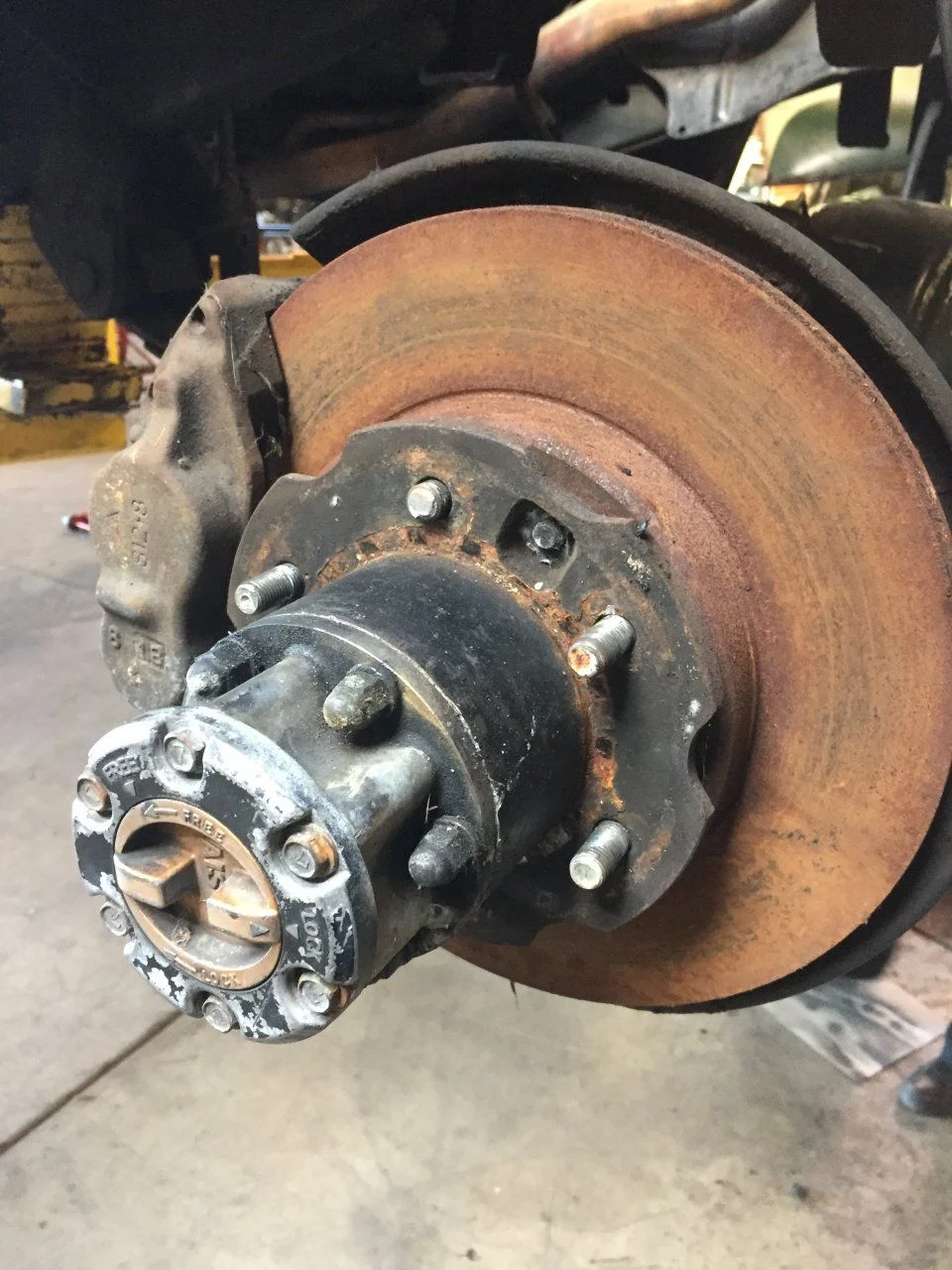

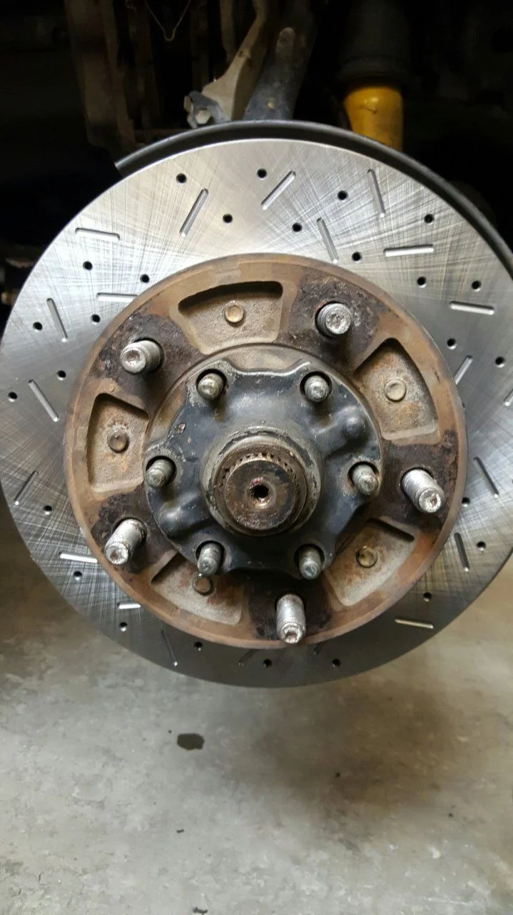

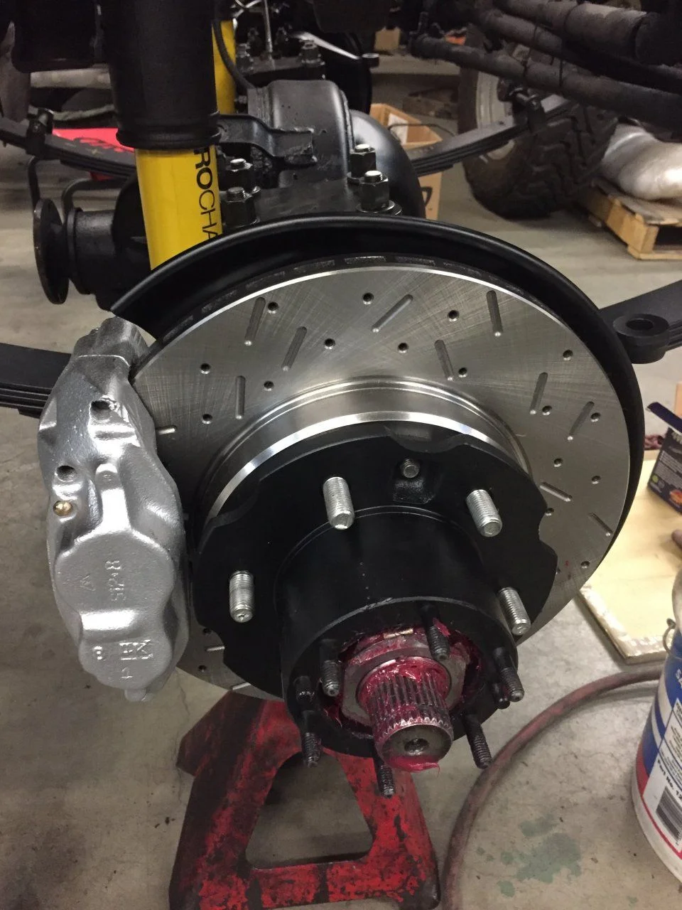

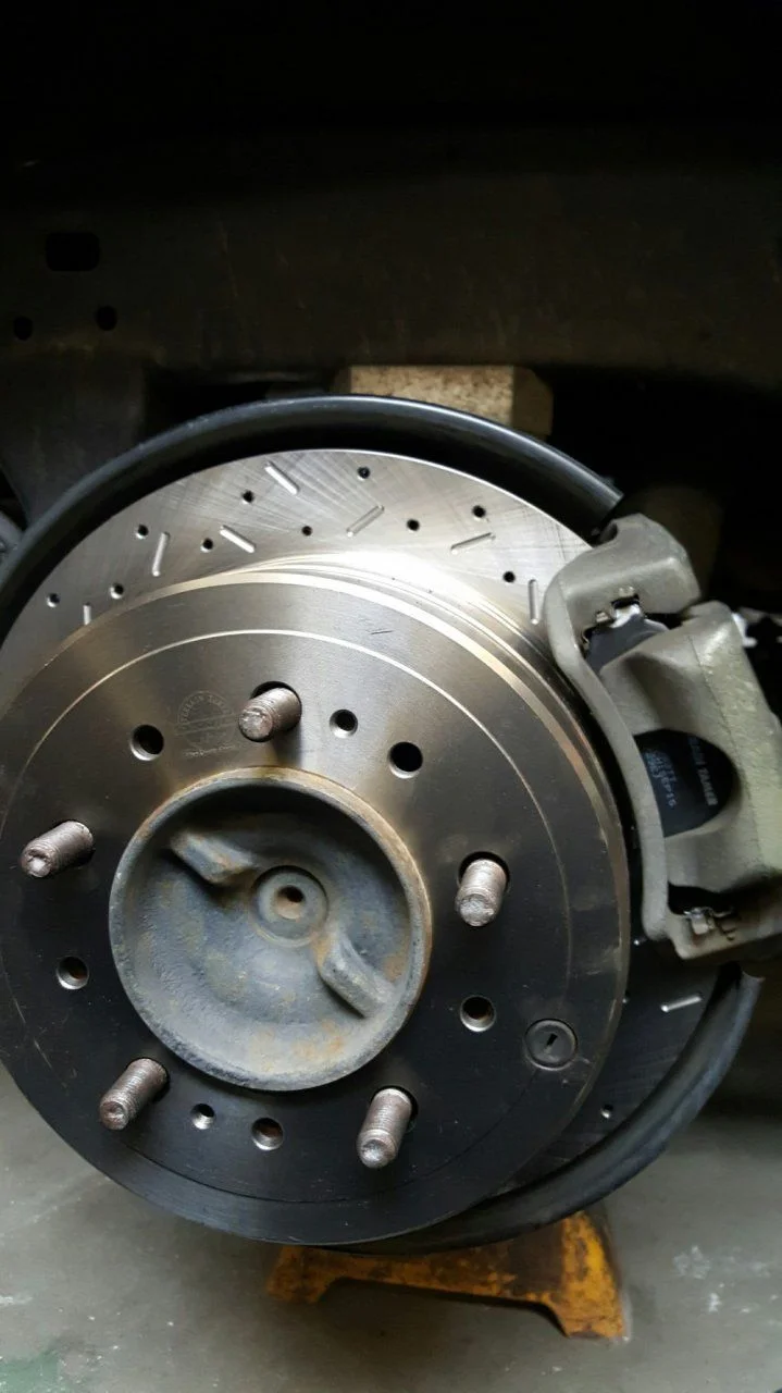

Here are a couple of "before and after" pics of a customers FJ60 we're working on right now. Part of the work is a complete knuckle rebuild with the Terrain Tamer kit and brake package.

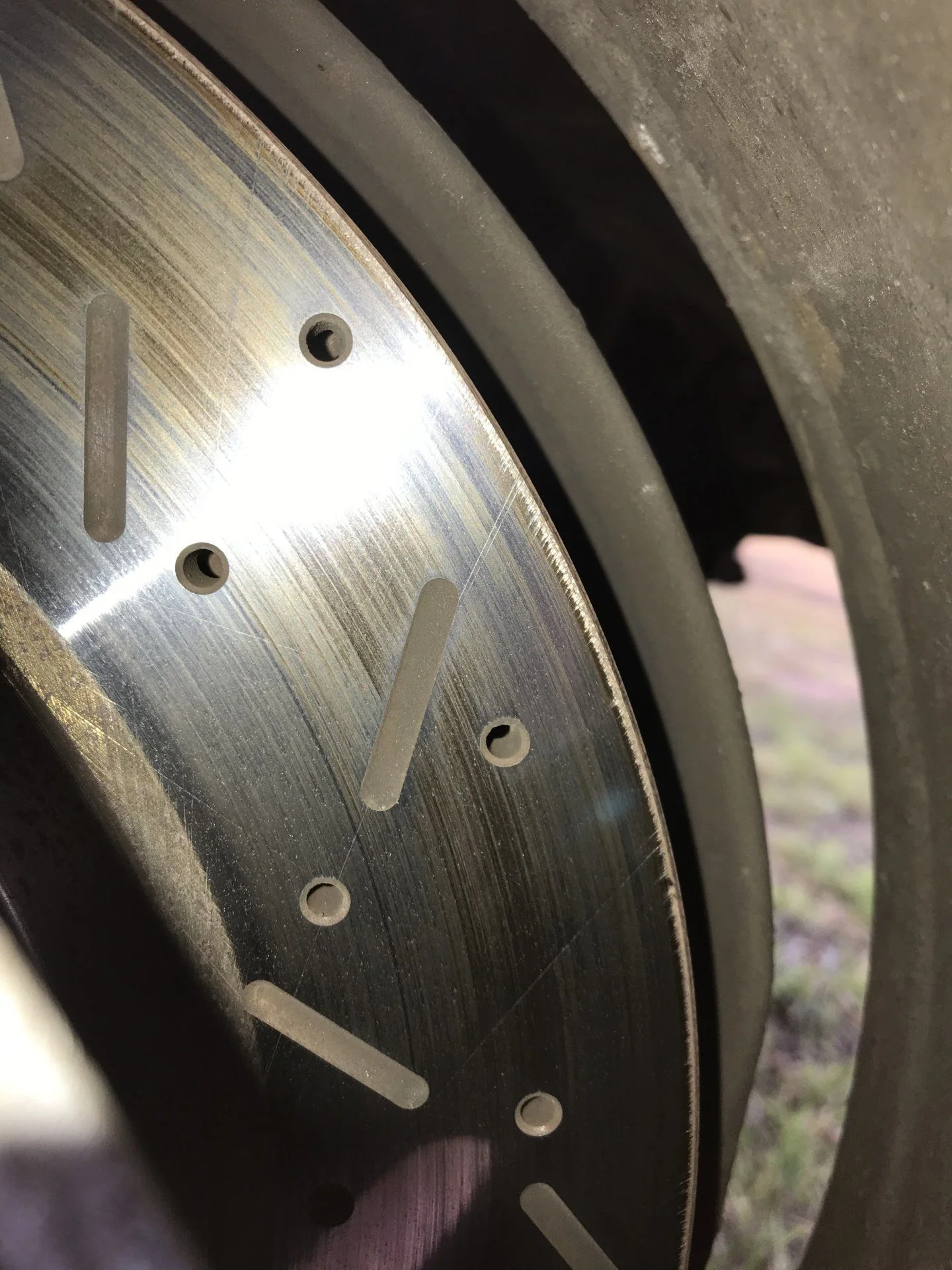

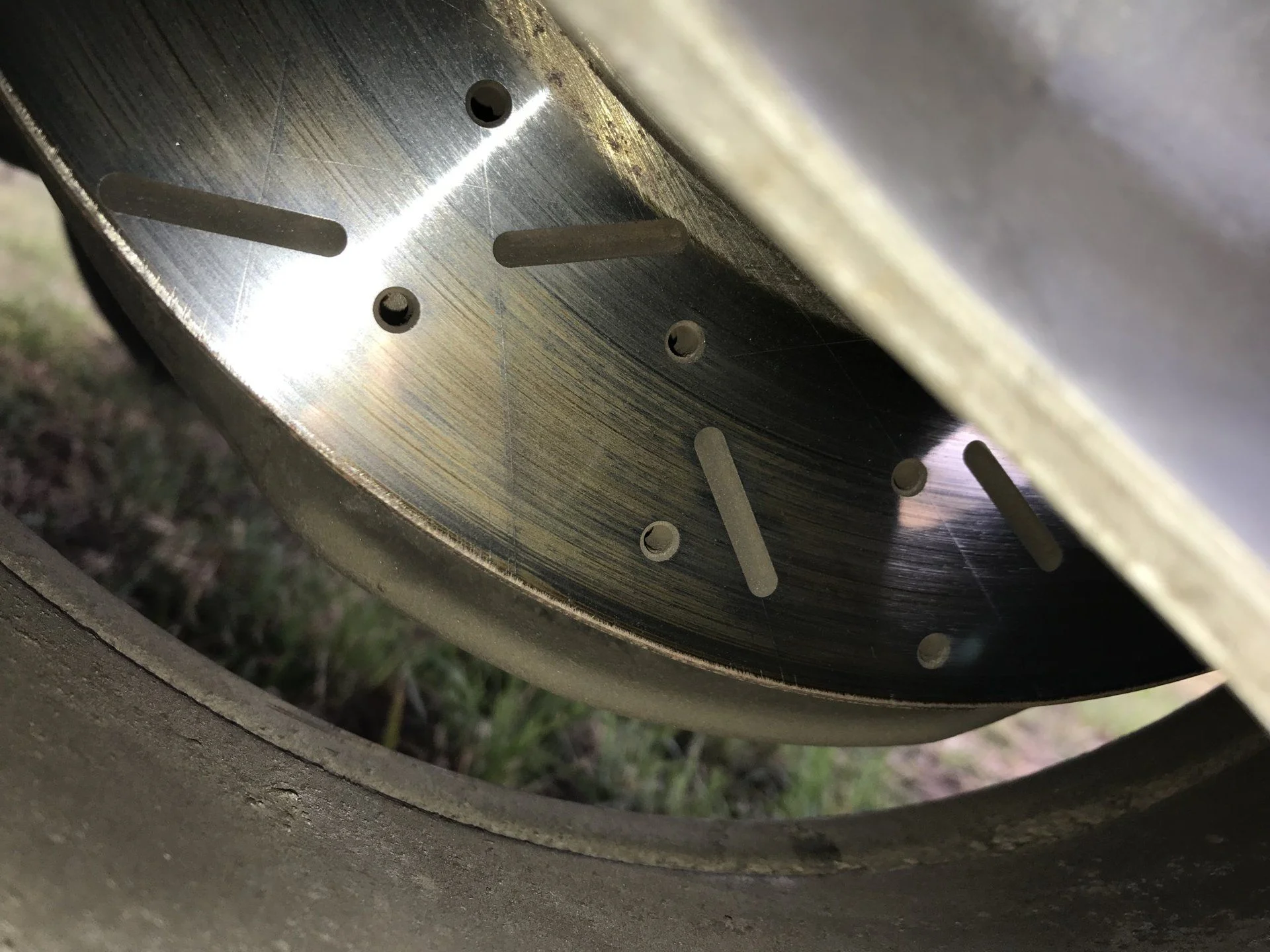

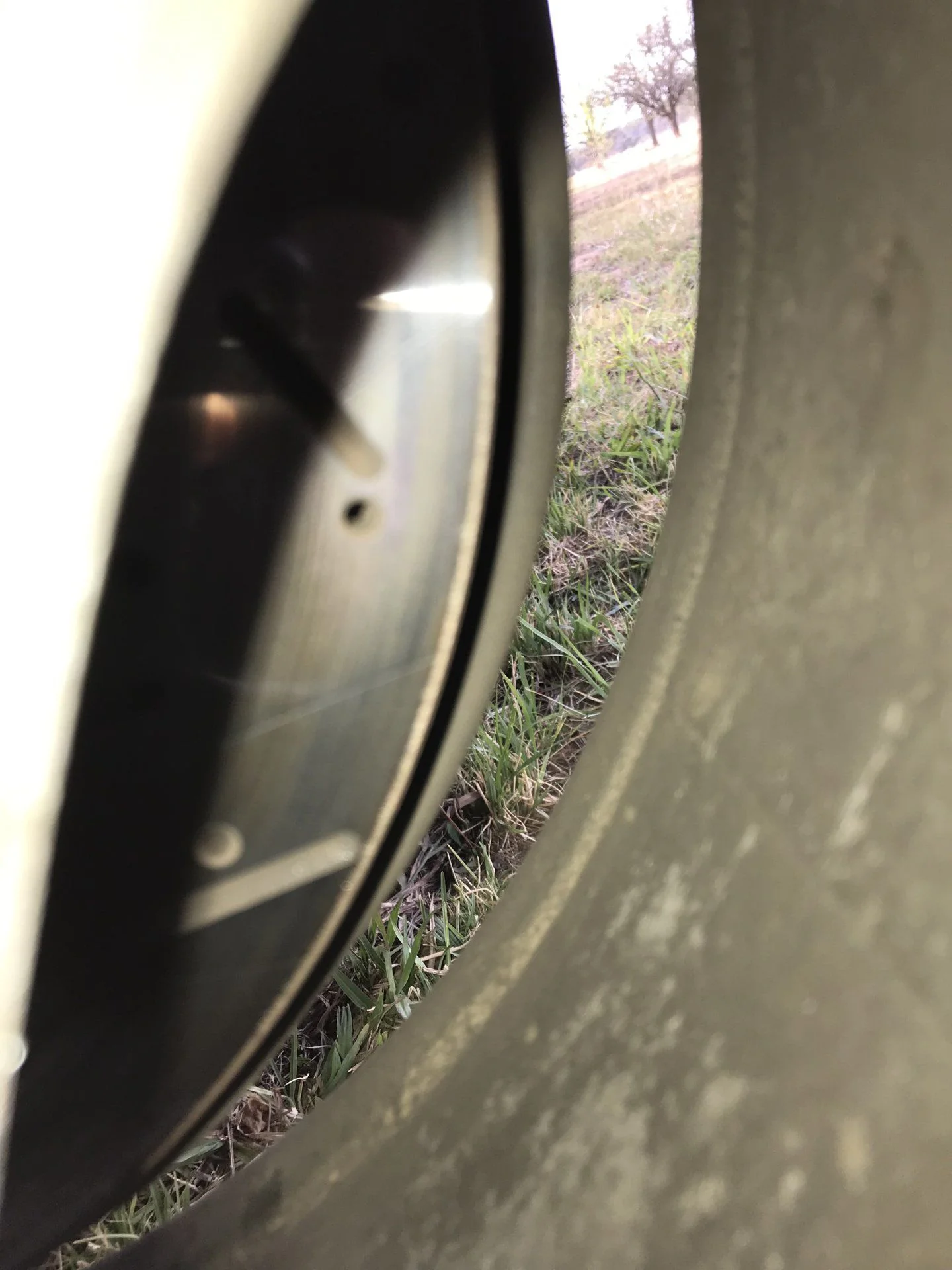

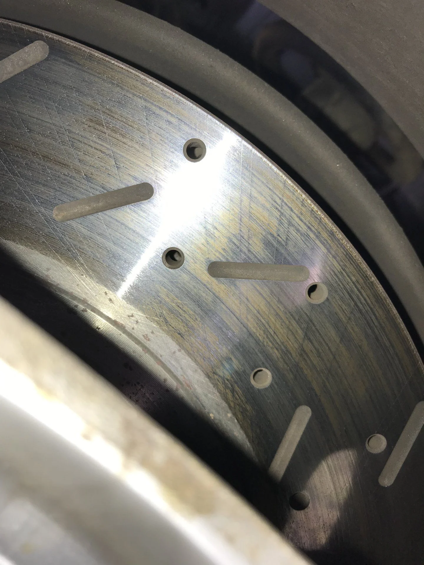

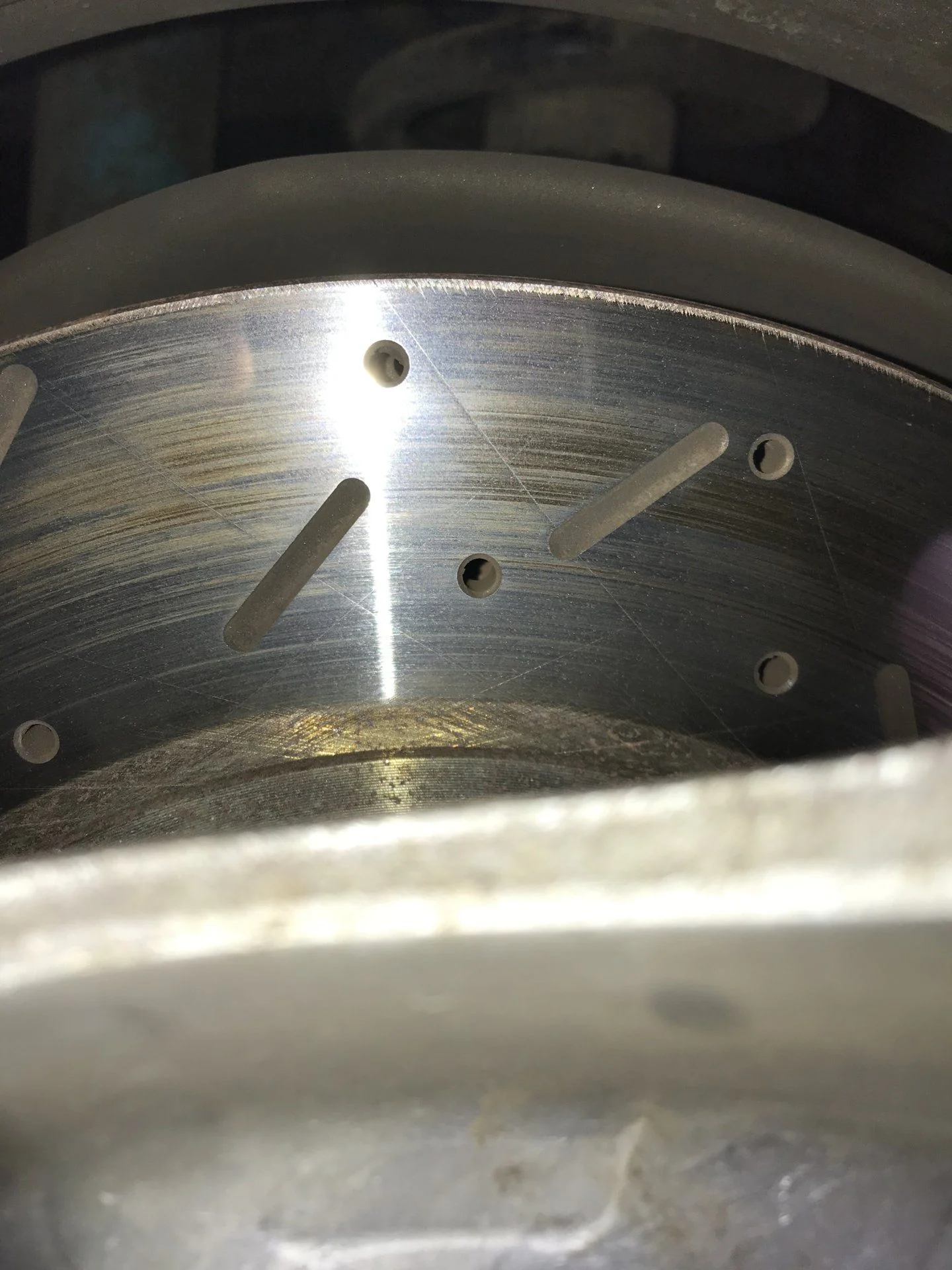

Sorry if I’m digging up an older thread as it’s a year since the last reply😂. I installed terrain tamer hp slotted and drilled rotors front and back of my fzj80 and installed the hp pads as well they are now about 3000kms old. They are a massive improvement from what was on there before! But recently I’ve noticed marks or lines on the front rotors. And I’m not sure if they are supposed to be there. I’ve attached pictures of them. The back are fine though. Just looking for advice. Thanks in advance. Note I did not rebuild the callipers at this time as they seemed ok and it would have been inconvenient at the time.
1902844
1902845
1902846
1902847
1902848
Looks like the machining of the rotor.
Look at the first pictures in this thread
Normal pad wear. The buildup is material lining transfer, a normal and critical process enabling proper pad grip. The lines are just rotational representations of this phenomenon. Hope Georg approves of my description. Heh
