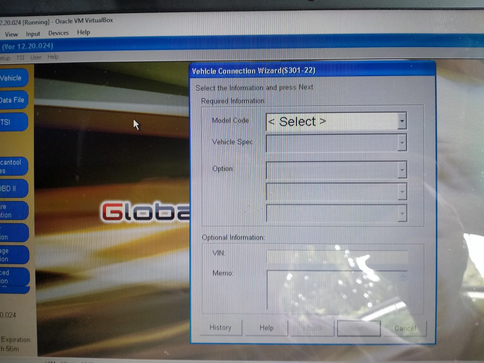

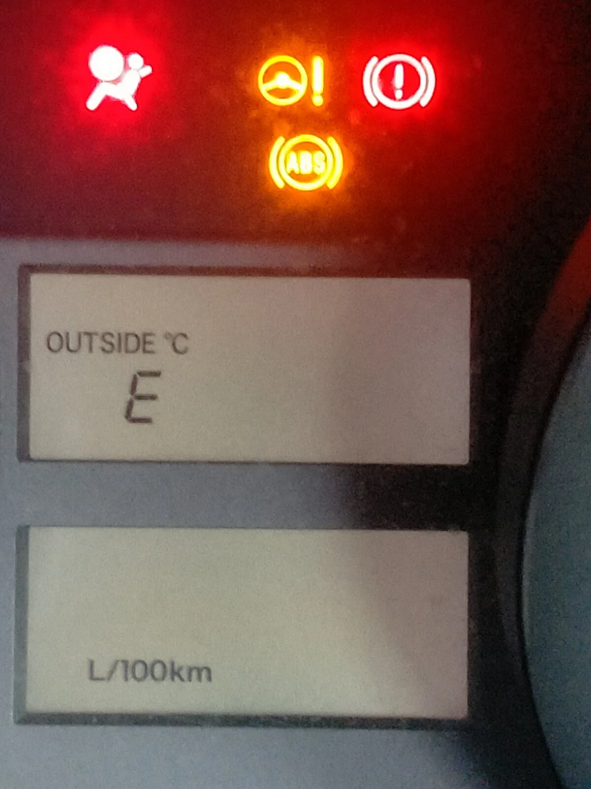

G'day, I have been reading through your posts in this forum as I also am having difficulty with what I thought was going to be a straight forward process with Techstream and Mini VCI cabling to my 2010 KDJ150. Interestingly, I have all the gear and it appears no idea!! I am having trouble with Techstream/VCI reading the ECU and I have narrowed it down to driver issues...I believe? When I load every thing up and it begins to communicate with the ECU it throws a code on the laptop "S301-23 Communication error with engine ECU, please confirm that engine ECU is properly installed". (Please see attached images).
Further to my conundrum I have plugged into a '2016 VDJ79 and it is happy to go through the process with no issue. I noticed there is some discussion about the 1GD engine and the necessity of Version 2.0.4, I have Version 1.4.1 which I along with many others have purchased from eBay. Is there a patch or firmware update I need to make it work?
