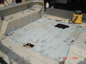

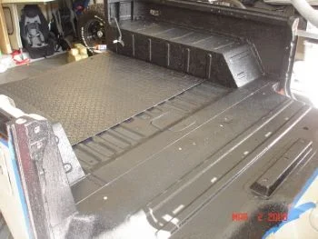

After much thought, consideration, and advice, I decided against a new tub. So after many hours of cleaning, grinding, some fiberglass resin, a few bottles of Chem-Prime, some Industrial Grade Marine Zinc- Clad Cold Galvanizing Compound, a few coats of Kem Kromik Primer and several coats of Plasti-Kote truck bedliner this is what I now have.....
:clap::clap: Well done bud it looks great. I know who to call when I'm ready to do mine :D That'll take care of you for sometime. :)
little late for POR-15....sorry fellas, but I've been spending most of my time in the NON-USA and DIESEL/JDM forums lately...
True... but he has enough rust converter on there to convert it from a cruiser to a mercedes ;p (sorta)
