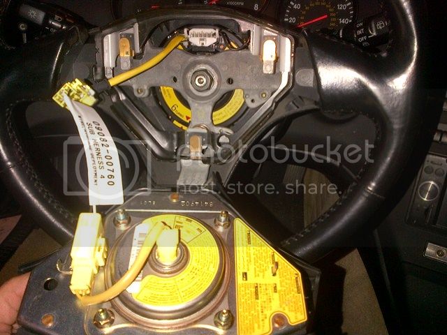

Autoliv makes the Driver airbag for my LC and LX 100 series airbags.
Pic attached shows brand name.
