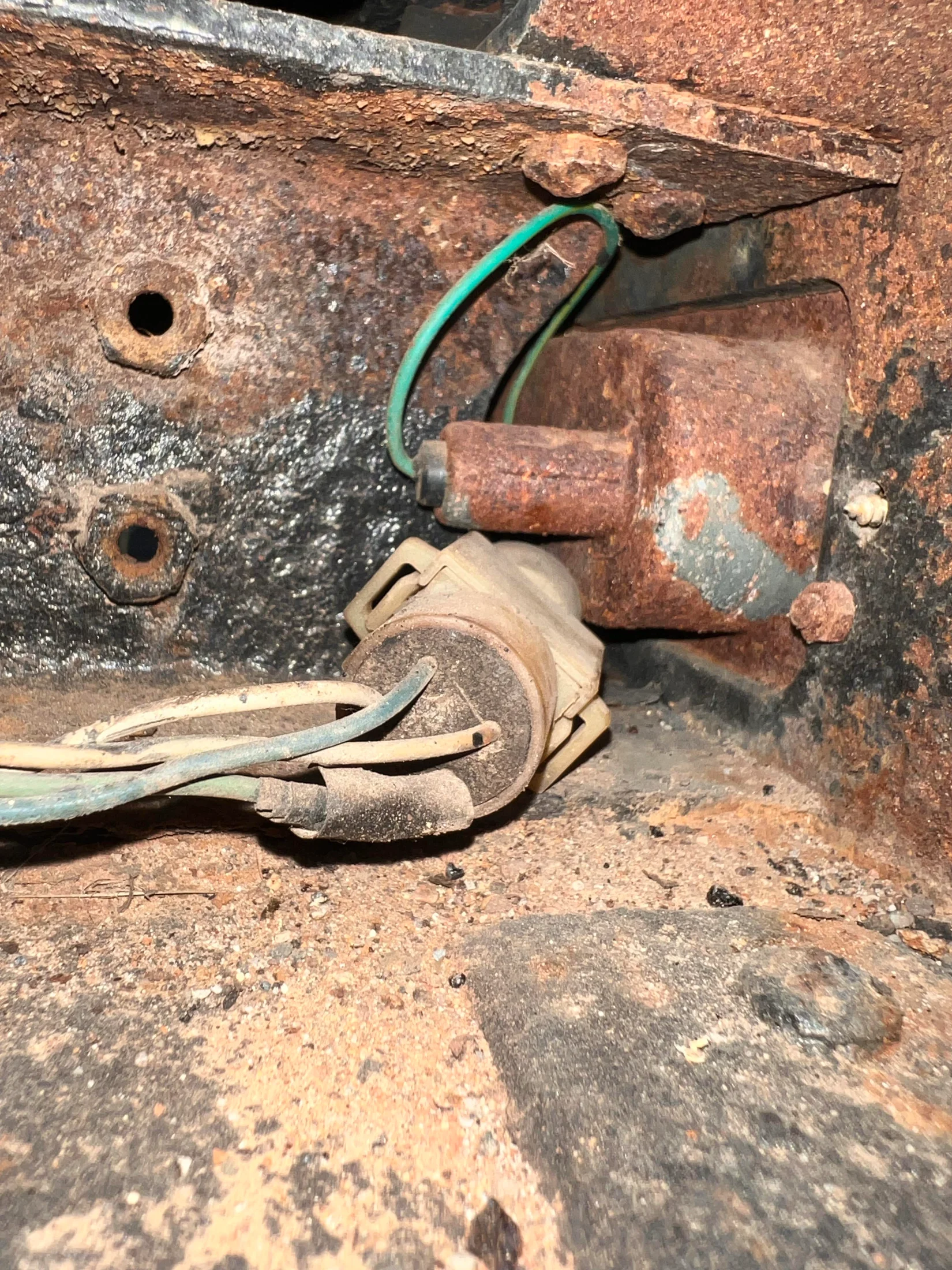

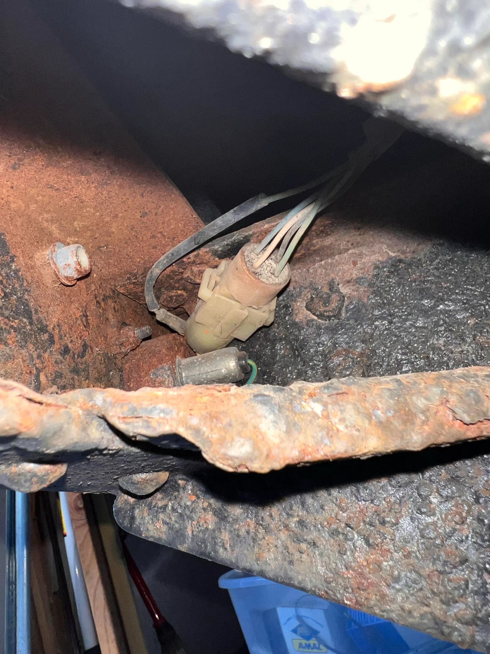

My tail lights are badly corroded and I can't get them cleaned up to the point of having all 3 bulbs working. I want to replace them, however I see lots of rounded plug versions for sale. My plugs appear to be square. Where can you find replacements with that plug?
A picture or two of the plug(s) you're dealing with would help.
The plastic bodies could probably be cleaned up and reused. Get some new terminals and a crimp tool.

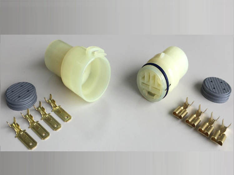

I replaced my tail light assemblies and they have the newer round style and came with matching plugs to attach to the harness.
Toyota Matt sells them on his site if you are not in hurry.
