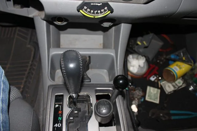

I got tired of my Tacoma's transfer case and all the BS it has put me through, so I swapped it out for an FJ Cruiser case.

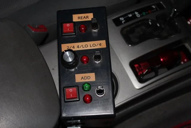

I started having problems with the electric actuator several years ago and had to wire up a relay box because the computer refused to shift in & out of four wheel drive reliably.
The relay box still had problems, especially when it was very cold, and I am glad somebody showed me how to swap in a FJ transfer case, so
I put a little Cruiser in my Taco​
Original relay box I wired up
Twin sticks on the FJ Cruiser transfer case
