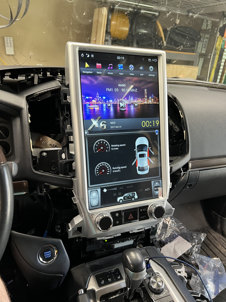

Here are a few photos as I removed the dash and stock HU.
Some tips on removal: The bolts are 10mm, cover anything that could be scratched unless you are absolutely steady handed or don't care, work in a place that isn't 100+ degrees (I had a portable AC in my garage thankfully) and those plastic trim tools came in handy but aren't completely necessary.
The unit came with a wiring harness which had many, many connectors. Important thing to note is that not all the connectors are used in the wiring harness but there are some additional cables that are included which ARE used such as the usb connector and antenna connector. The EC Offroad videos are pretty good on sorting out which cable does what but there is a bit that is missing which I had to go back and forth to figure out and that includes one of the separate cables that I realized wasn't used on my specific year model. (Wish I could be more specific but I honestly don't remember what it was for)
The method I used for installation was to connect the wiring harness to the car connectors, push all the cables to the top portion of the radio bay and get them ready to connect to the head unit. Admittedly I got a little frustrated at this part and forgot to take photos...my bad. There is an HDMI connection on the back of the unit which you can run the included cord to the rear console and plug in for the rear screens. I ran the cord tucked up into the base of the center console and popped out next to the passenger seat. Admittedly, I have removed a screen so that I can fit a car seat for my 1 yr old and will probably remove the other sometime in the future for the next one coming soon so that HDMI cord may be a moot point for me.
I then attached all the cables that are needed to the HU. There are quite a few connectors on the back of the HU that aren't used which made me recheck that I didn't miss anything. After tucking the cables and mounting the HU it looks like this:

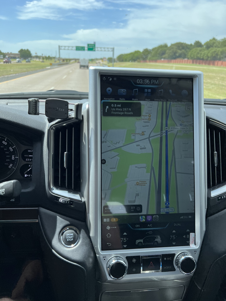

Overall Impressions
I've been using the unit for over a week now and overall I'm happy. I've mentioned there are quirks but going into this swap I knew there would be things that may not be exactly how I would want...just like any head unit swap I've done in the past.
The good:
Carplay is Awesome! On a 16" (diagonal) screen it is easy to navigate while driving.
The unit automatically connects via Zlink to my phone wirelessly.
The built in equalizer is better than the stock unit and next I'm going to install another equalizer which works even better (there's a video to install that's done by Sergey).
I can play the XM app through Carplay so what I lost natively I have there on my phone.
The left knob on the unit is volume which I liked being able to turn up and down easily.
The air controls are right there and relatively easy to use. Fan speed up and down is a push button next to the volume knob.

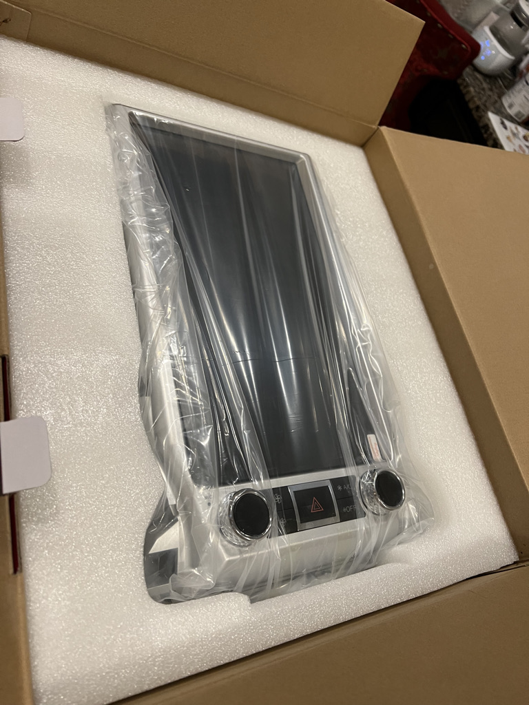

What Comes With The Head Unit
The primary head unit of discussion in this thread is the ZhiFang ZF-1829G. Here are some additional pictures of the head unit and the cables that are included.
Here's the back of the head unit. It's fairly obvious what plugs in where because other than the WiFi and GPS connectors, everything else is keyed so that each connector only fits in one location:
The only included cable I didn't bother taking a picture of is the HDMI cable since there's nothing really special about it.

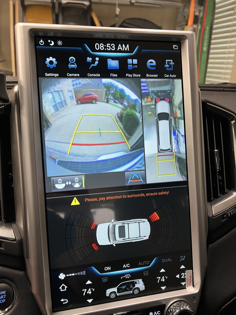

360 Camera Wiring Note (refer to the attached ZF-1807XH Installation instrument.pdf file)
I ran into an issue getting the 360 / backup camera working, so the place I purchased the unit from sent me an installation wiring diagram (attached) that shows which connectors plug in between the factory harness and the supplied harness pack that comes with the head unit. On my 2020 Land Cruiser, the problem I ran into was that even though my factory wiring matches what is shown on page 2 of the PDF, the connector on the gray cable (labeled as 7 in the left photo) isn't keyed to easily plug into the corresponding blue connector on the harness that comes with the unit (labeled as 7 in the right photo). However, the very similar blue connector from the factory harness (just below 7 in the left photo on page 2) fits perfectly. In the end, the gray cable needs to be plugged in, even if some force is required to override how the connectors are keyed.
Update (8/15/2022): After going on a long vacation trip with the LC (around 3000 miles), I found that the camera connection was extremely sensitive to movement. During the trip, I ran into a few really poorly done repair patches on highways in upstate NY. In one particular case, the patch almost made me lose control of the vehicle, kicked cruise control off, set off the traction control alarm, AND resulted in my 360 camera not working next time I went to use the backup camera. Fortunately, I had brought a few tools with me and I was able to get access to this connector by pulling out the driver side vent rather than having to take the entire head unit out. I found, however, that this harness was very sensitive to being moved. Moving it just a bit in the wrong direction could freeze the camera image or make it go blank.
When I returned from my vacation, I decided I had to figure out the problem with the connector not fitting well. It was clearly an issue with the connector on the supplied harness being keyed incorrectly for my factory connector. After contacting the vendor, it was clear that he either didn't understand the problem (even with pictures provided) or they simply don't have another harness available with the correct keying on the connector. I didn't want to modify my factory connections, so I ultimately decided to modify the harness that came with the head unit. By removing the plastic circled in red below (all the way to the bottom of the connector) on the 360 adapter harness that came with the head unit, the factory connector now plugs in pretty easily and I can wiggle the harness around as much as I want without causing any issues with the backup camera freezing or going blank. I used a sharp Xacto knife to remove this piece - it's amazing how little plastic there actually was, but it made all the difference. I started a separate post about this issue that includes additional photos. It looks like 2018's have a different connector that may fit without modification. 2020's and most likely 2021's will need this modification done. It's unknown, for now, which version of the connector 2019's will have.

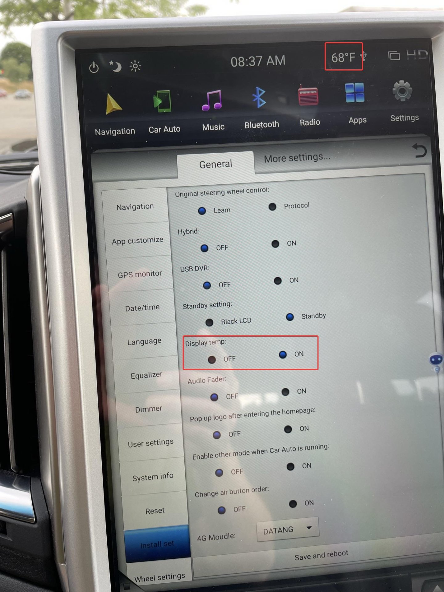

Install Set Settings
Note: it's potentially possible to brick your unit by making invalid choices in this menu, so proceed with caution.
To access the Settings > General > Install Set settings, a password is required. I was provided with 2 possible passwords: 7890 or 8861. 8861 worked for me.
Outside Temperature
Once in the Install Set menu, find the "Display temp" setting, turn it on, and tap the "Save and reboot" bottom to save the setting. Without this enabled, the head unit won't read the outside temperature from the car and will just display a default value all the time. Sergey's custom firmware has an option to retrieve the temperature over the Internet from a weather service, but I would rather use the sensor built into the car.

Adjusting 360 / backup camera picture quality
See this post for tips on adjusting the brightness and contrast.
By default, there are grid lines from both the car's 360 camera system AND grid lines added by the Android system. Turning off the grid lines that are generated by the Android system makes the cameras a lot more usable. It may be possible to turn off the grid lines provided by the car as the touchscreen does control the settings in the car's 360 camera system and there may be advantages to using the Android system's grid lines instead as they can be adjusted. But using both makes the camera much harder to use.

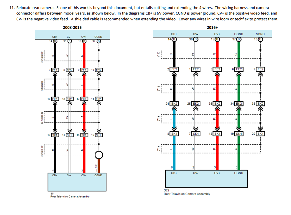

There are a few threads here which talk about the factory cameras are 5v and most aftermarket AHD or high resolution are 12v. I'll have to go digging around to find the one where a guy had made a voltage converter to use an aftermarket camera replacement in the stock setup. I really don't want to rewire the cameras and would love to get away with splicing them in but knowing my luck I'd have a loose connection that I would have to chase down. The aftermarket camera solutions come with their own decoder box and can be synced with your blinkers to show your blind spots when you activate that side.
Here's the thread with the discussion of using a voltage converter:
I have a trip planned the last 2 weeks in July, so it sounds like I would be ill advised to try to do the swap before then. But based on your feedback so far, I think I'm going to plan to go ahead with the same path you took. I just need to get the full list of possible head units to see if any of them might be a better fit for me, but I really like what I'm reading and seeing about yours.
I have a 2013 and I (temporarily) swapped the camera. Mine seemed to have a bit of noise in the video, and eventually I just relented and relocated my factory camera rather than monkey with it right now. The new camera wasn't really any better quality than the OEM one, at least in daylight, probably due to the crappy 2008-2015 screen resolution.
To put in a 12V camera using the existing wiring the parts you need are here:
In the above you'll need to wire the 6V-to-12V converter inline. Alternately you can try to find a circuit in the trunk which has 12V switched power and just tap that for the 12V you need for the camera (which will leave it powered on all the time, but you really shouldn't care).
Pretty much any 12V camera should work, though if you're trying to keep your camera in the factory location you should take good measurements and then try to find a square camera that you can retrofit into the existing mount.
Wiring info is below from my RLC bumper installation notes, note that the pin-outs changed in 2016, and that the ground wire in 2008-2015 is tied to the shield but in 2016 the shield is separate.

I had seen an aftermarket 360 camera wiring diagram on Alibaba and there was only one note of tying into 12v from the tail light and turn signals on the mirrors for power. I'm going to mull over the whole camera switch until this Fall or when it's not so uncomfortable outside to do the work.
Could be the 6V-to-12V converter, or it could be the camera. I wired all 4 pins and the video was there but scrambled. I bound the V- to the ground sheath on the factory harness and that "fixed" it. However the video still had a bit of a barbershop-pole swirl effect going on in the background. My suspicion is it was noise from the converter and some sort of noise filter would've fixed it, but I just needed a functional camera so I chose to relocate my Toyota one for now. I may or may not try again in the future (and TBH I'd be very inclined to be the forum guinea pig to make this work if someone could find me a male version of the 4-pin camera connector so I wouldn't have to hack my setup apart to try it)
Go for it. Worst case is it doesn’t work after 4 or 5 days of messing around and you decide to ping and reinstall the OEM unit.
