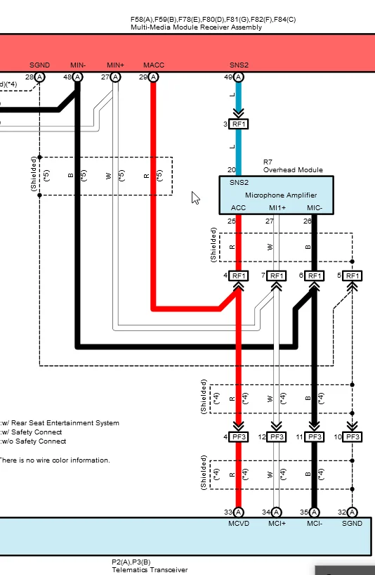

So there may be some hope for using the factory microphone:
I'm not sure if this would be compatible with some or all of our Land Cruisers (depending on model year, of course), but this would be pretty much a plug and play solution:

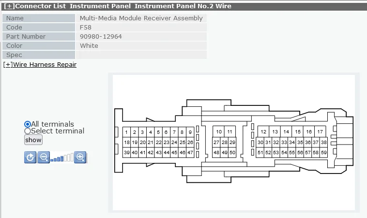

I just spent a few minutes poking around in the electrical diagram for where the required connections for the microphone exist on our Land Cruisers. It looks like the microphone connections that are needed are on the big cam lock connector, which I see as a bit unfortunate as it's probably the most difficult connector to work with (and I can't find a male to female jumper cable similar to what is used in the above solutions). The diagram shows the SGND, MIN-, MIN+, and MACC connections going to pins 28, 48, 27, and 29 on connector A, which maps to connector F58, which is the big connector. It looks like these connections are identical on 2016-2021.
