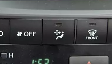

I hope so regarding the windshield de-icer. What the heck does the cabin filter button do? I'm hoping that ALL of the original HVAC controls are accessible after the swap. I'm sure I could live without a few of them, but each person will obviously have different priorities.
The button temporarily forces the HVAC unit to push all air through the charcoal filter. I use it whenever we drive by a cattle farm or a coal-fired powerplant... or whenever my kids fart in the backseat. It really works.

Here's an explanation of the button. From a different Lexus, but assume it does the same across the board:
The Lexus IS 250’s button activates a climate system mode that takes advantage of the car’s micro dust and pollen filter, commonly called a cabin air filter. These types of particulate air filters — which do not look like a jar of cotton balls in real life, by the way — help remove dust, allergens, pollutants and reduce odor in the vehicle when systems suck in air from the outside to blow inside through the heating and ventilation system vents. It’s a separate air filter from the engine’s air filter and commonly located in the glove box area or under the hood near the passenger compartment.
Two things happen when the button inside the Lexus is pressed. First, the climate control’s recirculation mode is triggered, and cabin air is exclusively routed through the cabin filter instead of taking air from the outside. At the same time, the air vent mode is switched to the upper vents to deliver the freshly filtered air up occupants’ nostrils.
It’s pretty much a one-touch button to get as much fresh air to the face region as possible, and having one button that does the same thing as hitting two or more is always nice but not a necessity. The mode turns off automatically after about one to three minutes. (This button is found in other Lexus models including the CT200h, IS 350 and GS 350.)
Cool. Not sure if my 2020 has that feature. I’ll need to take inventory of all the HVAC features before I do the install 😀.

Anyone know if this version (or any) support the front windshield de-icer and if it has a digital equivalent of the cabin filter button?
I verified my defrost vents blow air when I select that on the screen. I didn't play with the air recirc "soft button" and verify the air filter thingy moves. I'll check that later today. Good thought. (BTW my LC 2013 though, so this isn't the right thread).
Edit: went back and reread, @linuxgod is the "cabin air filter button" some different than the air recirc button? I just go to recirc which stops outside air and diverts inside air through the cabin filter. For kid farts, all windows down is my SOP.
I'm not sure the official term, but it's the button with the picture of the guy sitting down whose face is about to smash into a brick wall which was just pierced by an arrow :hillbilly: (not just the recirc/fresh button)
