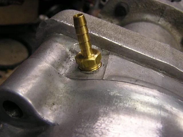

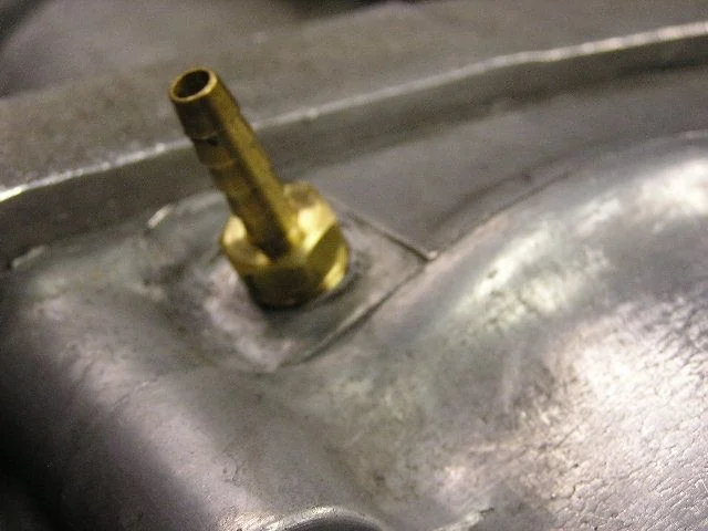

Here are some pics of my t-case with he breather installed. I am swapping out my Turbo 400/splitcase combo for a 700R4/splitcase combo. I am looking forward to having an overdrive (my wallet will thank me).
I used an elbow with pipe thread and hose barb. I ran the extension up to my firewall. I capped the end with an exhaust muffler I got from mcmaster-carr. I've just got it tied off to other tubes on the firewall for now, but eventually I'm going to bring all my breather tubes up there to a common breather header.
