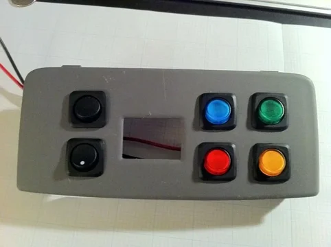

Yes it's doable :D
Here is a shot out of the truck... i'm working on the wiring. This is really a protoype - I have been speaking with Jon at GuagePlates on a custom panel.

If it's just control wire (no power) then I'd think 16ga would be fine. I'd route it down one of the a-pillars. There's plenty of room under the roof liner and behind the pillar wrap.
And then probably use one of ese relay blocks to control the devices. Again, installed them in another vehicle and it's top quality stuff. Gaugeplates.com, your home for custom gauge and switch plates
