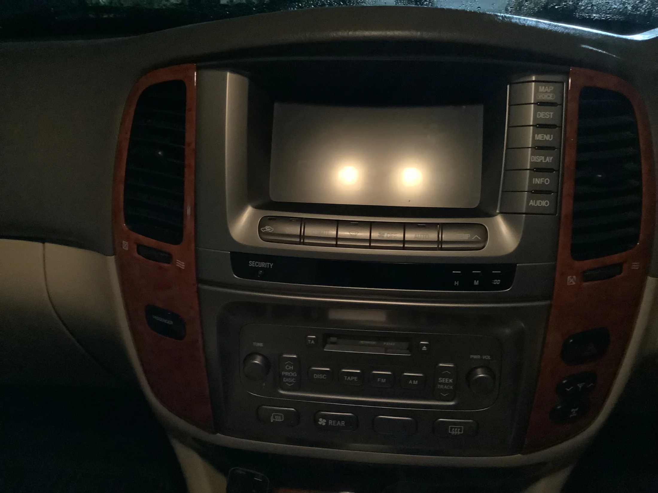

My screen has gone blank. Fuses ok but nothing on the screen blank
Any tips and advice and which replacement is the best as I still want all the original controls as well
Mine is a Uk spec. 2004 100 series
What causes the screen to go blank ?
If you still have some functions - radio still works, etc., Then it may be a cold solder joint I've heard is a problem. The screen going blank happened to my 04 LC so I sent it in for repair. They didn't tell me what was wrong with mine but it's been re-installed and working.

By using the buttons I can operate the radio and cd player, rear blower. But without the screen you can’t control the AV , fan speed , temperature etc not to mention the obvious,…… to use the reversing camera
I’m going to pull it out and see if any power is going to screen first . Then remove all plugs and reattach with the batteries disconnected. Then hook everyone back up and see what happens

You could probably locate a replacement screen for your OEM unit. When i replaced my screen I had to disassemble the unit to be able to get the exact model number for the screen so the replacement screen would be compatible. The screen is more than likely manufactured by Toshiba
Thanks for that. I never realised how much stuff was inbedded in the original screen
