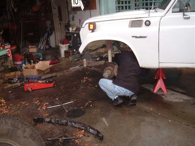

"Pighead!, this is SurfPig! I'm getting off work early today! How 'bout I come over and we put those front springs on? It's not raining"...I look at the sky, I look at the phone..."Who's calling?" I said...

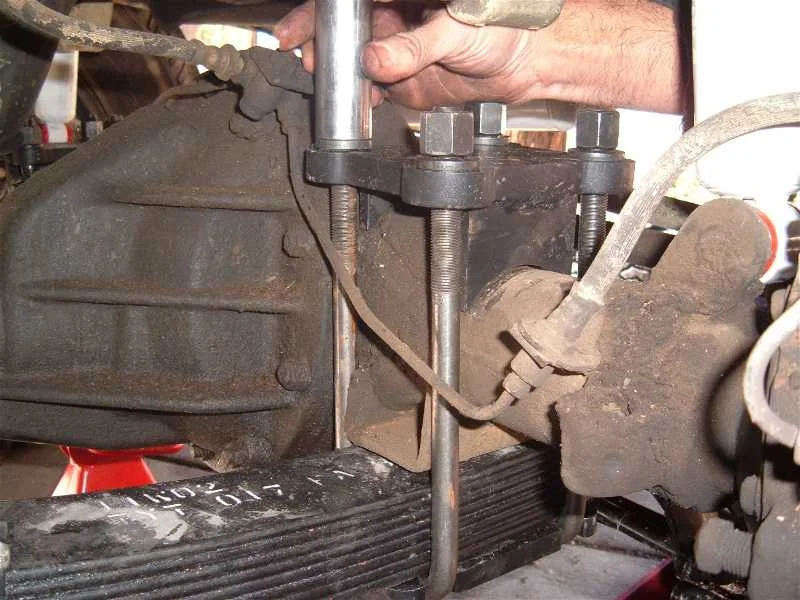

But SurfPig pulls up in my (poor excuse for a) driveway, with all his spring stuff and some beer and we get to work. Then it starts raining. We've got jackstands aplenty and two sets of tools, we get things unbolted pretty quick. But that driver side springpin musta took us an hour to pull out. And we had every big tool we owned spread out under his Pig; 2 pickle forks, my 4 foot prybar, couple of sledges, chisels, everything but the 12 gauge. And we are really getting wet. It's cold, too.

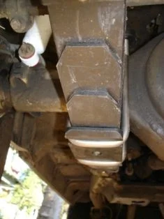

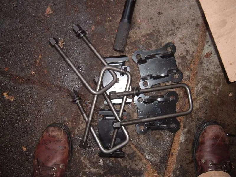

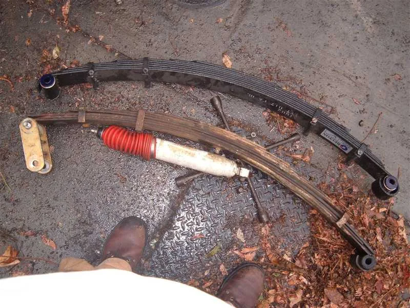

Finally get the old spring off, new Dakar goes on pretty easy. Then we notice that the U-bolt flip-kit is not going to fit with the old bump-stop snubber there where the factory put it..."I'm all out of cut-off wheels" I sez to SurfPig "used the last one trimming fenders after the Pigrun" ..."Aargh!" sez SurfPig..."Let's just put it back together enough so I can drive home" "(Whew)" I say quietly to myself. I was really wet and really cold, SurfPig was wetter and colder. It being my garage, I was able to change outa my wet clothes once or twice. SurfPig was literally dripping wet. But we had one of his new Dakars on the driver side secure with stock U-bolts.
"Maybe this weekend we can finish it up..." he says brightly.
So, he's coming back over in a couple hours, it's not raining, yet, we just might get it done.

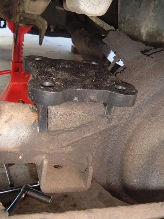

Thanks, Pighead, I had blocked the whole incident out... I took out the angle grinder Wednesday night and fixed things, after emailing back and forth with Steve-O from Man-a-Fre, FJ55 axle is a leetle different from a 40. Today is sunny (no pea soup fog today!) no hypothermia... might even be enjoyable, somewhat.

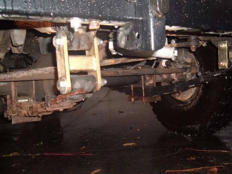

Oh, they're "Offroad Australia" springs, made by Belton, same manufacturers of the Dakars. FJ Fitty-Five specific.

I was just about to ask if they were really Dakars or what?!
So is this a 2" or 3" kit? Looks fairly complete. What are your thoughts about the quality/construction? Looks good to me from the pics. Always glad to see pig specific stuff-thanks for sharing. Did you order from OZ directly or a U.S. rep?
That reminds me, I have to go pull an engine from my buddy's rolled 40, ASAP, it is sitting in his driveway under about a foot of snow. ARRGHH!
About 2 1/2", they say, I can go 3 if I put the extended shackles back on. Got them from Prarie Dog Parts in Alberta, hand-delivered at Rubithon this past June. Very nice, as far as I can tell.

Learned how to make a two-arm puller into a two-arm pusher and had that spring-pin out in 30 minutes. Half the time it took for us to do it sober!!!
Bolted that Belton up before noon. Passenger side U-bolt flip worked fine.
