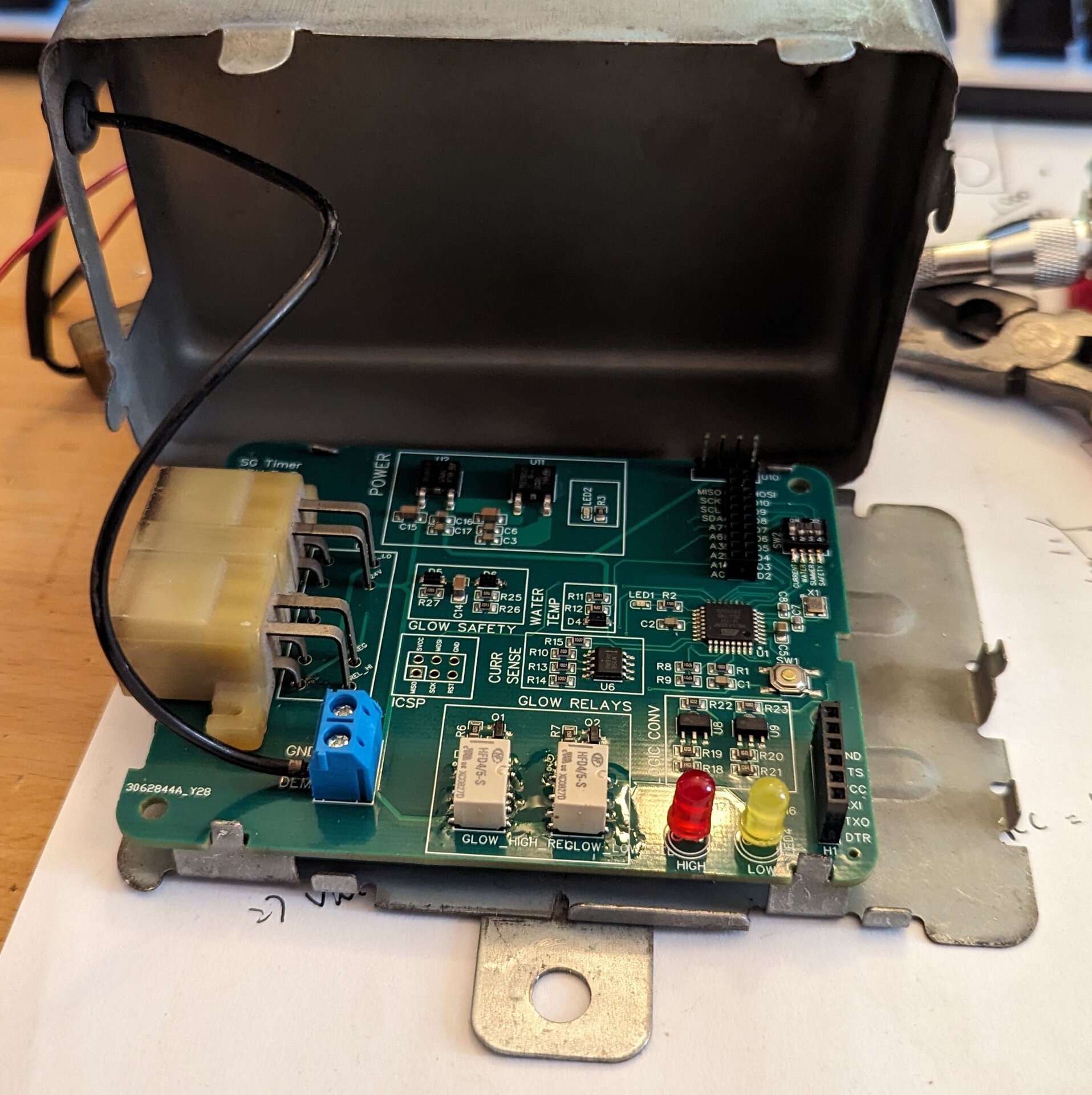

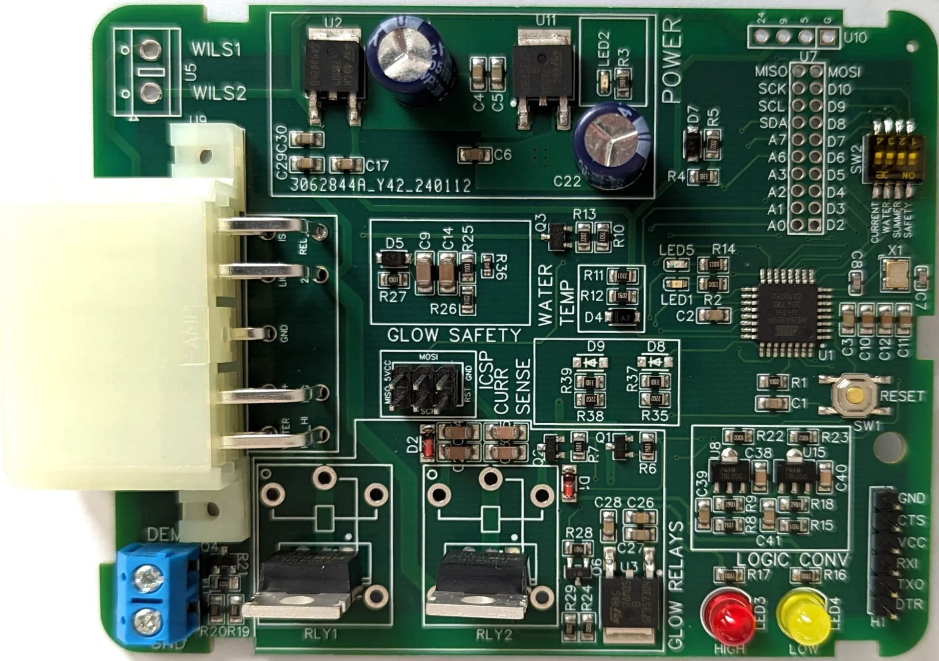

After enduring too much trouble with my original superglow timer which frequently did not operate correctly I decided to use my electrical engineering knowledge to make a timer replacement.
This board is based on an ATMEGA328P for the logic part.
Current features support:
- Water temperature measurement -> glow duration adaptation
- No operation if engine has already started when board is powered on
- High glow stop after engine start
- Glow stop during starter use & resume afterwards
- Glow current sensing (Though I have to further test this one)
- High glow safety timer (To prevent multiple consecutive uses of high glow)
I also added a switch box where I can select If I want to use the current sensing/water temperature/glow safety and I can also select between two different glow duration maximums.
The board is completely plug and play with the original box, I will probably drill two small holes on the side so that I am able to see the leds.
I am wondering if anyone would be interested in having one. This one was made for a 24V BJ42 but it should operate correctly with other types of superglow, including 12V (I should just check&adapt the resistance/temperature/timing curves).
I currently have enough components to make 4 other boards (I could not order less boards from the pcb manufacturer) but If there is any demand I would gladly order more.

As you have noticed the connector on my picture is the one coming from the old stock timer.
The good news is I managed to source the original connector (171894-1 is the reference) thanks to a lot of research on specialized websites.
So I would be able to manufacture a board with a connector. In my opinion this is the only reasonnable option because except if you are equipped with a hot air rework station you will never be able to unsolder the connector from your original board.
Speaking about price I think that would be around 70€.
I should warn any enthusiasts that I am still testing this though. While I am really confident on the basic opération (water temperature) there remains some uncertainty on more advanced features and that is why I put a switch box on the board so that individual functions can be disabled.

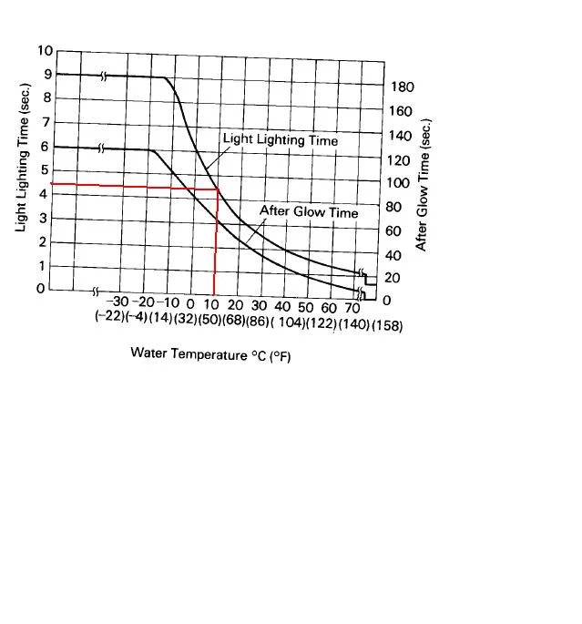

Actually I would have little use of the board itself, especially if it is not in working condition. To adapt the board to the 12v system I would rather use the timer manual with the temperature curves if you happen to have it.

After my last tests I made a 3rd version of my superglow electronic replacement.
I fixed all identified hardware bugs and made global improvements (stability, power supply variations,...). I added a wilson switch port that does not need the board to be functional in order to work.
I also made sure that it would be compatible with 12v systems without any tweak.
This v3 has been tested in cold conditions and works like a charm ! (BJ42, 24V 3B engine)
I sourced the original pcb connector so I am able to make a plug & play replacement board that will work with the original wiring loom connector.
I will order a new batch of boards shortly, if you are interested please reply here or send me a private message.
Feel free to ask anything !

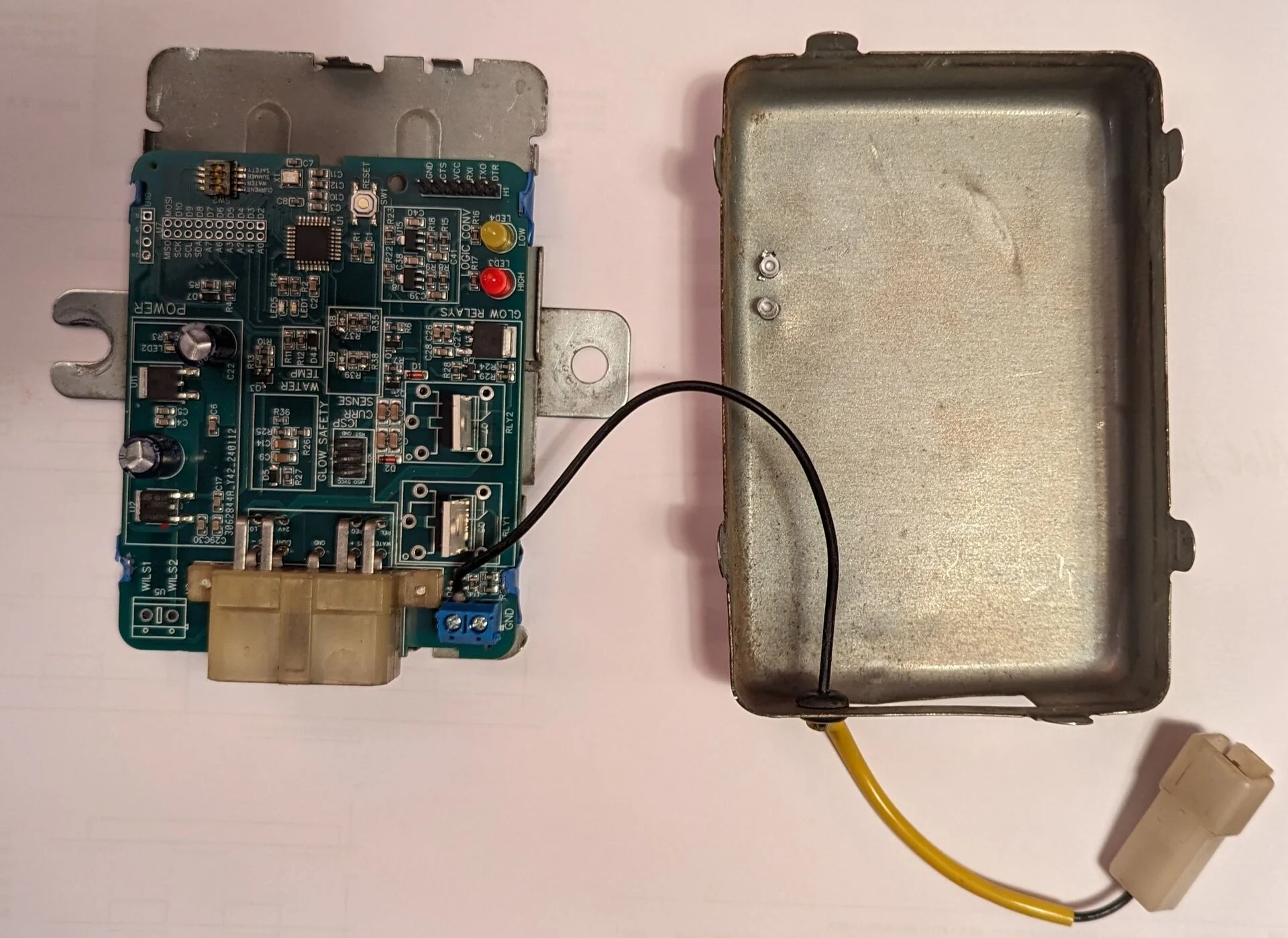

After deep testing on bench and in car I can proudly say that my electronic superglow works great !
Here is a picture of the final board inside the timing box:
The card in detail:
I switched to transistors for increased robustness. I also added a bunch of improvements including a monitoring system to warn you in case malfunction is detected: short circuit (leading to unwanted glow) / input voltage too low / water temperature sensor KO /...
I will later on make a complete post about the design, testing and functionalities of the system but if you are interested here is a user manual I just made.
