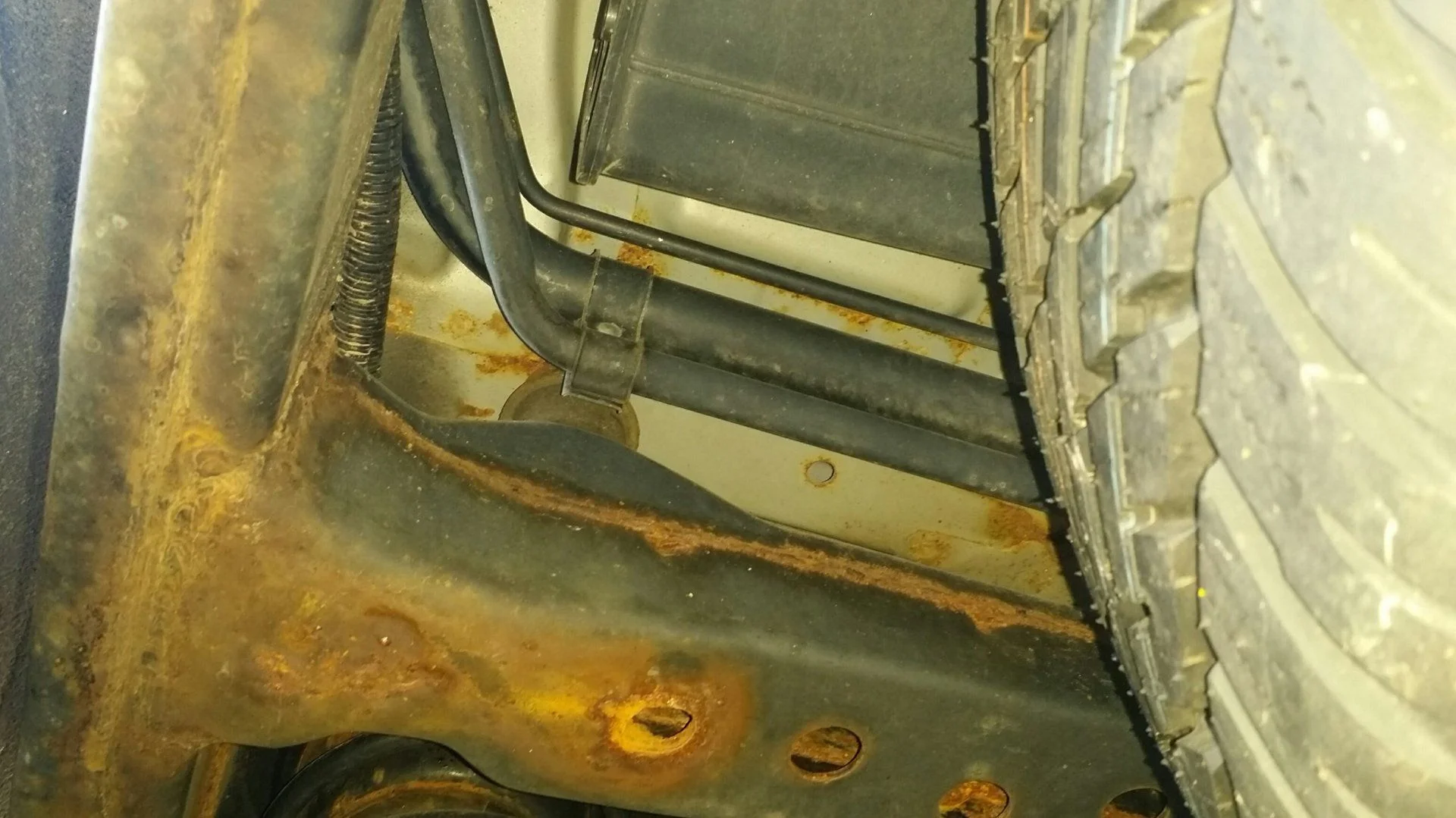

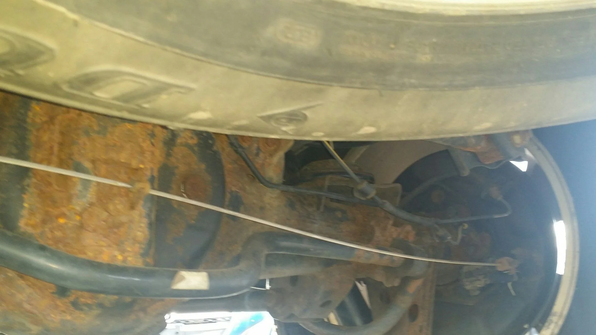

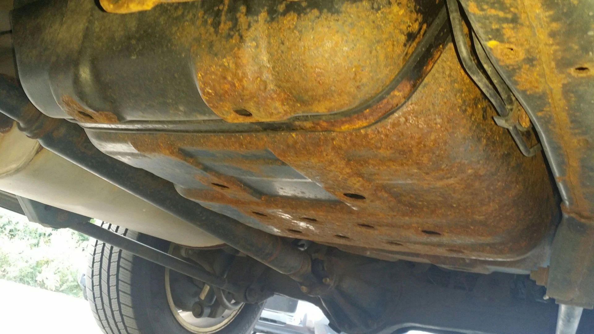

I'm still waiting on underbody pics on both to see what rust if any lurks underneath both as you all have taught me rust is likely the biggest killers of LCs!

I'd pass, that's just what you can see!
where in NJ..personally pass "F" any kind of rust it'll just make you miserable
i'm probably sure of where to look for rust on the body..look under the rear bumper corners all bottom of doors and if i'd do it again..spend the $$ for an out west truck you can prevent rust not stop it!
Pass. And next time I’d take the clean older one with good service history. Maintained these will last forever. Not maintained.... they won’t.
