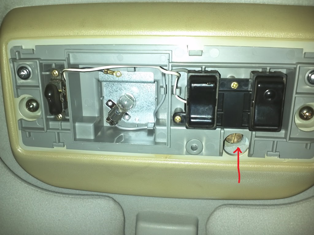

Haven't done it myself but here's a photo FWIW:
Thx, I cranked a little on where you indicated but with only less than a quarter turn each way. I'm going to have to go deeper me thinks.
