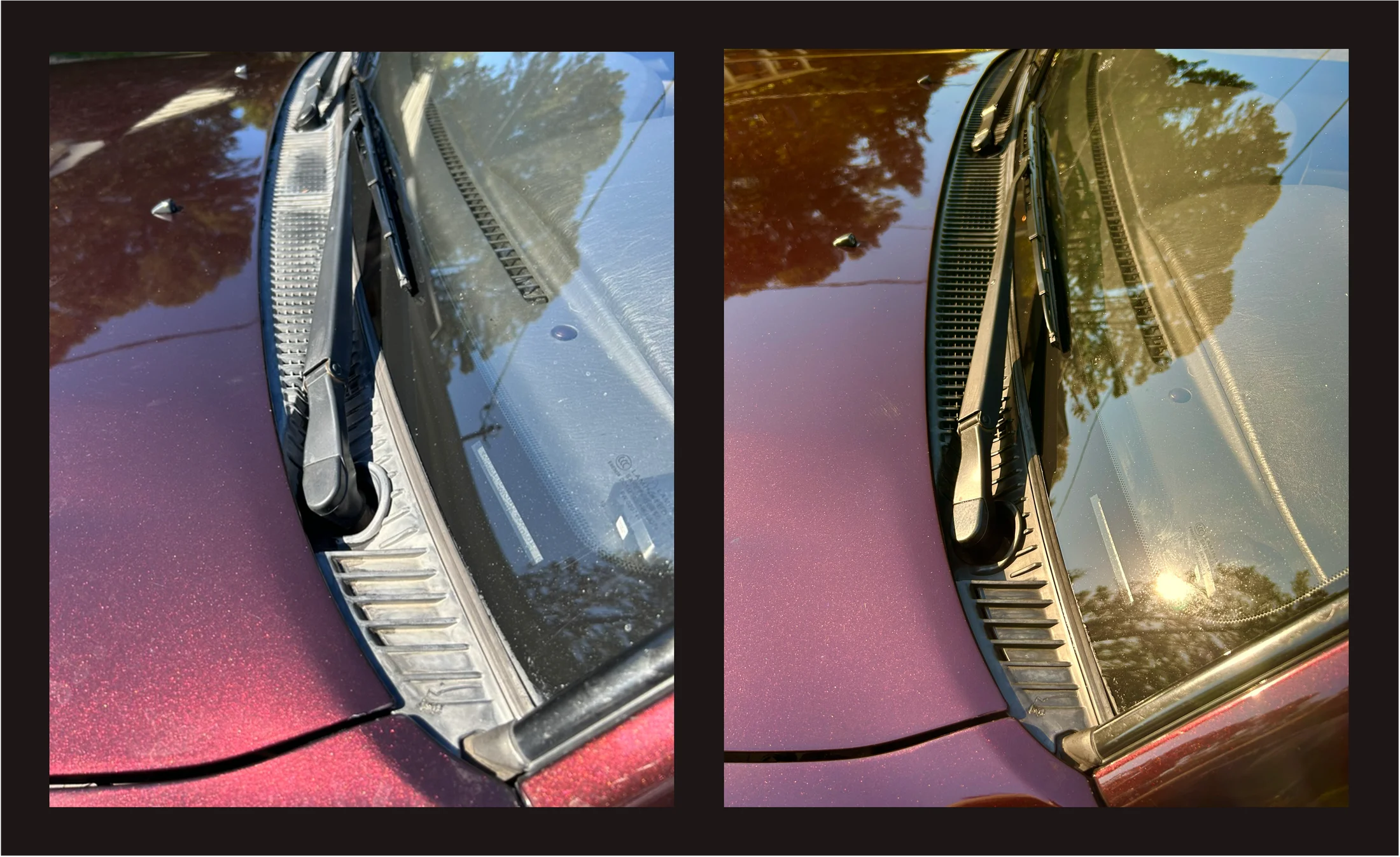

@2000UZJ - supposedly the heat gun technique only works for a short period, and the more it's done, the shorter that period. What's your experience been?
@Manhattan - I did mine roughly a year ago, and it still looks the same. Given, my truck is garaged 100% of the time, except when we run errands. I'm not sure I'm fair judgement on durability, but I'll look back and the pictures I took after I did it, and go compare. I don't *think* it's changed, but I may be wrong.
Heat gun will work for a while, but if the truck isn't garaged UV will break it down again. A heat gun application then regular treatments of 303 may be a good combo but haven't tried that.

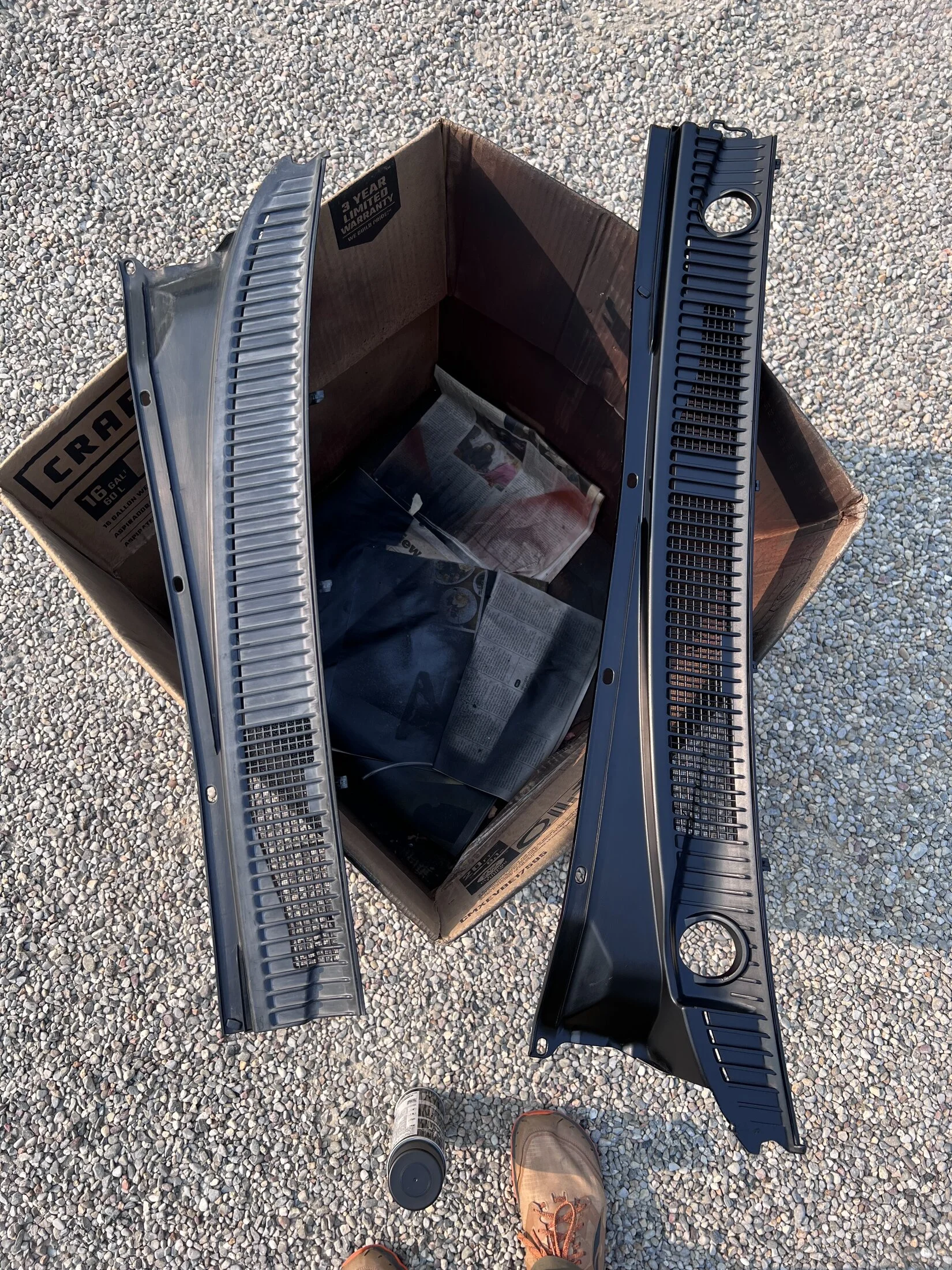

Mine has been in Texas most of its life. I had the same issue so decided to paint it using the sem black trim ultra. Worked out great for me. It’s been 2 years and don’t see any peeling or degradation yet. - Hit them lightly with a scotch pad cleaned them with soap and water dried them hit it with some degreaser two or three coats following instructions. I believe one can was enough and I’m happy. Also used the same paint for the trim around the windows.
Those turned out great! I used that around my windows as well....no idea why I didn't think to use it on the old cowls. Nice work!
I do love me some SEM plastic paint! I've restored (sounds better than "rattle canned") a bunch of interior panels in my '84 Pickup - they look great. But I'd written off the idea for that cowl - assuming the gallons of petroleum-based crap I've slathered on over the years, would keep the paint from adhering. I may give it a shot!

I used a heat gun on my cowl a few months ago. I was shocked at how well it turned out. It looks great. That said, I park in the garage and can’t speak for longevity.
