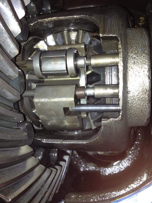

Installing an Aussie locker back here and ran into an issue. Since I've never had the diff apart on this truck before this is new to me. I got the pinion shaft to slide out, but I can't get the thrust/spacer block out to get to the c clips. What the heck am I missing??

These aren't limited slip parts are they?
Whoa. That does not look OEM. What the heck is that I wonder
I wish I knew! Those two photos are the different sides of the same diff.

Someone has been back there for sure. The "housing" around all that stuff is odd looking. One of these guys will know what that is I bet.
Yeah, my carrier does NOT look like that. Ugh. This was supposed to be simple :mad:
Doesn't look like even an OEM carrier, the block is wrong too. Is it some kind of limited slip carrier replacement? Here's OEM.

I haven't tested it quite like you suggested, but it acts like an open diff. Tires spin opposite.
I'm not going to take it apart any further unless I get some good direction because at this point I can still put it back together and drive to work on Monday.
That does not look like a Toyota part. Any chance someone swapped in some GM gear? That almost looks like the infamous "gov-lock" also called the "gov-bomb" due to it's tendency to....well you know.

You already have a locker! (Edit: You have a gov-lock LSD Limited slip Diff - the clutches are probably shot it is made by Eaton)

How can you tell? If it is, it does NOT work. Nothing appears to be broken in there.

Good decision. Front may take more work/time to ID since you cannot just pop the diff cover to look at it. You might try a bore scope thru the fill plug to see what it looks like in there. Blue gasket sealer is a clue that the rear has been opened/worked on? before. LS units usually operate as a normal open unit until there is a predetermined about of difference in rpm between left and right sides. Then it activates a clutch pack to bring each side to equal speeds. You will need a carrier housing, pinion shaft, C clips, and maybe side gear shims. You will have to transfer this ring gear to the new OEM carrier and then reset ring and pinion adjustments to acquire proper tooth contact patterns. This can be challenging with a non matching ring and pinion gear that both have unknown amounts of wear on them.
