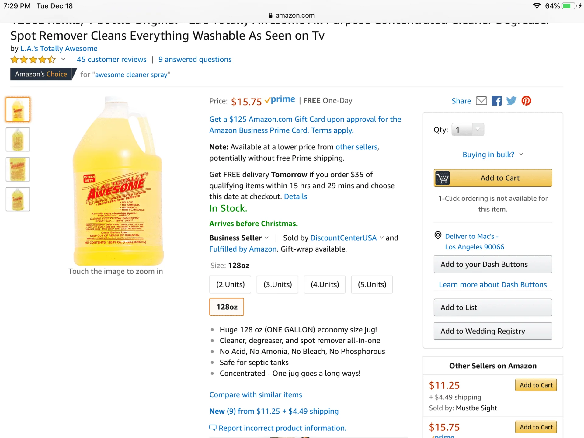

Try this, I used it and I’m totally impressed cleaned up my engine compartment, removed all grease and contaminants. I like it much better than simple green.
Try this, I used it and I’m totally impressed cleaned up my engine compartment, removed all grease and contaminants. I like it much better than simple green.View attachment 1858117
yeah that stuff works wonders in a carpet shampoo'r. Never tried it for degreasing anything as I have found that the ghetto looking purple bottle of "Super Clean" does a pretty impressive job. Wish it would foam up a little better in the foam cannon on my pressure washer but regardless still works great. The foaming tire cleaner is stupid awesome... and doesn't give the tires that plasticy funky look.
