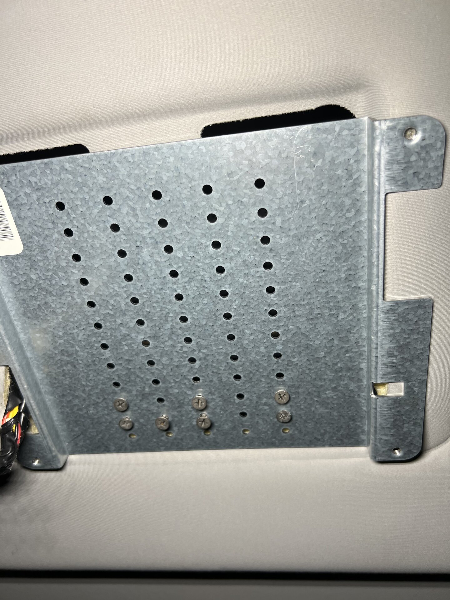

So mystery kinda solved. I dropped the overhead DVD player and found this:
The backet is missing the original 4 screws, instead wood screws are holding it in place.

I ripped the wires out (coincidently I've been searching for this annoying rattle in the ceiling for months) and put everything back together. I still have no idea what this thing does.

My guy says this was some half-assed hack to replace the DVD player with something aftermarket. When the PO sold they removed that and put the original back in.
That wiring is such an awful job tapping the original wire that I can’t tell if it’s rodent damage or a 4 year old shredding wires trying to splice something. I’m wondering if there were other taps that got removed. It does look like mouse carnage tho
I think that's exactly what happened but they took out the OEM one and left the aftermarket in. I've never realized it wasn't the OEM player, it's an Advent and looks nothing like the pictures of the OEM player I just found online.
Only took me 5 years of owning this truck to notice this lol
Interesting, if you are missing the OEM system, then they must have bypassed it to keep the rest of your audio system working. It would probably take 2 pairs wires being removed from a plug and tied together to accomplish that (there is a comms bus that has to be "jumpered" past). Might be good info for people looking to bypass failed systems. Also, probably good for you to pay attention to, because you may find your head unit inoperable if you disconnect whatever bypass is in place. I think it might also be likely that it's in it's own plug, so you might look to see if there is another plug shoved up in the roof cavity.
