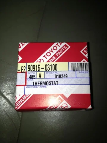

Thank you for all the assistance. 17 bucks from Toyota and a 4 dollar gasket. Time to get dirty.
The thermostat fixed the issue. Back to the same as before, temp gauge needle sits at 35%, no matter what.
30 minutes to change out. Pretty straight forward. The coolant makes a mess but besides that, very easy to do.

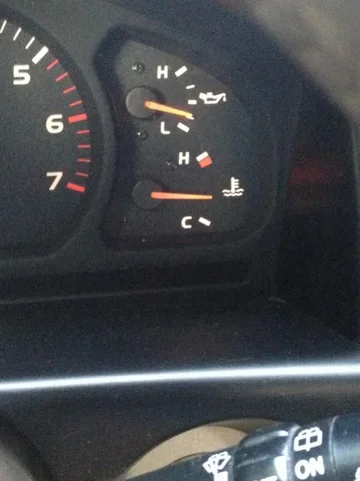

That's a testament to Toyota thermostats, and good maintenance. But your temp gauge is odd, should center. You may want to check your sending unit
It has been sitting at this current position since I purchased it with 100k miles. I will post a picture.
Gauge
That looks good to me, just below center. My gauge on a 100 deg day with air on full, will rise just above center. Apparently the actual temp swing is much greater but within acceptable range. I guess Toyota didn't want consumers alarmed by the wider swing.
