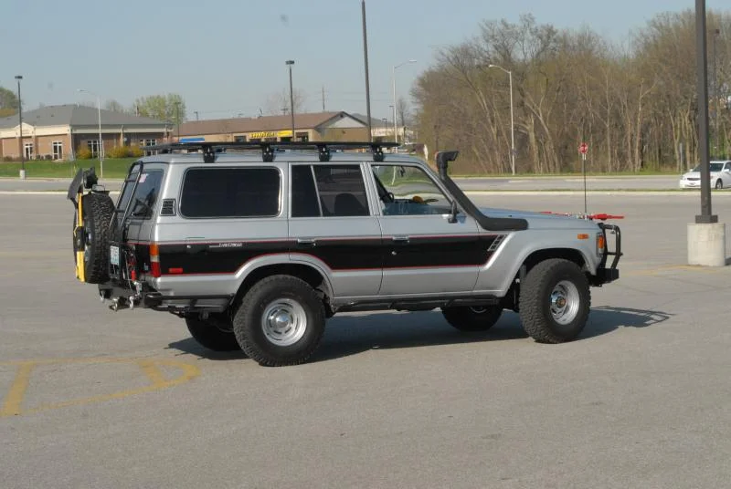

Not 16's, but I had Stockton widen my OEM 15x5.5 to 15x8 with the correct backspacing. I really enjoy the way the look and ride.
More info around post #95: https://forum.ih8mud.com/60-series-wagons/292104-summer-beautification-arb-style-5.html
Good luck.
They look great!
