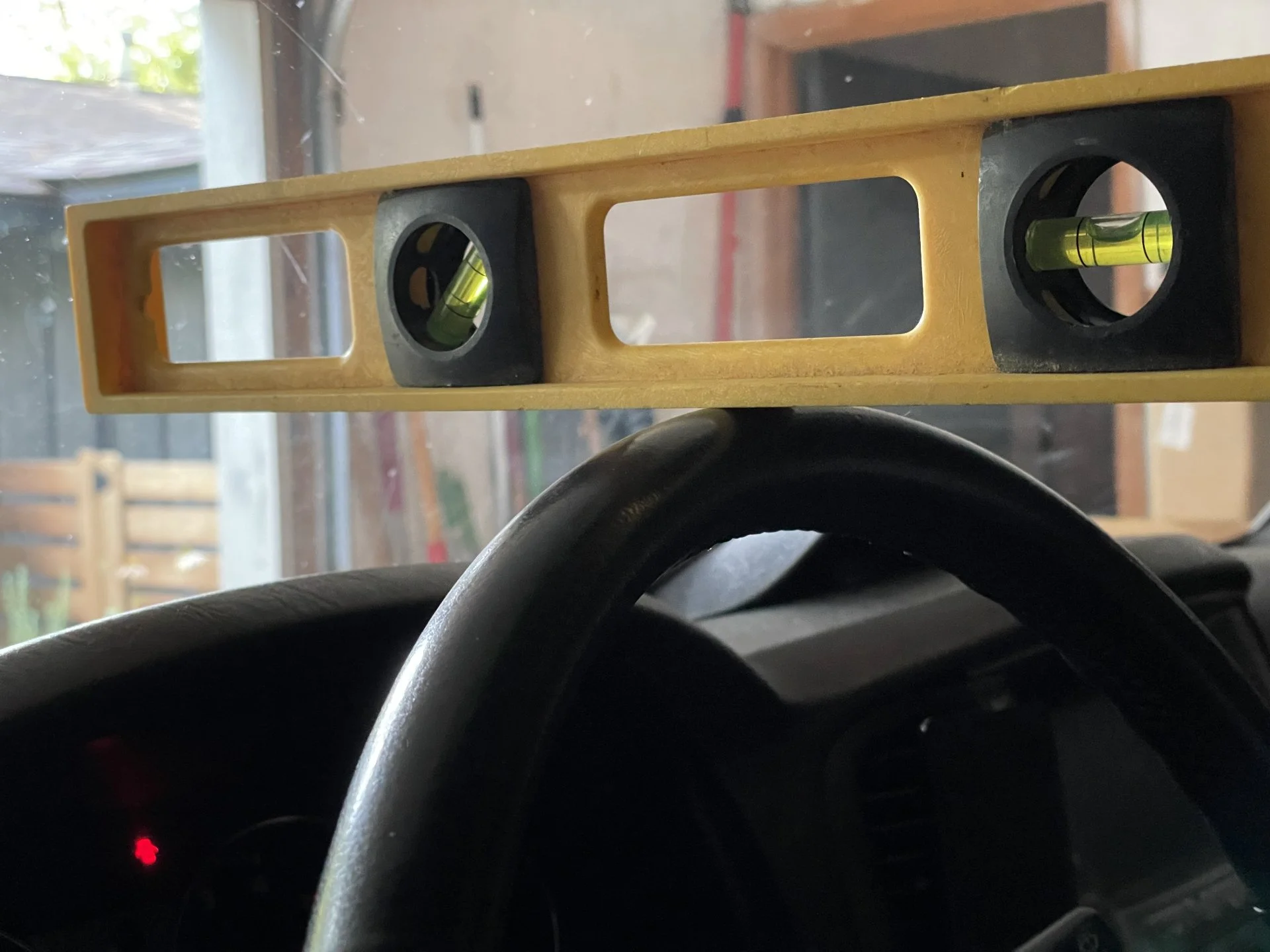

How low does your steering wheel go down? I’ve searched on mud but can’t seem to find an answer to this. I like having mine in the lowest position as to not impede my view. Last year, I had the dealership disable the auto tilt/telescope feature because the telescope motor was starting to act it’s age (2004 LC). The tilt still works fine, but never felt it’s quite low enough for me. This pic, with level, shows I’m a few inches from instrument cluster at lowest position. Thanks for any replies.

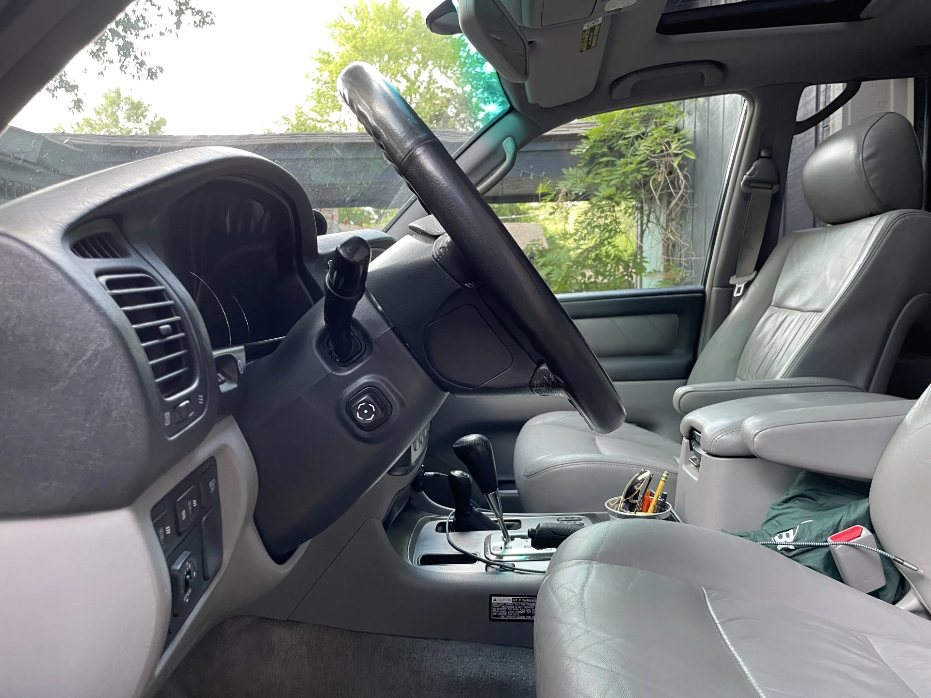

What visually appears “a whole lot more than that”…
From my perspective, from the driver’s seat, the rim of the wheel is slightly below the top of the dash.
Yours does seem lower. Strange because my tilt motor seems to works fine (full range), I wonder if it can be calibrated/reindexed? I don’t have tech stream, had the dealer turn feature off last year. Do you think there are settings for tilt range?

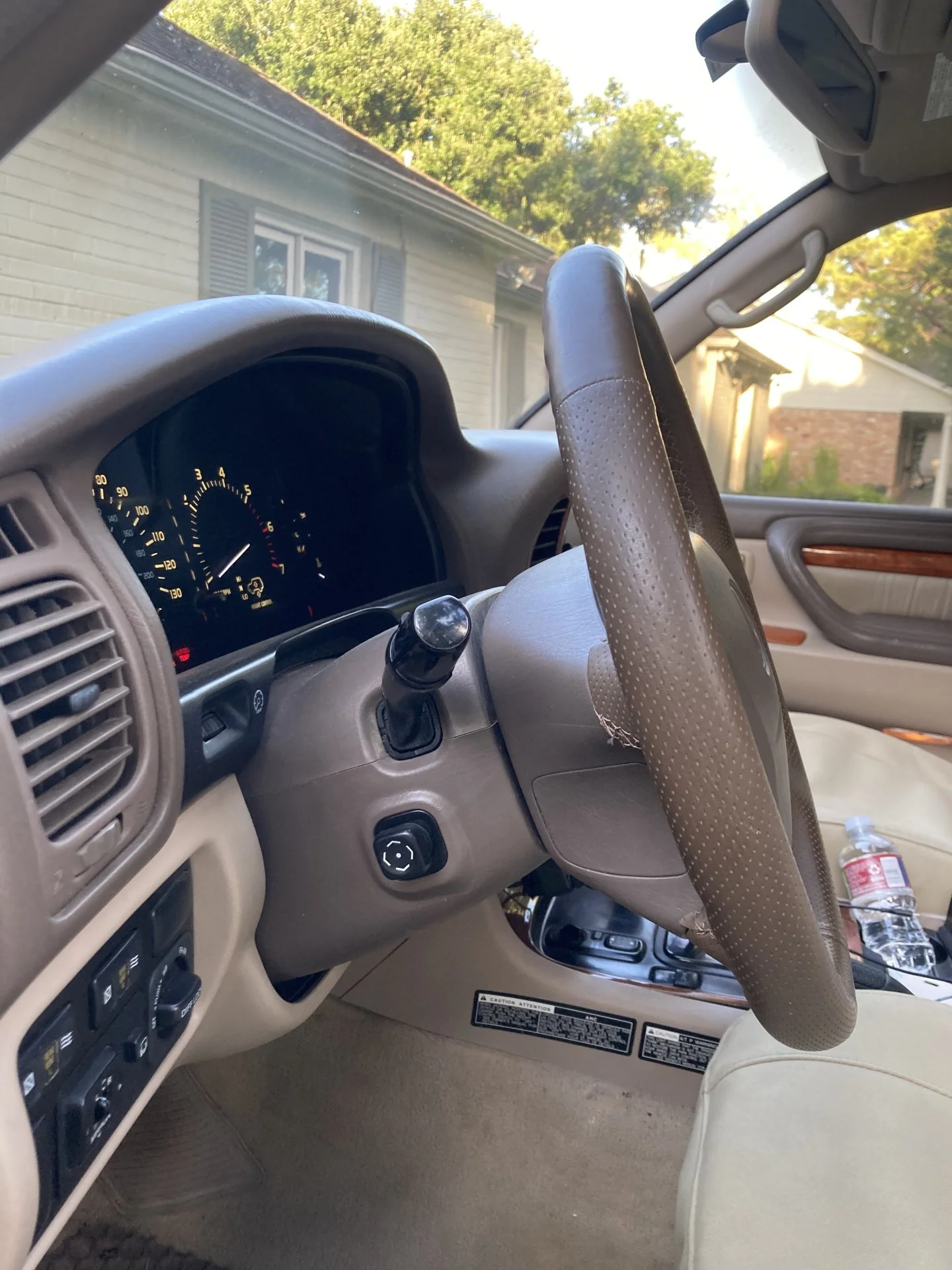

While I do have Techstream, I’ve never really looked into it. At my son’s (5” shorter, and 50 lb lighter) preferred setting, it makes it difficult (for me) to get in, and blocks my view of the gauge cluster, but at my preferred setting, I have no issues.
If you repeatedly pull the lever down 6-7 times, it’ll go a bit further. Same with in/out.

@hoser That worked, wow. How did you even find that out? It’s not in the manual. Thanks, appreciate it!

Isn't it 10 times within 5 sec? It will then move until it physically stops. (Normally less than a 1/4 inch). Also works on seat position.

Did you steering wheel go down as far as JLB's? Because his seems normal.
Yes, pretty close — thanks again for the tip. I bet it’s not mentioned anywhere else on this forum.
