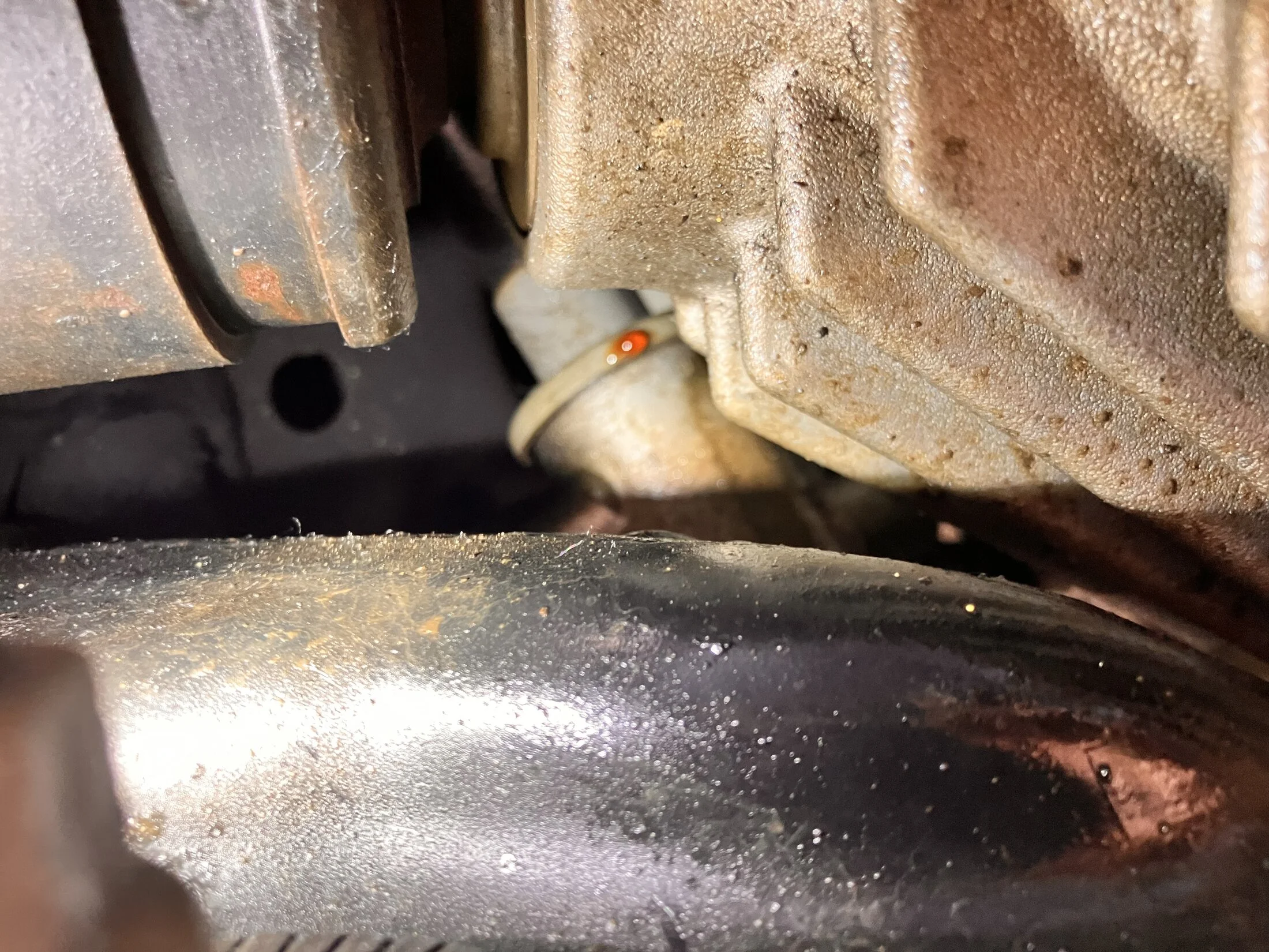

Just saw this, where the steering wheel shaft enters the pump:
Well, at least now I know which direction I have to go…$$$
Great…
