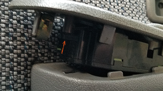

This is a long shot, but I need a screw that holds in the window master control unit. I am probably going to have to make a junkyard run for this one. If anyone knows where I can snag one online let me know. Thanks!
Don't you have local store that sells a range of building and automotive nuts bolts etc? Any Japanese or European vehicle will have them.
You could probably steal one out of the dash or somewhere else in the interior for the time being.
Yeah I don't know what I was thinking. I can remove that whole piece and take it into the hardware store. Wasnt thinking straight last night!
