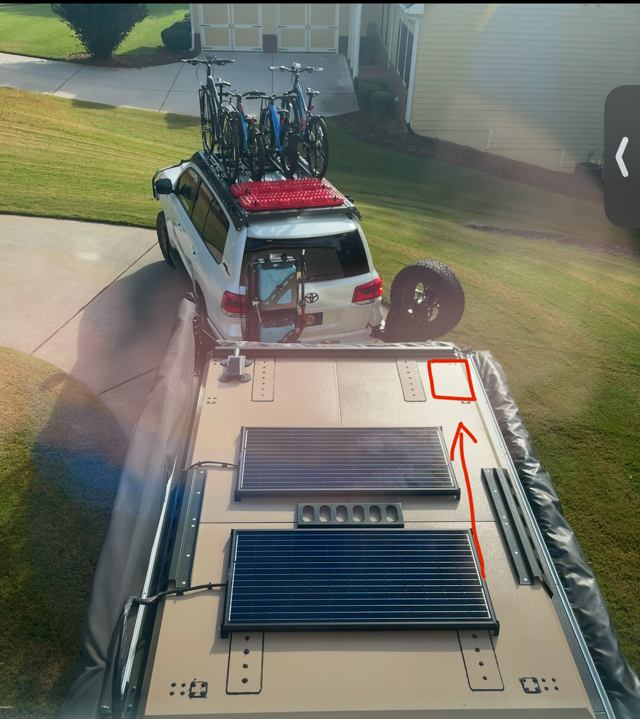

Bulky but definitely not going anywhere. I may be looking for a unicorn setup, idk. I wonder what my reception would be if this is mounted on my camper and I’m driving? I would be about 15 feet away inside my cruiser.
Out west, roof mount is fine because it’s so wide open, here in the south east I might need to move this around on the ground for signal if I need it at camp.

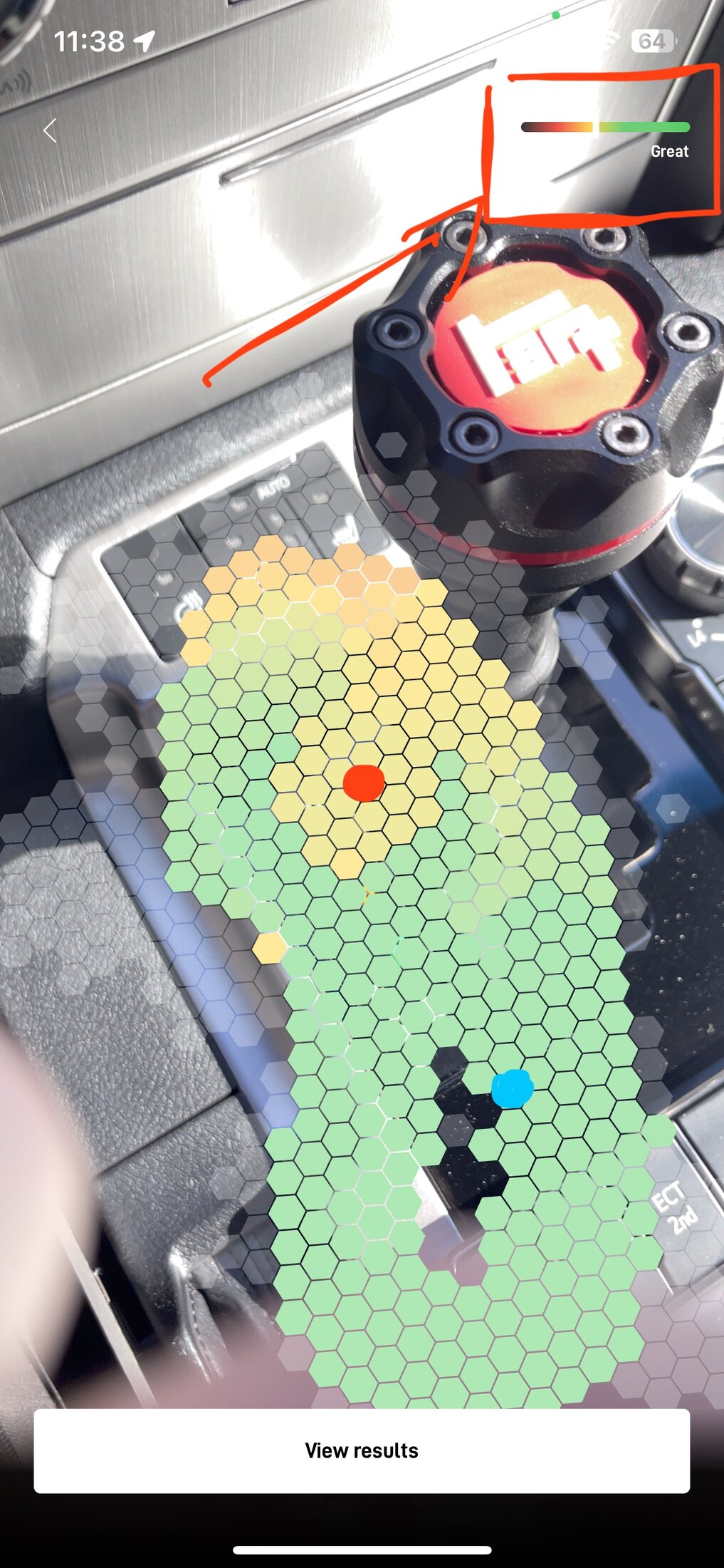

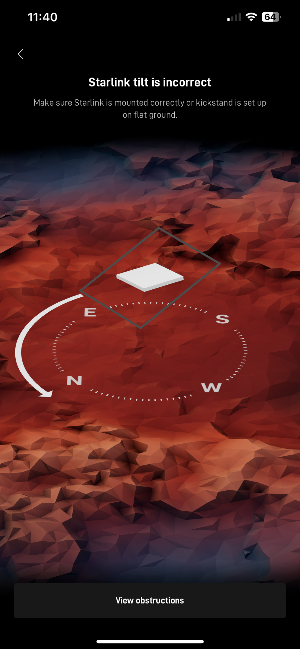

Roof mount test was a mag mount on top of my camper. Dish to drivers seat is about 20 feet (pic 1). Speeds at drivers seat fluctuated between 20-50mbps. Signal strength to dish is shown in pic 2, red dot is me in drivers seat, Blue dot is dish. Check red square for signal strength graph, I’m in the middle of that graph while sitting inside. A roof mount on the Cruiser would be solid near 100% of signal strength and should produce similar performance as I found sitting inside camper, speeds constantly approaching 100mbps.

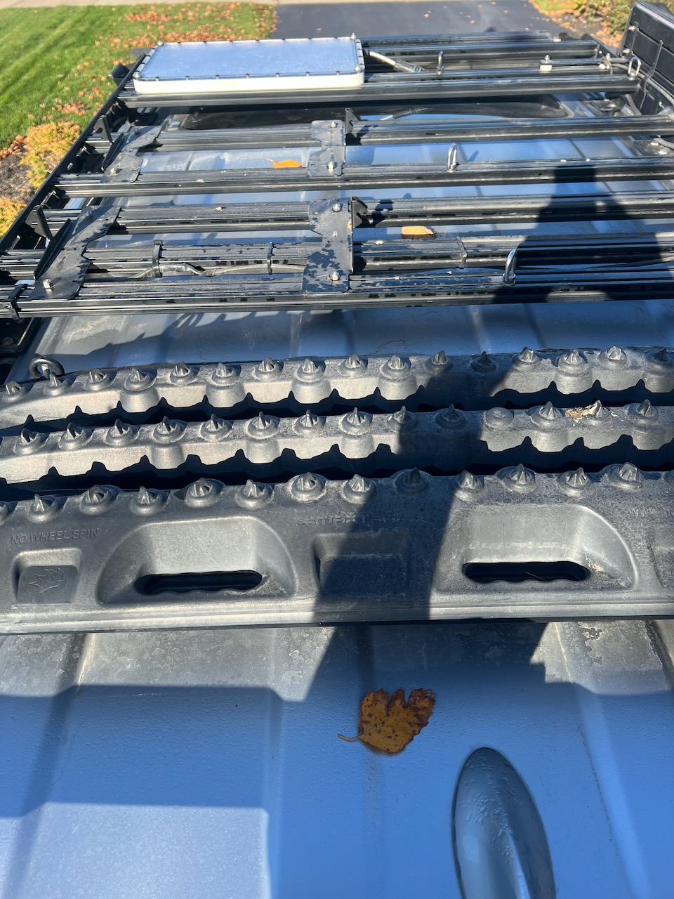

Orientation of the dish (pic 3) was crap for these test. I did this to see what poor orientation would produce as I imagine most driving conditions would result in less than ideal orientation.

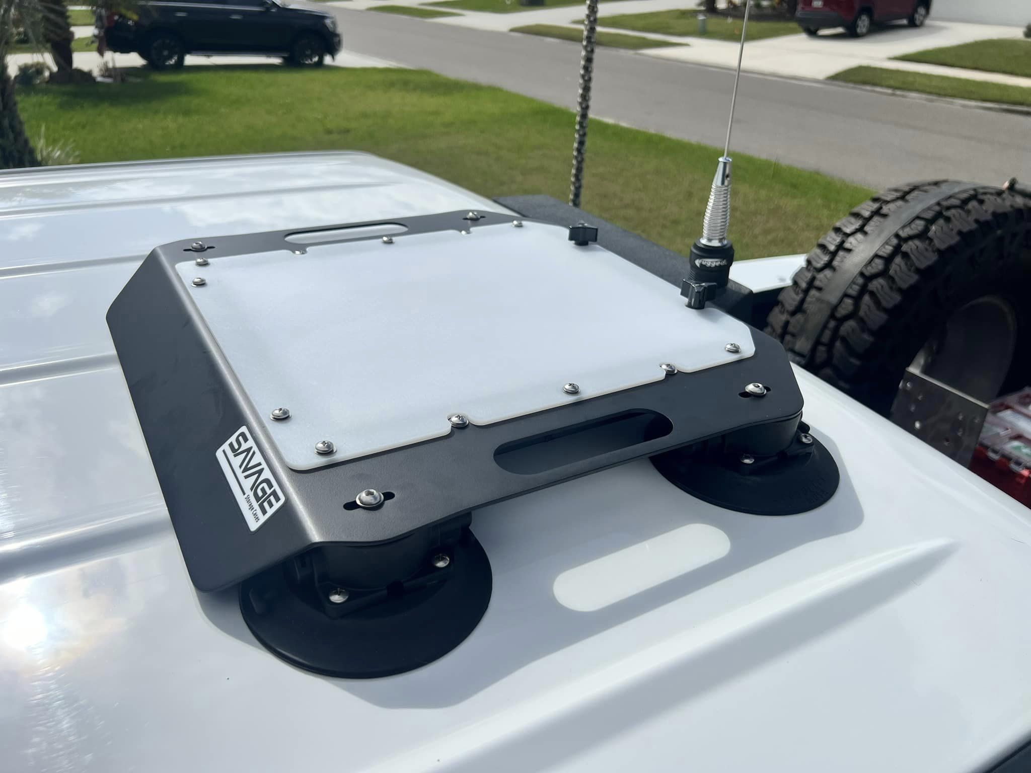

These initial tests exceed my needs. My main use case is maps, weather radar, and messaging while driving remotely where little to no signal exists. I am typically towing my camper in these situations so this is why I’m mounted there. The nice thing about the mini is moving to the cruiser when needed is easy with the mount that I have. Here is the mount that I am using, it is low profile yet robust. It’s also 3D printed which seems to keep popping up more and more, another reason to consider one for projects like this…like a need a reason to buy more tools but for some reason I’ve been reluctant to jump on this bandwagon…. I digress.

Starlight DC power cord is an 18g conductor with ground run as a shield on outside (also twists up to about 18g equivalent. I cut the length down to 43 inches and installed a Delphi DT connector on end to connect into my preexisting 14g 13 amp roof power supply. Created a 14g Delphi to Delphi 30 inch temp jumper. Just finished the cable up tonight and it's raining cats and dogs, so will be a while to test out.
Placed temporarily on roof rack and powered it on, I'm still awaiting my Savage mount. I'm able to handle a video internet call and video download streaming services both on battery power (12.6 v) and with engine running (13.8v), system is averaging about 21-22 watts with a 40 amp peak.. so 1.7 amps to 3.2 amps draw max at the lowest voltage.
