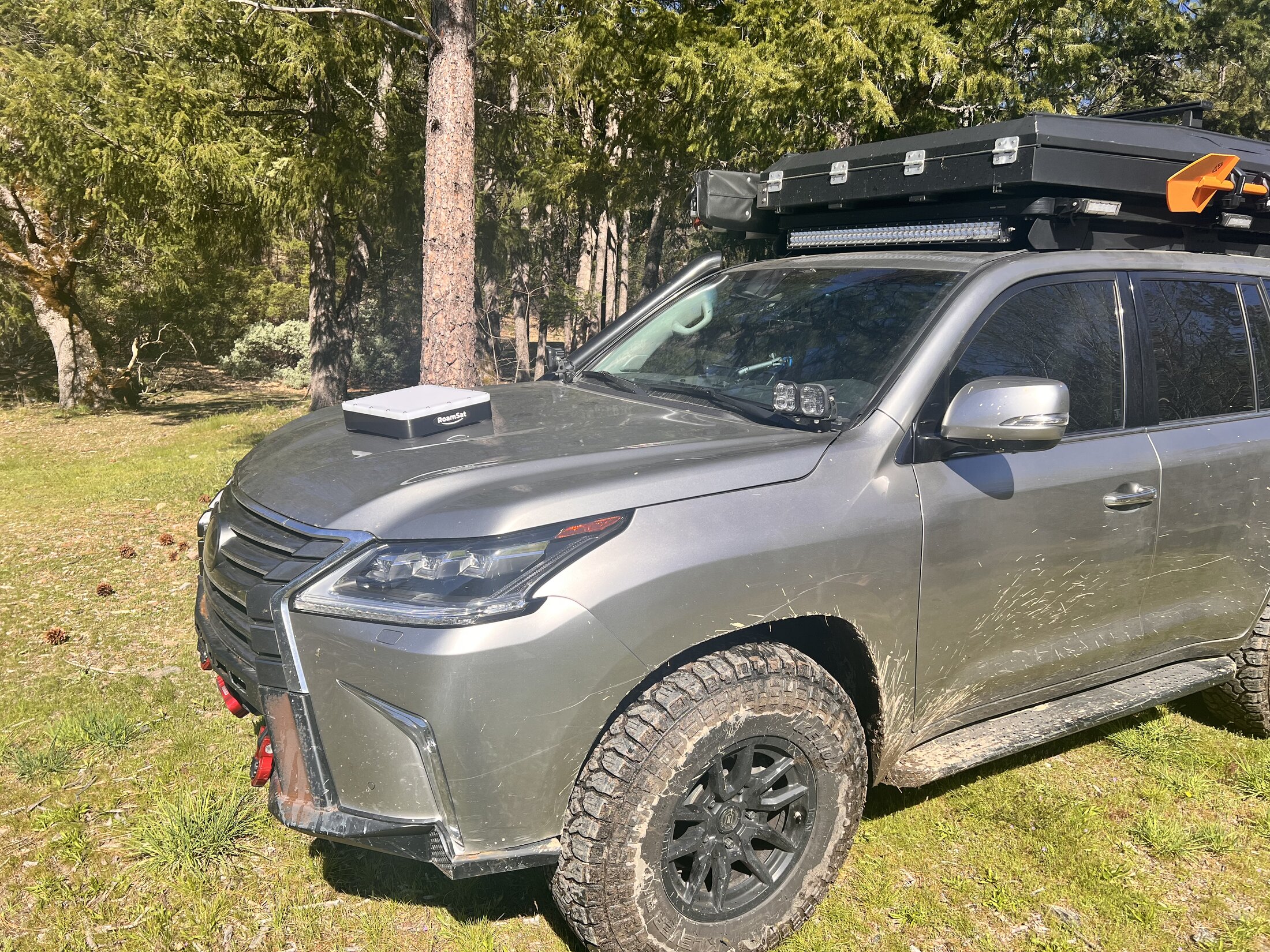

I use a Roamsat case for my mini and absolutely love it. Built in power and it’s weatherproof. The case comes with options for either suction, magnet, or rubber nubs. The built in battery powers the Starlink for about 7 hours on a charge (plenty for my use cases) and can also be run through a charge cable that bypasses the battery. Had it on my truck hood at highway speeds exceeding 100mph and it was absolutely rock solid. Downside is the cost, but it’s an extremely well built and engineered product.

Yes it is. If you zoom up on the first photo I posted, it has the charger plugged in and running out my window. You have options to either run a line fhat charged the battery or bypasses the battery to directly power the unit.

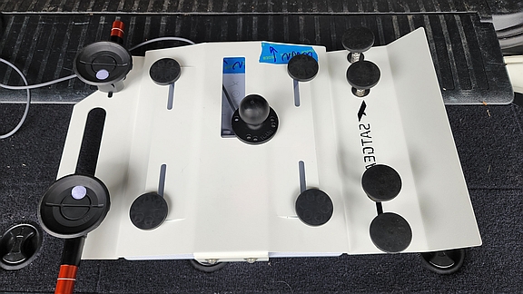

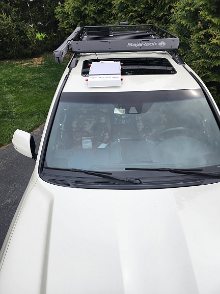

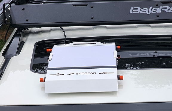

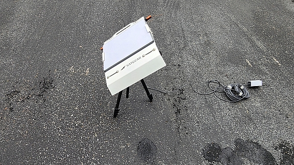

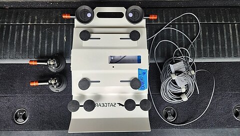

I wanted to show what I’ve done with mounting Starlink Mini in preparation for our upcoming trip. I’ve never owned one of these things before so I couldn’t make up my mind how I might use it, so I opted for the commercial mount that appeared to give me the most options and that was a Satgear SM3 - 5-in-1. Whatever the mount, it had to be secure from movement and theft but at the same time easy to remove. The handle looked like a convenient place to place a cable or chain. Securing it from theft also means easily removing it and placing it in the truck, if desired. I also wanted a mount that provided a wind faring or deflector for wind and debris. I also wanted to get a mount in white to match, more or less, the truck’s color. I could have ordered it unfinished and powder coated it to match the Blizzard Pearl but, alas, not this time.
It can be ordered with or without suction cups and magnets for mounting. I ordered it with both. Since obstructions can be an issue with Starlink, I wanted to be able to mount it to the roof on or near the sunroof, on the roof rack and with a tripod or stand if all else fails again, due to location or obstructions. I’m not interested in a permanent roof rack mount at this time, but the mount’s design is so flexible I can change my mind.
Overall, I’m really happy with the mount; it’s sturdy and well machined.
SATGEAR SM3 - 5-in-1 Starlink Mini Roof Rack Mount - https://satgear.com/products/satgear-sm3-starlink-mini-roof-rack-mount
With the magnets and suction cups shown below this thing DOES NOT MOVE: tested at 80 MPH.

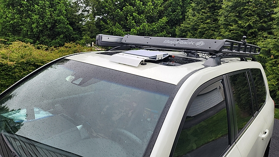

Roof mount:
I was able to mount it 2 ways:​
Suction cups per the original purchase. Two cups fit nicely in the front of the sunroof and 2 on the glass. The suction cups are really strong and held for 2 days without losing suction. I probably could have stopped here. But nooooo…I don’t completely trust suction cups.​
Four 35lb magnets with 1/4-20 threaded base purchased separately and screwed to the mount in lieu of 2 of the suction cups. This required 1 3/4 inch 1/4-20 bolts (from Home Depot) to get the proper clearance with the suction cups on the sunroof.​
I’m not currently using the magnets that came with it although they would work fine on a completely flat roof, hood or trunk without the suction cups or extra magnets I bought. For now, they’re doing nothing.​

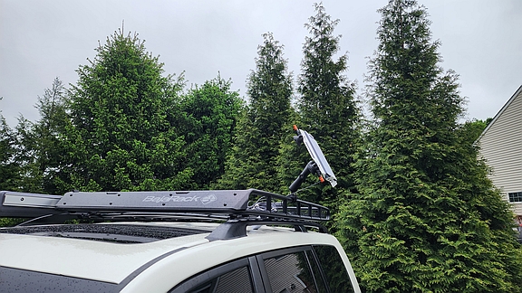

Roof rack mount:
I got RAM C ball mounts (that attach to the roof rack and to the mount’s 1/4-20 thread):​
  • RAM Double U-Bolt Ball Base for 1" - 1.25" Rails - C Size Part#: RAM-235U
  • RAM Double Socket Arm - C Size Long Part#: RAM-201U-D
  • RAM Ball Adapter with Round Plate and 1/4"-20 Threaded Stud - C Size Part#: RAM-202AU
Tripod mount:
I usually take a lightweight camera tripod wherever we go so as most tripods come with a 1/4-20 bolt it was easy to attach it directly to the mount's threaded attachment point (same one used with the RAM C ball mount above) without mods:​
I’ll power it using DC with the cigarette lighter cable that came with the mount or the 120 AC plug that came with the Starlink antenna. Here it is with the 120V adapter plugged into my Goal Zero Yeti 1500X and showing the approximate 40W power draw:

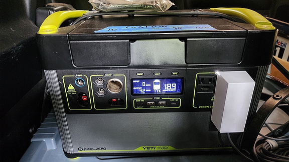

On my recent trip to Wyoming, my Mini power cord gave up the ghost.
Happily because I had heard enough about these wires failing, I had a spare.
So consider this a public service announcement; carry a spare power wire.

Which one failed, the 12v usb or regular 110v?
I also carry a few of these in different lengths so I’m glad/bummed to hear that my supply now serves a dual role.
It was the USB-C to Barrel-jack wire.
I was plugging it into the USB-C power port on my Ecoflow power station.
It worked fine for 6 days of my camping but then stopped working on the 7th day. (As god ordained!)
I was taking the mini out and putting it away about twice a day so the wire was getting a bit of handling.
I would leave the barrel jack inserted into the Mini and would only inplug the USB-C end as I set up and packed up.
So perhaps some of you guys with more permanent set-ups might not need to worry if your wires are handled less. But a wire is cheap and small - I would still carry a backup.
Roof mount:
Roof rack mount:

How did you route the power cable inside?
Nothing special at all - I ran the AC wire at the top left of the driver's side passenger door. The AC wire is thin enough (about the thickness of a USB cable) that it sealed well and didn't seem to bother the foam weather stripping. I plugged the AC receptacle into the Goal Zero Yeti 1500X's inverter. I used this method when driving and most of the time when parked. I was careful to keep the wire taught when driving so it wouldn't "flap" around.
I also have a DC cable that is much thicker, about the thickness of a pencil. For that I used the pipe-insulator-window trick of slicing a strip of pipe insulation for 3/4 in pipe, passing the wire through the slice and closing the window on the insulation-wire combo. I only used the DC cable when stationary at camp when I wanted the most efficient power draw. I found that running the StarLink and my Dometic 75L fridge/freezer can draw that Yeti battery down overnight.
Both methods have worked well, even in severe weather.
I suppose I'd entertain running the power through the roof if I was to permanently mount the antenna. However, doing so would likely require a fixed mount and your signal would suffer depending on your orientation.

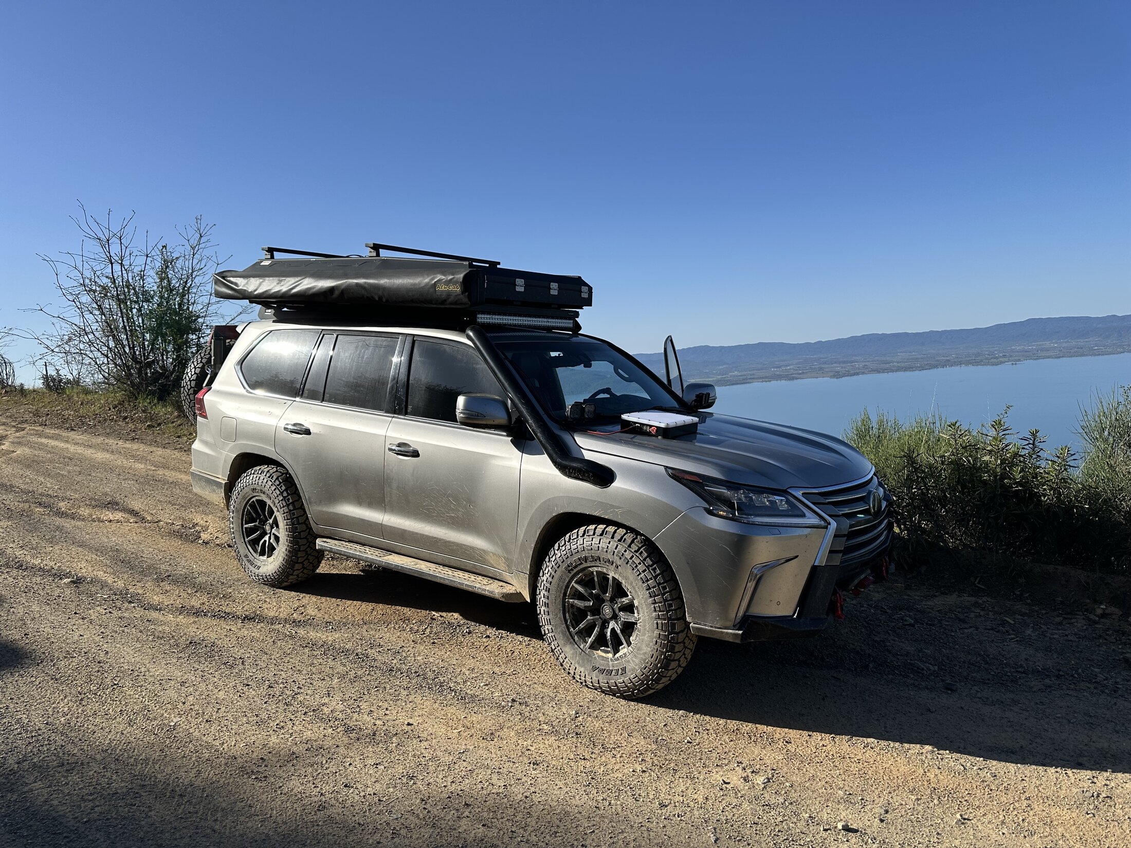

Just ordered a mini. Now I’m trying to find a roof rack mounting solution for my Dissent RR. Looking at SatGear mounts. There just seem to be too many options out there. I think that generally, I’ll just be leaving it on the truck most f the time but being able to easily take it off to secure or move to another vehicle. @FrazzledHunter, did you consider the MM3? Still happy with the SM3? The MM3 looks more robust (and is more expensive) but I’m not sure I need that though I like the 5mm polycarbonate cover. I don’t think the SM3 includes this.
Veritas Vans has a few options for mounting the mini
First, I am betting you'll love the MINI. Congrats!:bounce:
I did consider that mount as other mounts from other vendors. But when i started I had no clue how STARLINK would play out in practice so I simply went with the mount that looked the most flexible.
Now that I have a good bit of experience with STARLINK and the mount I am very happy with the SM3 BUT with some caveats. Here's some stream of consciousness thoughts about the SM3 and our usage:
  • Satellites used to be my business so the day may come when pointing isn't critical.
    • I don't think a permanent fixed mount would work well, unless your expectations for comm speed are lower than mine.
    • If you go with a fixed permanent mount on a roof rack your reception will suffer as the MINI needs to be pointed.
    • It was quite finicky when I first started last spring but I noticed it got less "fiddly" this past fall. Either I just got more adept or the satellite constellation matured.
  • The way I'm using their mount above the sunroof angled forward isn't conducive to a suction cup on the sunroof glass as it's angled when used in this particular way.
    • It's not too bad, all I have to do is pump the suction cups every 2nd gas stop and all is well. The magnets I added are doing the heavy work.
    • What's needed IMHO is a suction cup with a ball mount instead of a threaded straight mount which would allow it to tilt while remaining rigid.
  • I used my own magnets and found that the suction cups sold by SATGEAR don't hold super well when I use the mount on the LC in front of the sunroof.
    • I would forget buying SATGEAR's magnets. The ones you can get online are bigger and stronger.
  • I also bought a RAM claw base so that I can clamp to a park picnic table or tree limb.
  • If you use RAM mounts use "C" size or larger and aluminum socket arms. You'll want to really tighten down the mounts if things get windy.
  • With magnets and suction cups it's very easy to pull the mount off the roof and put it in the back when we leave the truck for extended periods like when hiking in a remote area or parking at a tourist attraction (Walmart LOL) as we're concerned about theft.
  • We use the ball mount on the roof rack and the claw mount a lot.
  • We hardly ever mount the STARLINK on the photo-tripod but have it with us anyway just for general photo-taking.
  • I thought about mounts that had protective covers but the MINI is really tough.
    • Since I've worked with the MINI I wouldn't get a protective cover however there's the ever present worry of tree branches falling in storms etc...
That is all I can think of right now.
