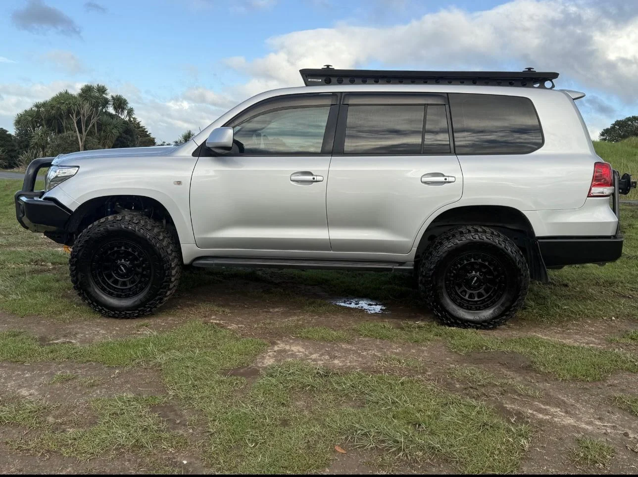

Hi all,
New to the forum having just picked up this 2009 2UZ LC200 with 140,000kms (87,000ish miles). What would be the maintenance items you would do on a new purchase? The vehicle has been well maintained, with service records and receipts for the last 5 years (2 owners in that time) and pre-purchase inspection didn't uncover any major issues. Waterpump and cambelt were done at 100,000kms.
It has just had an oil change prior to me picking it up - but I'm still thinking of going right through it and changing all the fluids/filters/sparkplugs etc. Overkill?
