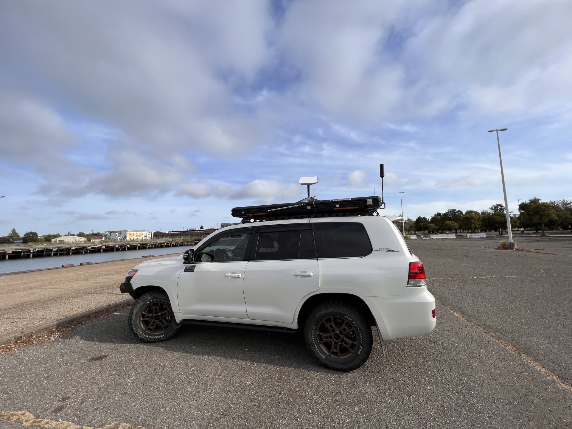

Starlink RV roaming version, initial test

Also better off using the roof top angle mount.
I posted earlier about this...
I have not solved mounting yet, this was just a test near home. I’m thinking of mounting to a pole attached to the tent slot rail.
That stand you have there is good for when you park under a tree, then you can put the dish away from the vehicle where it has good line of sight to the sky.

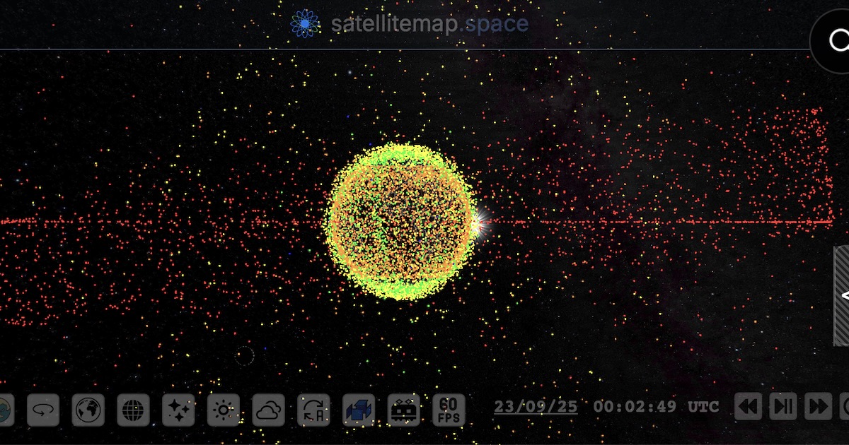

This is a cool link.

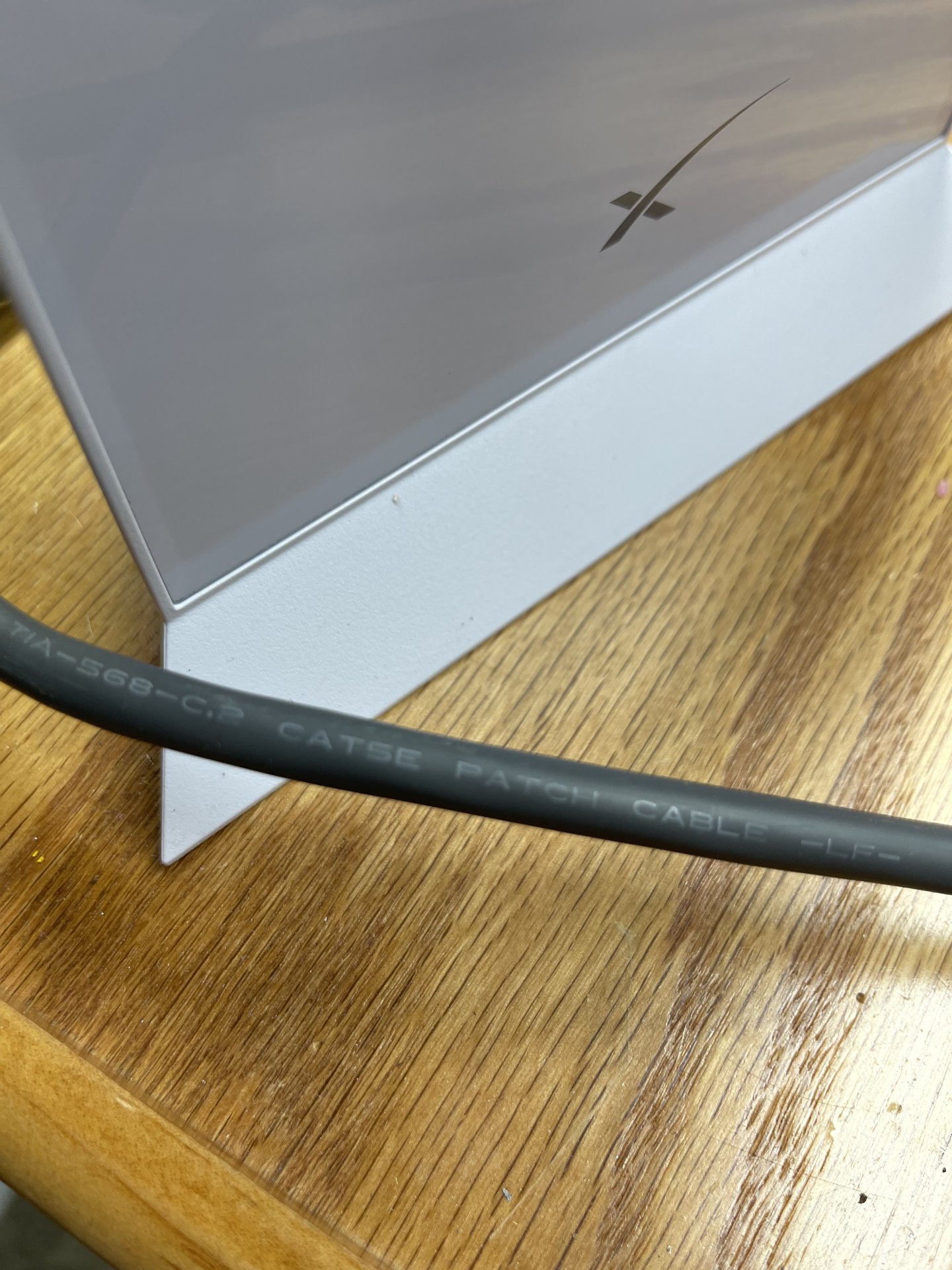

Do you know the name of the cable end that StarLink is using? I wonder if you can just buy shorter versions of that cable from some where.
It’s cat5e with a proprietary connector. From everything that I’ve read, you can put a regular rj45 and rj45 coupler on it and be ok.
New model is CAT6 shielded, but I think they are using a different pin-out for POE. But yes, you can use standard rated rj45 cat6 connectors to customize the cables as long as all the connections are straight through.
Weird. Both my Starlink dish that arrived this past Tuesday and the 150 foot cable that came today are both cat5e.
Both the residential and RV cables, and both 75 and 150 are CAT5E. I'm not sure what the commercial version is using?

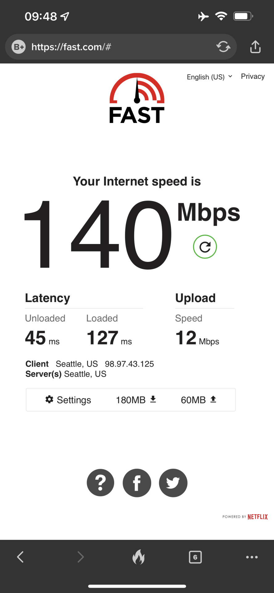

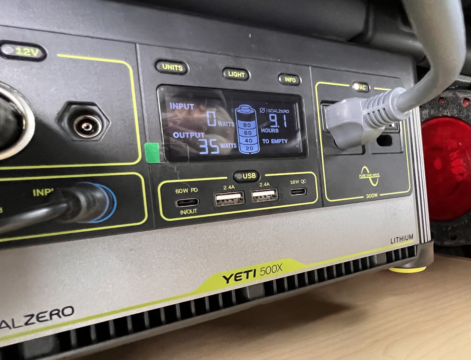

Here’s my speed test from this morning at Lake Pillsbury, Mendocino NF. The Starlink is pulling 45 watts from the Yeti, and I’m getting about the same from my 50w panel.
I ordered the RV version and it's due to arrive next week while I'm away on a work trip. Sounds like it's AC powered. Guess it could run off the small OEM inverter but would require ACC on. Not a problem, I've got a Yeti 1500x which will do the job and then some.
