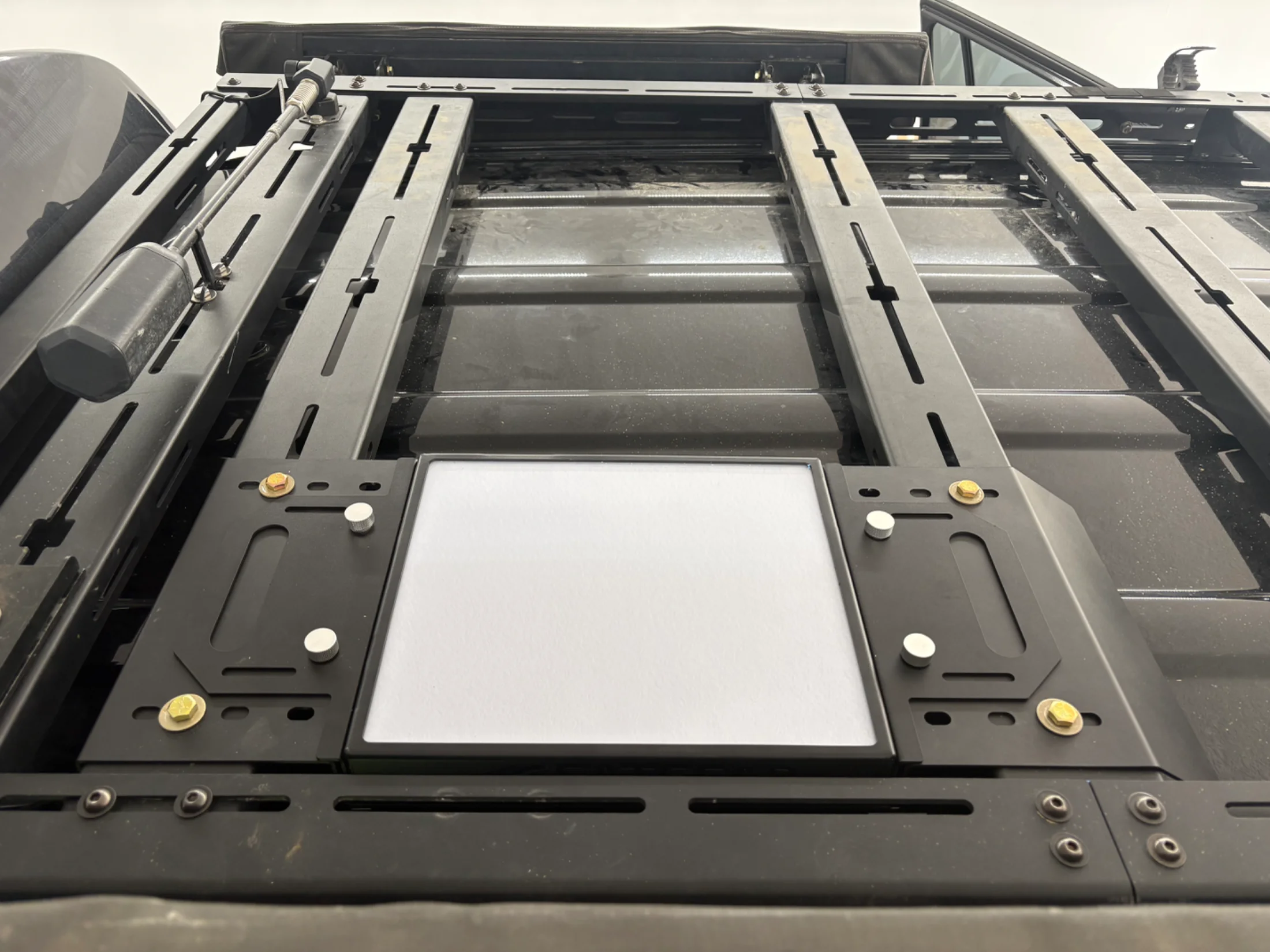

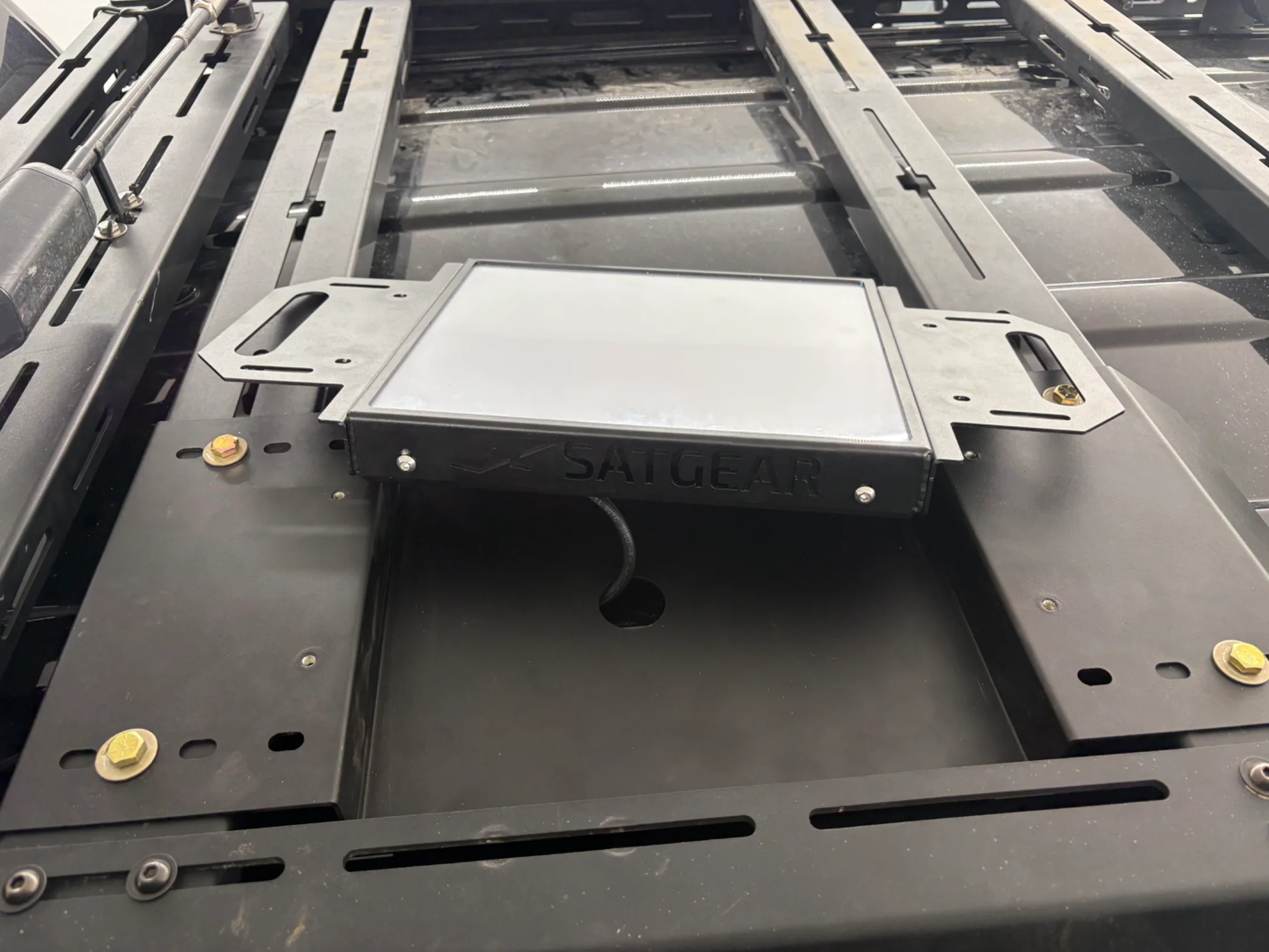

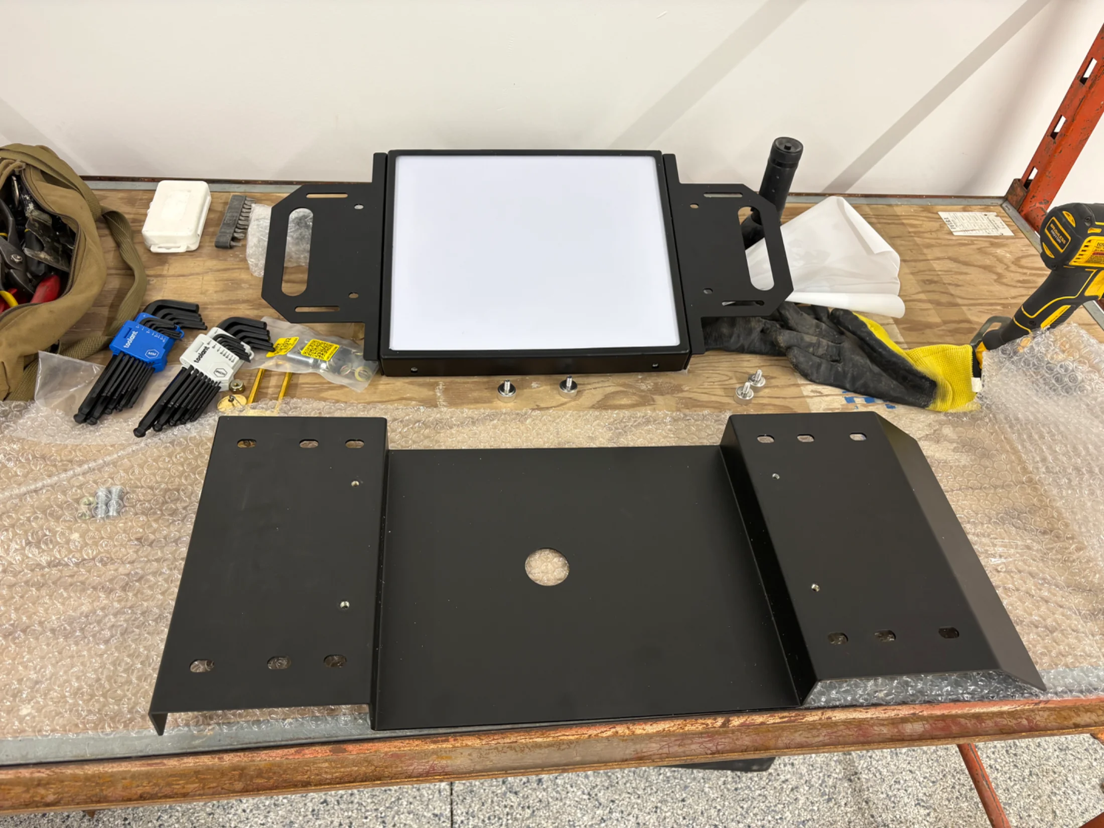

Got my SATGEAR rack mount (MM3) yesterday and just installed it. I’m having to move some stuff around in my rack and I had to move a load bar on my Dissent rack. The MM3 isn’t really made for my rack and I had to drill some holes to make it work. The mount is kind of silly expensive but I do like how it mounts the Starlink flush with the low bars and it’s got a removable case that holds the actual Starlink that’s pretty hellastout. Just four screws to take out to pull the starlink from the mount. I think for me that’ll be pretty useful.
You could just get the case with the handles and mount that directly on the rack. If you used rivet nuts, it would have the same functionality.
Nexus to figure out the cable routing. I got a free sec gear cable and it’s pretty Hellastout too. It’s much thicker in diameter than the Starlink cable so I’m a little concerned about running it through the door gaskets not sure if he rear door or one of the passenger doors is the best path to get the cable inside.
I run the StarLink High output one re-configured for 12 volts. It's fast. Usually 300. Usually just on stand-by but if I need it on it's there and fast.
View attachment 4105267View attachment 4105268View attachment 4105269
I am probably going to do one of these on my 80 when I wire in the Starlink permanently Water proof cable pass through I will probably do it near the rear sliding windows AKA D pillar.
