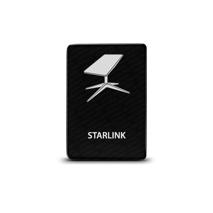

Also had to pick up one of these to switch it on and off with style.
