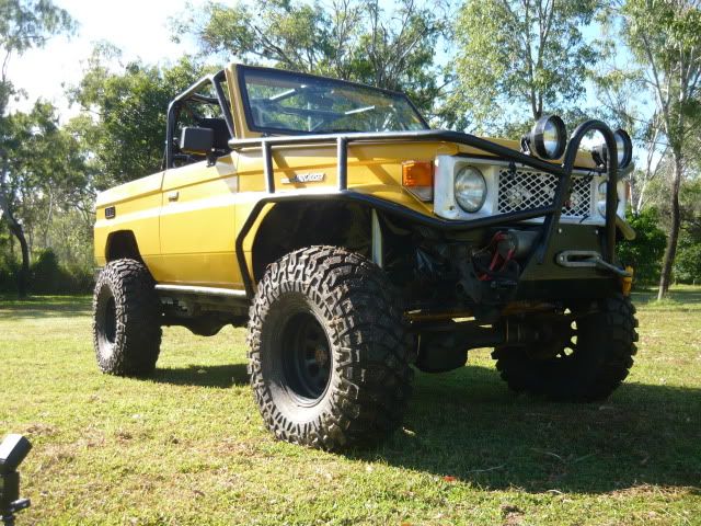

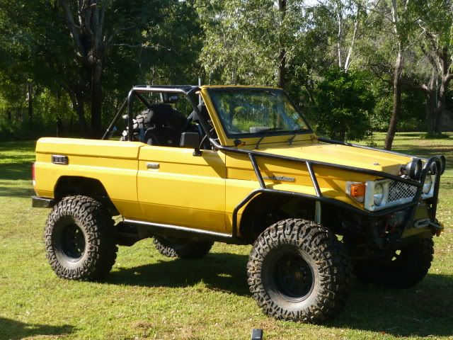

Sprung over BJ74's.
Great info. Peter thank you. Im just getting back into cruisers now. Can you tell me what you did to get that crawl ratio?
Marlin 4.7:1 Toybox. Every BJ74 should have one. It extends the drive train so that the front and rear drive-shafts are nearly the same length... perfect.
