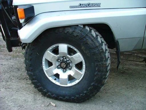

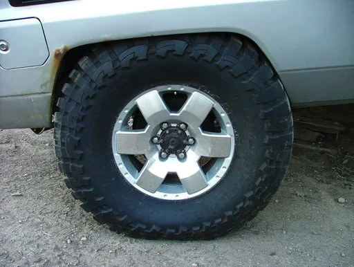

It's an honour that my rig is your prototype. 37's are too small for SOA, though. You can fit 35's on a 70 with 2" lift. And Easily 37's with some lift and some fender trimming. I run 40" Irok's on my SOA with some fender trimming, and with the fender removed on the Left Front, it's easy to imagine 42" or so tires without much problem.
