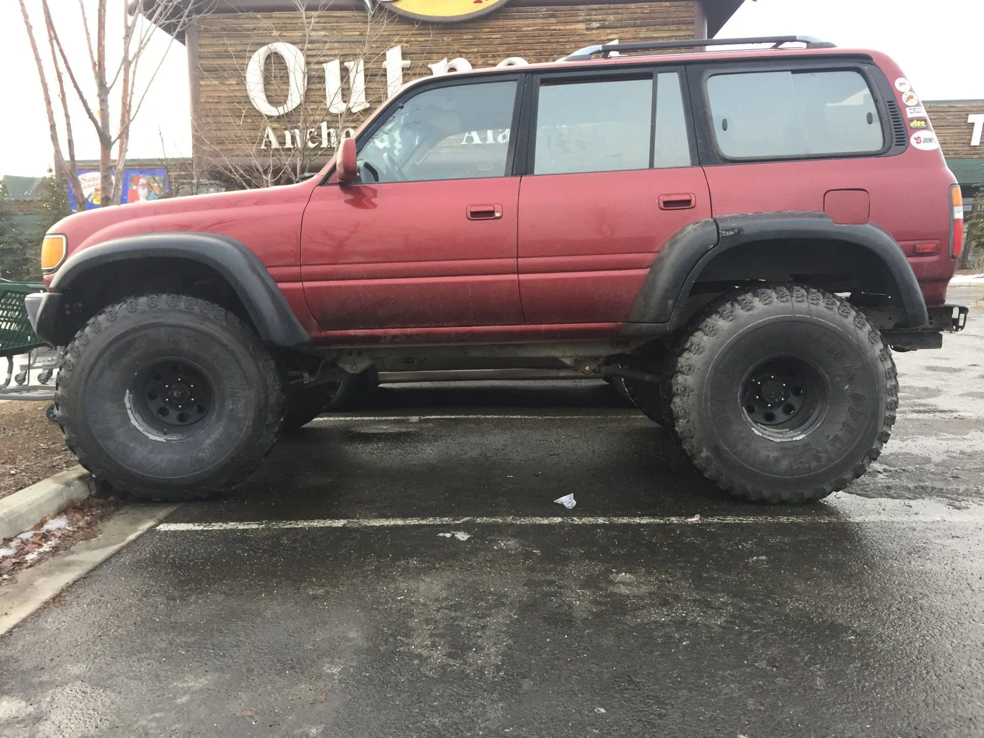

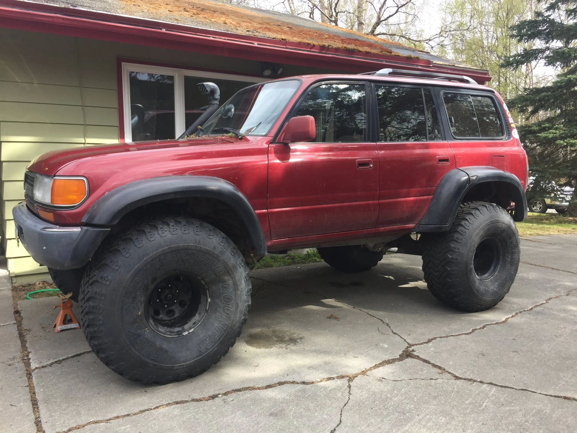

Debated quite a while whether to post another, “what springs should I get....” thread. But maybe I do have a unique application.
First some background. On my 3rd set of Slee springs. They are fantastic for what they are engineered to do. Here in Alaska where freight doubles the cost of anything, and not much in the way of supporting vendors. Slee’s turn-key kits are perfect and deliver amazing handling. My first builds were right down the middle. The obligatory ARB front bumper, double swing outs in the rear, winch loaded with steel cable, spare hanging on the back, sliders....
After considerable research decided to do a light “arctic truck” style build this time. This approach tries to go as light as possible, a floater.
The Aluminum LS & 6 speed swap, shaved several hundred pounds from stock. (The future holds a winch loaded with syn rope, & modest tube bumper protection). Removing the 2nd & 3rd row seats will maybe drop another 100 lbs? On the other hand I often hit the trail with almost 50 gallons of fuel, and when hunting need to bring back several hundred additional pounds.
Currently have a 2” body lift & 4” Slee springs, and it sits about where I want it. However it drives like I’m sitting on top of springs engineered for significantly more weight. (34C says she needs a sports bra to drive over a garden hose!). However, going to lighter springs may sit lower, and require more lift.
Perusing threads on the subject, it looks like Dobson can help me with selecting springs engineered for a more custom application.
Any other recommendations for engineering help ?

Maybe not only the coils but also shocks you are using ...?
Keep in mind that if you don't do air bags, would be better to set your suspension while your 80 it's fully loaded ..
Maybe not only the coils but also shocks you are using ...?.
Shocks & everything else related to the suspension still remains the turn-key Slee kit. Even though I’m on the 4” springs, I have always used Slee’s control arms usually used with the 6” kit
This is my dream truck. I’m so curious how they built this up and whether it’s been done right.
I’m in love with the look of it.
Look for springs with rating of below 200lb per inch, I would say 160lb even. Problem is most spring are 220 and higher especially beyond 2 inch lift. I would recommend TJM progressive springs with 30mm spacer should net you just over 4 inches. Try fox 2.0 shocks as they are valves for stock weight.
In conorarrison SLEE springs feel like they are around 300lb range.
Steve, we may have touched on this before... I love my Slee 4 and 6 inch springs, but the OME mediums and even heavies rider much softer with the same shocks. Of course they are a little shorter too. But a set of 20 or 30mm coil spacers would get you back to where you are now. As for carrying weight... with coils, you are gonna have a tough time getting everything. But for this rig and the inherent limits it has in terms of articulation anyway, a set of airlift air bags inside the rear coils will address the occasional heavy loads nicely.
