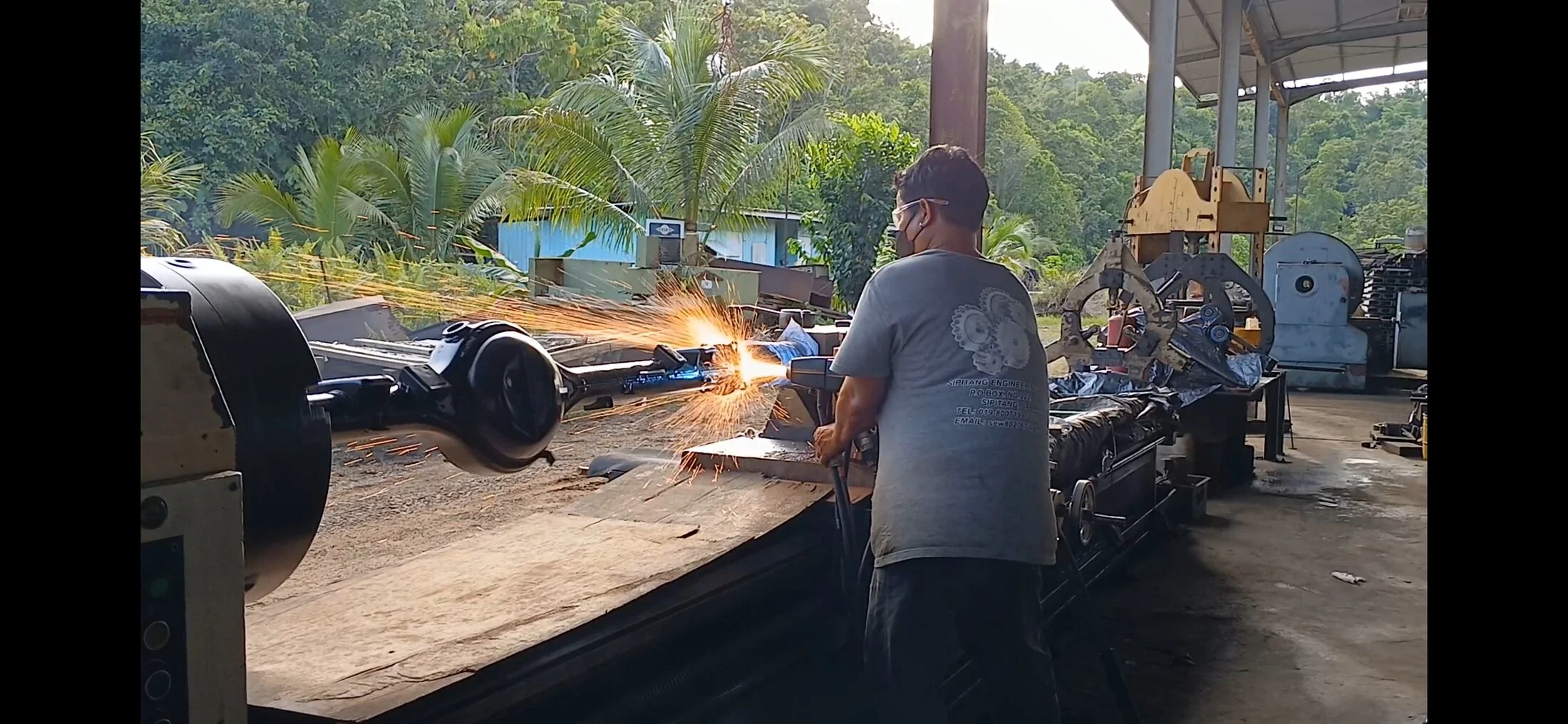

I went to the shop on Saturday and watched them start the work - it's a very time consuming process. Once the work is finished I'll update my build thread with pictures and maybe videos that I took. The method used an arc spray gun, where two 1/16" 13 % Chromium steel wires are melted simultaneously (with the arc between the two wires) and blasted out with compressed air.
In essence, the process is:
- machine away a 'channel' in the old spindle surface. There should not be an edge of spray metal material, it should be bound by parent material on each side.
- a masking compound is applied to areas where metal spray is not desired (e.g. the threads on the end of the spindle).
- a bond material is sprayed on the machined area.
- the wire spools are then changed to the filler metal and this is built up in roughly 10 second passes on the spindles. The operator never got the spindle aboive 90º C.
- Once the material has been built up to 2 mm oversize, an initial cut is made to smooth off the filler. Water is used to dissolve the masking compound and release the overspray.
That's as much as I saw. The machinist builds each of the three areas separately (two bearing surfaces and the grease seal surface) and will machine them all to spec in one session, then reverse the axle housing in the lathe and do the other side.
I've been quoted MYR 800 (just under USD190) per side, though that may have been for just the two bearing surfaces.. In Malaysia, that's quite expensive but it'll probably be a day and a half of work so would cost massively more in Europe or, I assume, the USA. But it's really the only solution (and I hope it's a good one) to worn spindles by my assessment, other than replacement (and they are long since out of production).

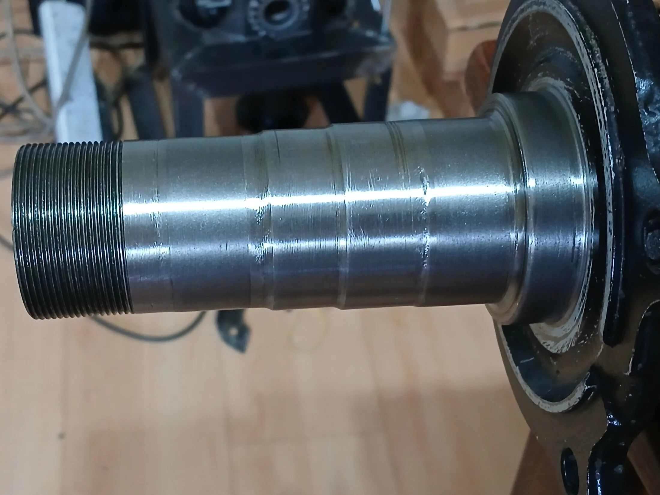

Yesterday I picked up the axle from the machine shop and I've spent the morning checking out the work. I've test fitted the hubs with new bearings, and checked the lock washer and locking nut alighment. Everything is correct. I only had to clean up one keyway with a grinding disc in the Dremel and run a thread file over the threads on one side, and I think it's perfect.
Here you can see the RH spindle. The areas of different colour are where the repairs have been done; so on the two bearing surfaces and the inner diameter where the grease seal rides. The bearings have that same tight but not interfering fit that they do on new front spindles and I'm very happy with the work. The new metal texture is not as smooth as the original, but the machine shop owner told me the new filler will be harder than substrate. And given that it could be machined to size without ripping chunks out, it seems to be good. Only time will tell if the work is strong enough, but I reckon it will be fine. I'll be keeping a close eye on rear wheel bearing pre-load. An added bonus to having done this is that I know the two spindles are dead straight along the axis of the housing.
Here's a picture of the arc spray:
