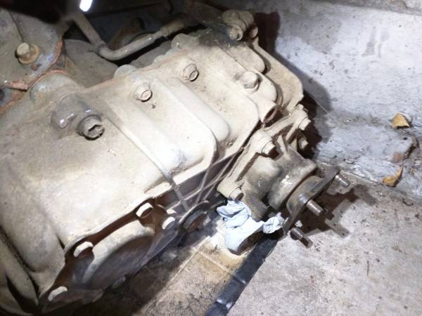

If you haven't found a T-case yet there is one on the Seattle craigslist. Just posted trans and t-case fro 450.00. I just saw it.
This is out of a FJ60 by the location of the shift cane on the transmission. Should have a date code on the transfer case. 10/82+ should have the provision for the fifth gear oiler. Because the date code is on the back of the transfer case and oiler is on the front can't be 100% sure. I say that because I have a H42/split case from a 3/82. Case has 4/83 date code but believe it still has the front from a early 82 case. Another thing if use this transfer case behind a H42L the transfer case shift linkage will not work. Because it's longer the boss on transmission moved to where the reverse gear is the 4WD lever from a shorter H42 will not work.
I'm thinking you could pull the pto cover plate and look at the front of the case and see if it has the oiler indent molded without having to remove the transfer from the trans??????
but the OP would still need the longer bolts and the shift linkage
The recess for the oiler is pretty much hidden behind the gears.
Here is a picture of the fifth gear oiler. Not sure what on the inside of the case but looks like the input gear would probably hide it.
I thought you might be able to see the molded piece bumped out without total disassembling the transfer, looking behind the gear either by eye or a mirror.
